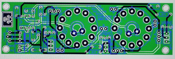

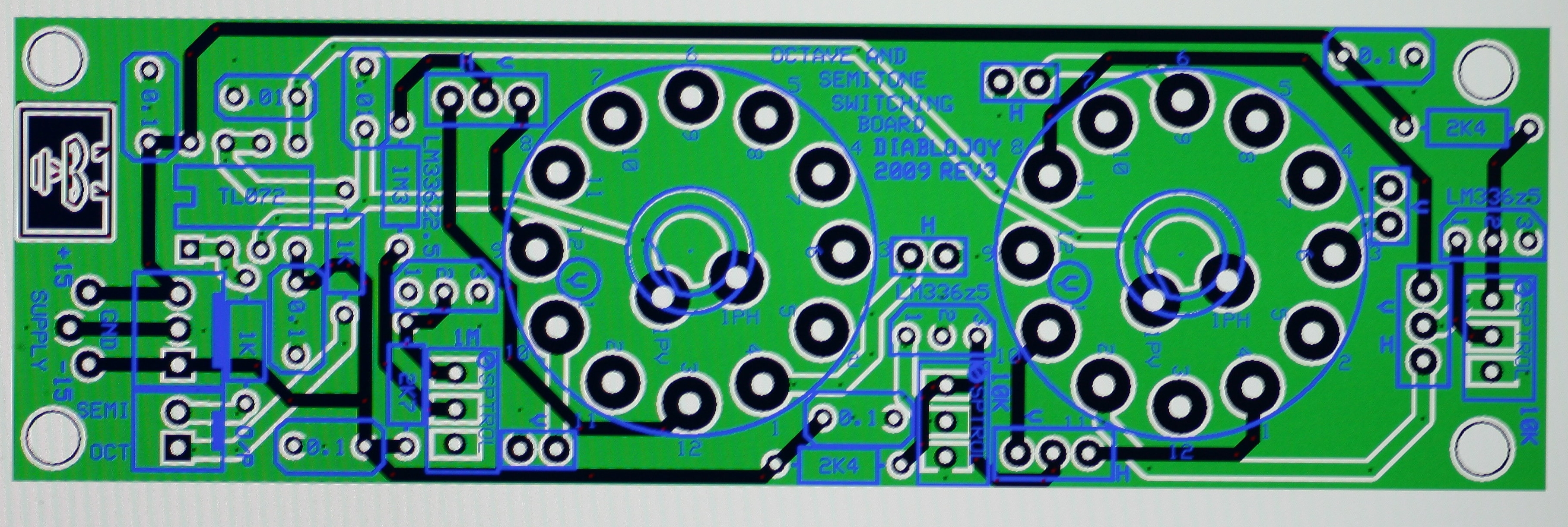

Subject description: edit :board design revisited
following on from rykhard's good work
i have been designing a board for myself
and thought i might share this for any it may suit
as i will be ordering boards for myself in any case
there are some changes in the implementation from rykhard's schematic and one
major limitation which is if the board is to be mounted on
the rotary switches as it is designed to do both the type of switch and the hole centres are obviously predetermined
note : hole centres are fixed at 35 mm
switches are the same ones jaycar in australia sells
I cannot guarantee if any others would fit
the board can be rotated for vertical or horizontal placement
with knob pointer positions remaining correct also works best with
SMT 1206 0.1% resistors however normal metal film resistors can be kludged on, that was how i tested the first single sided prototype
next board will be double sided plated through hole
board size is 34mm x 110mm to fit 1 RU space, I am space disadvantaged
width wise
board cost at a guess would be somewhere around $10.00 AUD
depending on numbers
edit: revisiting this design to give it a wider appeal 11/07/12
cheers
denis.
better pic fixed error
 Filesize:  3.1 MB
 Viewed:  468 Time(s)

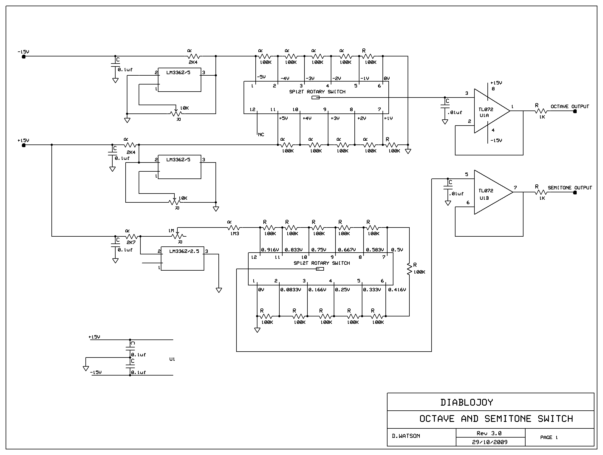

will post schematic soon.
I looked at elby's design quite some time ago and while ok it didn't provide me with all that i wanted
firstly it relies on a very good stable power supply as
it has no voltage ref's
also it only provides for positive output/ octave up and i wanted to be able to have octave down as well
and finally it is only octaves not semitones as well. [single rotary switch]
in the end i decided to do my own as i could not find anything completely suitable. rykhards schematic's provided a good starting point
the semitone section is pretty much exactly the same just different
resistance values i used 100k for all the divider networks
the octave switching is a done differently however as i used the
LM336z/5 trim ability to set the reference to exactly +5 volts for one side
and -5 volts for the other.

    they are all used bar one it was the easiest way
    smt resistors directly between the switch post pads [ not shown ]
    the switch pads a far larger then actually necessary to allow for this
    better to guarantee resistance matching of the divider networks
    and a lot less awkward track work. soldering in the resistors is done at the same time as the switches, it isn't that difficult to do as long as long as you stick to a predetermined process
    funnily enough i have found blue tac invaluable at holding smt in place
    whilst soldering and have never had a problem since i started using it.

    schematic
     Filename:  OCTAVE AND SEMITONE SWITCH.bmp
     Filesize:  385.06 KB
     Downloaded:  820 Time(s)

    Whoa! That is absutively PHENOMENAL to see! salut Many salutes of respect and appreciation for taking my design a step further! I'm going to keep watching this one as just yesterday, I thought of finishing my Quadatrix Octave sequencers panel. (I have only 1 of 4 completed, though all 4 semitone sequencers have been running for almost a year now.)
    Following your example would make further building for me 1 hell of a lot easier! Very Happy
    My only thought further, that I've not partaken of myself yet, is lower current offset opamps for the outputs.
    _IF_ I remember correctly, the LF411C / LF412C, were one that I'd found in searching. Others here who have a more current knowledge of opamps will more'n likely be able to recommend others.
    In my current setup, I'm just using whichever TL0xx's that I had lying around and tuning is more than accurate enough, across all 5 sequencers, individually running together, or summed, running together. Smile

    yes TL072 is just what i had lots of, cheap and plentifull
    and they work just fine,A better spec'd opamp is not really required,IMO
    more of a option really for any who wish it
    better to spend money on the 100K resistors and if really finicky about it perhaps better voltage references.
    I bought a small roll of 100K 0.1% 25 ppm 1206 smt's specifically
    for this project as i plan to build more than a few.

    edited board pic see first post fixed output track from tlo72 Embarassed
    added fourth mounting hole so board can be mounted properly
    if not mounted directly to switches [ note : wires run from switch post holes and should preferably be of all the same length if doing this ]
    which will allow for different switches and hole centers
    added values to switch debounce caps
    any suggestions/requests/ for further improvement appreciated
    ie : seperate pads for through hole /smt for divider resistors
    [I might be able to fit them in ]
    value for debounce caps [.01uf was literally the first value i tried
    and sonically at least they work fine ]
    I will be ordering a few prototype boards next month for final testing

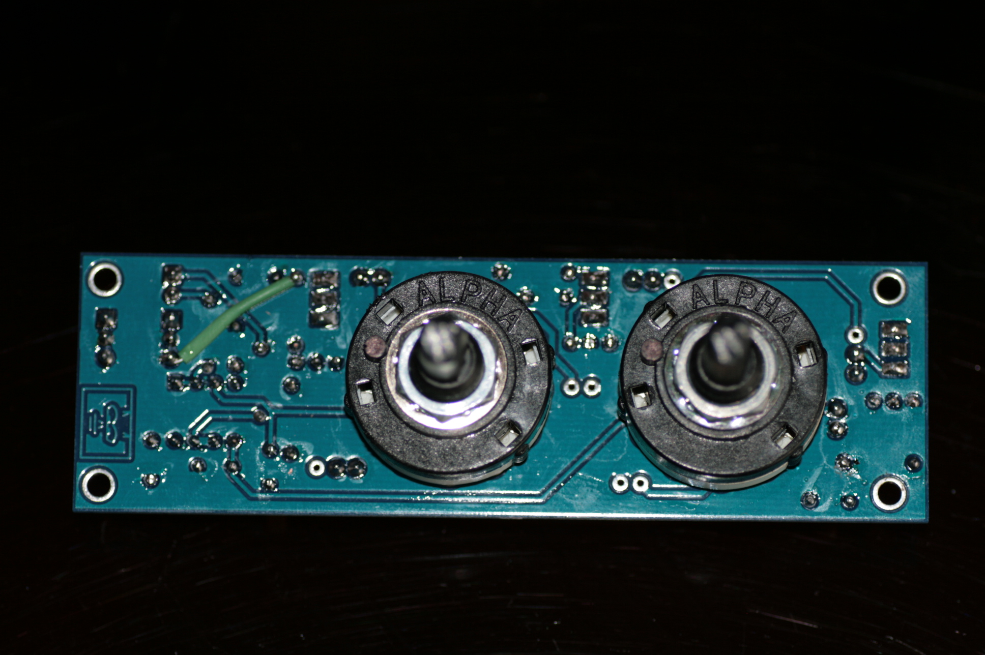

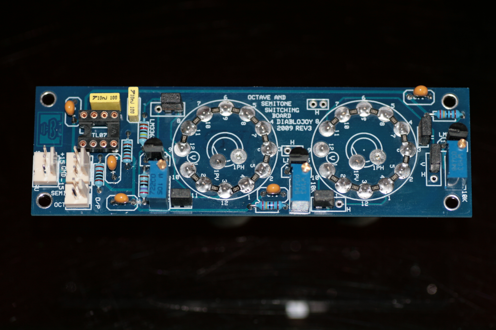

    PostPosted: Sun Jul 08, 2012 2:01 pm    Post subject: Reply with quote  Mark this post and the followings unread
    Playing grave digger and answering to Diablojoy's posting here:
    diablojoy wrote:
    the switches are an alpha from memory 1 pole 12 position
    Are these the SR2512F-0112-19R0B-E9-N-W available @Mouser?
    diablojoy wrote:
    I do still have some boards but they require a small kludge Embarassed
    need to cut one trace and run a wire
    SMT resistors are 1206 0.1% x 21
    That kludge is no problem for me. 1206 SMT is also no problem.
    The PCB looks a bit wide though. 11 cm is very much.
    diablojoy wrote:
    recomend LT1057 inplace of TL072 for the best accuracy
    Don't know were to get them. Are LT1013 OK, too? Because I have them.
    diablojoy
    Posts: 809
    Location: melbourne australia
    PostPosted: Sun Jul 08, 2012 3:33 pm    Post subject: Reply with quote  Mark this post and the followings unread
    could not find that number on mouser
    however i believe the C&K 611-A10003RNCQ looks likely
    very expensive though
    I got my switches from jaycar for around half that price
    The PCB can be used vertically as well as horizontally the switches can be rotated 90 degrees and there are SIL strap points to accomodate the different orientation though i must admit to an error there as well as the flat on the switch shaft is 180 degrees out on the boards i have
    I have since corrected this and the kludge on the latest board revision layout but as there was basically no interest I never had any more boards made .
    The prototypes i originally had made were for my own use so did not really
    intend selling any of those ones, I sent a couple to rykhaard however
    as he did the original work not sure if he has got around to building them.
    havent tried that one before
    however pretty much any low offset opamp that replaces a TL072 should offer some improvement
    Its only really noticeable around 0 volts , where a TL072 is about 3 to 4 millivolts off at 0 volts
    Strange, maybe the Mouser article number 105-SR2512F-112NS works. But I can find it with both @de.mouser.com
    4,80 € is not that expensive compared to NKK switches but the C&K have a plastic shaft which I don't like on rotary switches.
    That doesn't really make it better as space is either missing vertically or horizontally then.
    I'm thinking about making a different PCB and using 633-MRA112A rotary switches from NKK as they are pretty small. But I would use 3 octave switches on one PCB as I'd like to use them to control 3 VCOs.
    Would be cool to have a sequencer project with 8 of them on one PCB. I think they could be used in a 2 column 8 rows 1" grid format. Of course that would require a daughterboard or massive/full SMT which I doubt would generate much interest.

    and here's a couple of pics to help
    one trace cut just visible between the ceramic cap and the resistor next to the trimmer lower bottom left
    one strap run from +ve to that same resistor
    if board is to be mounted horizontal or vertical the decision must be made prior to stuffing and attention must be paid to the switch orientation and pin numbers and then to which strap points are used having said that i actually got it wrong by 180 degree's so the flat on the switches is off however i use davies 1510 clones and havent had any loosen up on me yet
