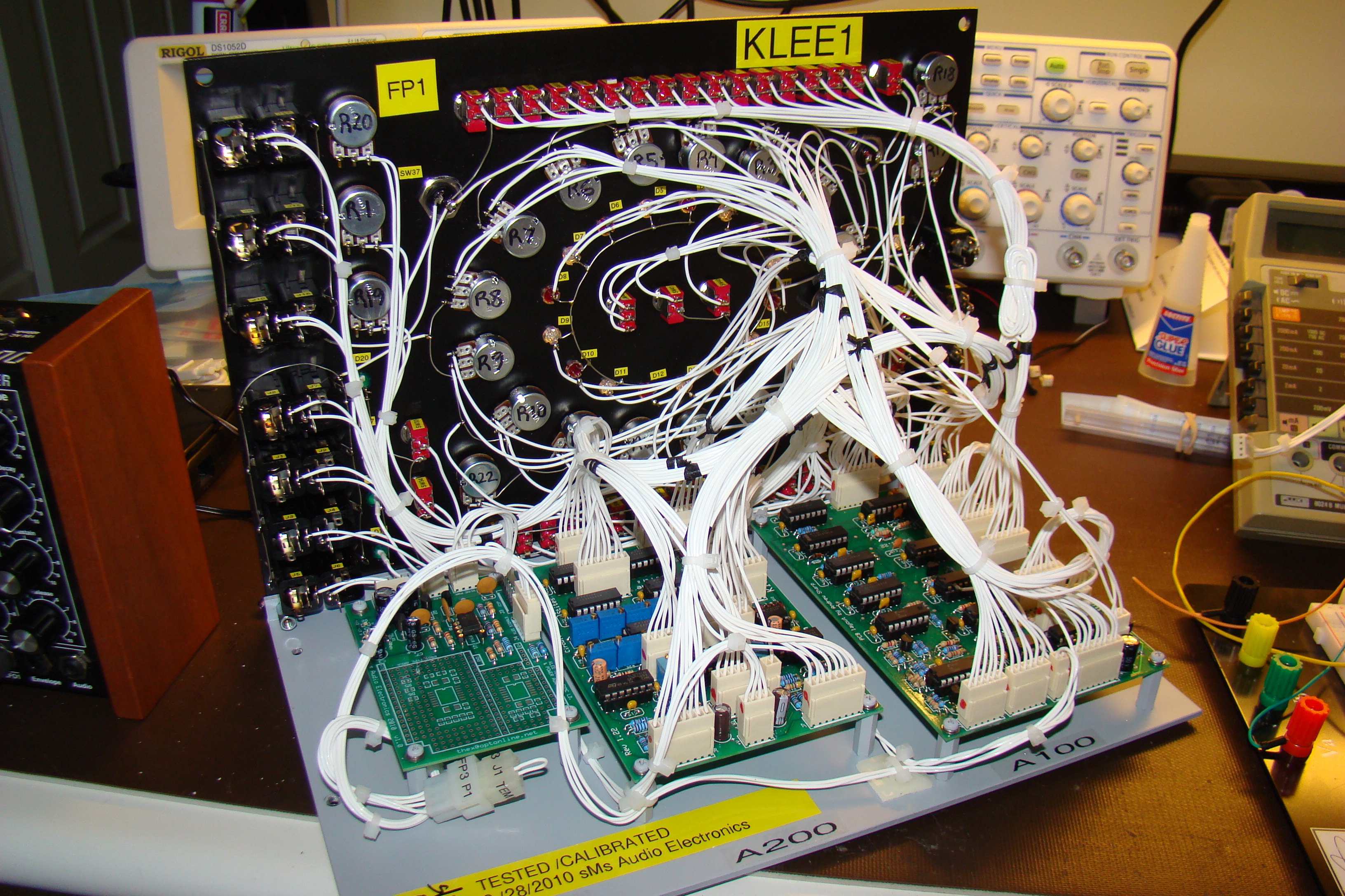

I have built 3 of these for folks. The panel I utilize of the One from Bridechamber which is a MOTM form factor. The pictures are a sample of two I built for a client in the Midwest. PM your needs and maybe we can strike a deal. I have references for my work as well.
Bill

What is the third board in your build?
Posts: 2810
PostPosted: Thu Feb 10, 2011 5:34 am    Post subject: Reply with quote  Mark this post and the followings unread
The third board is a feature to add a synchronous manual load function. Normally when you press the MANUAL LOAD pushbutton, the pattern loads immediately, asynchronously to any incoming clock. This circuit adds the option to manually load a pattern synchronous with the CLOCK input.

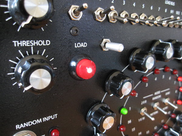

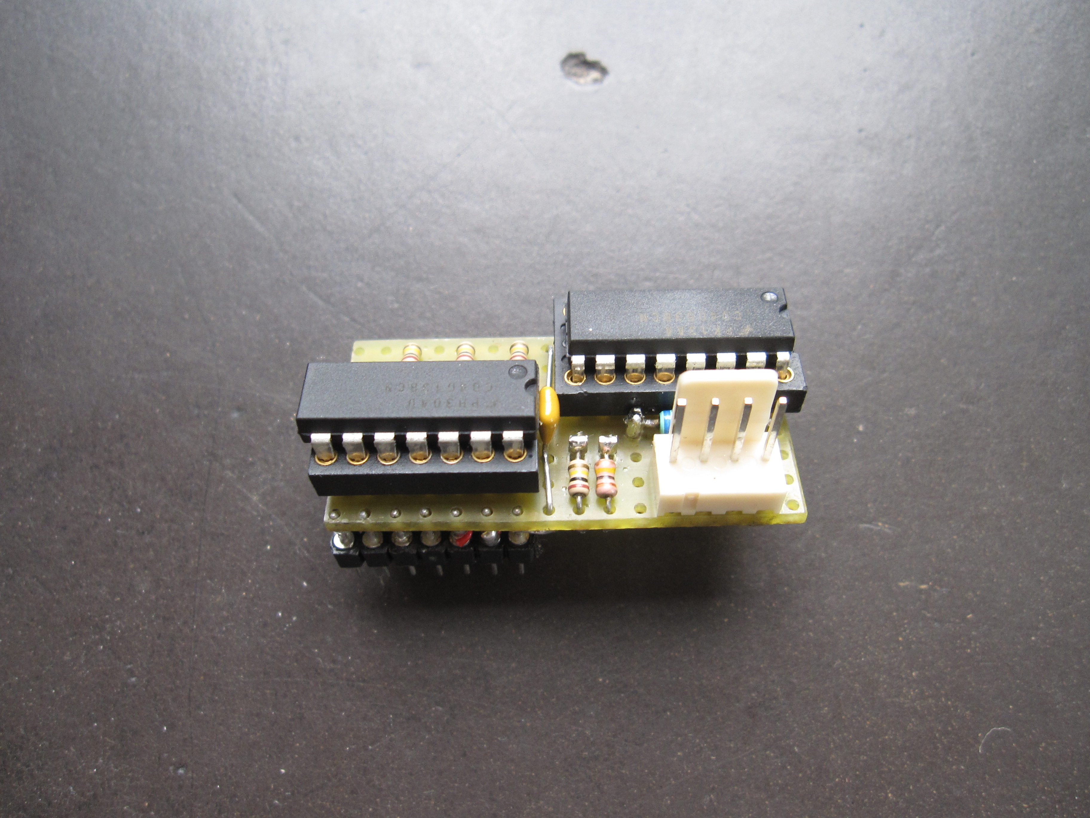

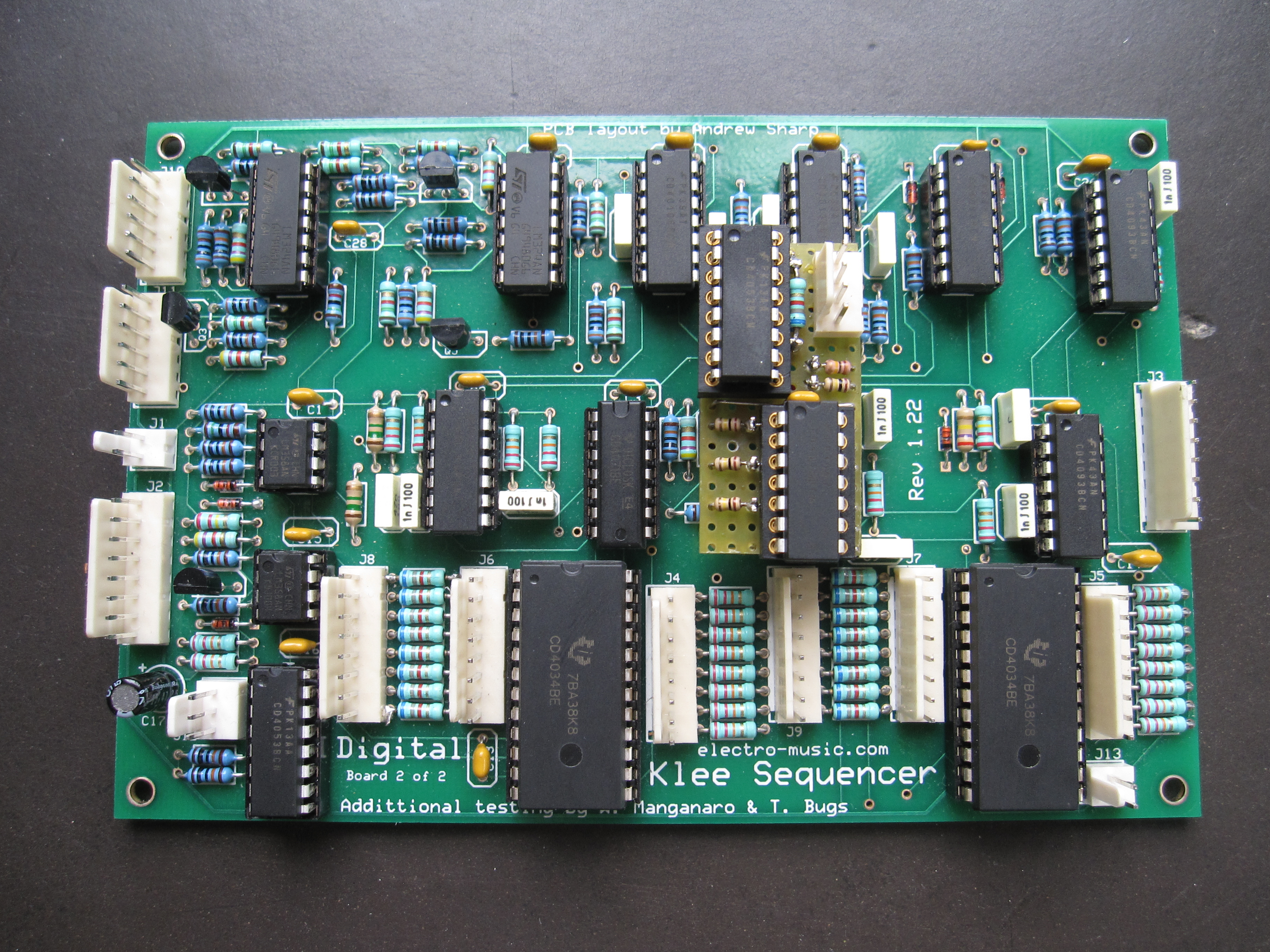

What is strange is that the topic - "Add a Synchronous Manual Load to the Klee" - has been deleted from the forum. In that thread, Bill explained how his synchronous load mod worked, and I posted another possible method of doing it using one chip of discrete logic (CD4053) - less complex (or programmable) than Bill's - but more modding intensive.
Since it's gone, I'll post it again now - including the altered schematic and photos of the added circuitry, the modded digital board, and the added toggle (and LEDs) on the front panel.
Mark

Daughterboard that plugs into U5 socket.
 Filesize:  3.57 MB
 Viewed:  449 Time(s)
Klee digital board w/daughterboard plugged-in.
 Filesize:  4.59 MB
 Viewed:  462 Time(s)
Extra toggle on front panel for Sync/Async loading with bi-color LED indicator.
 Filesize:  3.71 MB
 Viewed:  444 Time(s)
