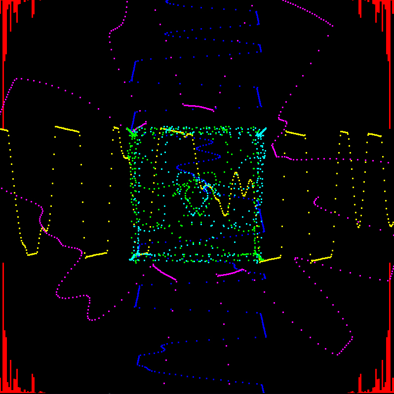

Thanks for the link! Muied Lumens just posted an excellent article on zero-input mixing in the electro-music wiki
I find that my Yamaha had a very reedy native tone similar to a clarinet (at least in my head), while my Mackie has a drier, low-amplitude raspy native tone. Each oscillates and saturates in its own way, and I tried to preserve some flavor of each even when using software in the feedback loops in the NYE 2012-2013 webcast.
A team of my students is currently designing and extending a very basic waveform visualizer that I drafted in the Processing language. I have been using my NYE recording as a test driver. Attached are 3 screen shots, and I'll attach 3 more in a follow-up post below. The yellow and blue are time domain plots of the recording, and the green and cyan are Lissajous. Either I had no stereo difference or the input software is screwing me on left-right separation, so I phase shifted the right channel by 10 samples to get the Lissajous patterns.
The magenta trace is just time domain plotted around a circle 3/4ths of the way out from the center. We are designing this for use in the planetarium. Finally, the red bars in the corners are mirror images of the frequency domain plot.
I'll talk a bit more about the planetarium in the post below. In terms of zero-input mixer, I found watching these waveforms very useful in helping get into playing the instrument. For NYE I didn't have time to look at them, but I find them mesmerizing now. These still shots don't do justice to the transitions, any more than a 1-second recording would to music. Another of my student teams is planning two 3-minute promotional videos for the planetarium-as-instrument. One will use a game-for-play-in-planetarium that we are developing, and the other will use the final version of this visualization software driven by zero-input mixer.

For the planetarium we can add additional plots, such as change in RMS amplitude over time, or change in frequency distribution over time, or make the lines thicker or thinner as a function of amplitude (smear the paint), or modulate the Lissajous cross-channel phase shift or other parameters. If I can get > 2 input channels to work (the library I am using is broken with > 2 channels at the moment), we might give each musician a Lissajous of her / his own, have their Lissajous patterns glide around the dome, fuse into an averaged signal when they meet (i.e., mate), separate and go on their way. We could also conceivably open up wormholes inside a Lissajous or other circular pattern, and spin a nested universe.
This is targeted for the planetarium, but I plan to bring it to electro-music 2013 and use it in our zero-input mixer set. I'll be able to consolidate my work with my students' over the summer.
The final screen shot below is from when my NYE piece transitioned into the "oncoming Hurricane sandy" section, with the synthesized waves, etc. For the frequency domain plot I scale the highest bin to fill 1/3 of the screen from the bottom (or top), regardless of the actual amplitude. Thus, although this section of the piece is fairly quiet, it has a large frequency distribution, hence all the red.

Lovely images Dale!
And thanks for reading the article too.
I knew there was some stuff on the forum and I have now linked a few things at the end of the article. It is meant as a starter thing for people who do not know what it is and things to explore but I am by no means a purist and have included all sorts of things that are not strictly no-input-mixing techniques.
I have sort of inspired myself into taking out old gear and making it squeal too. Even after having done my research it has of become a fixed part of my setup now.
