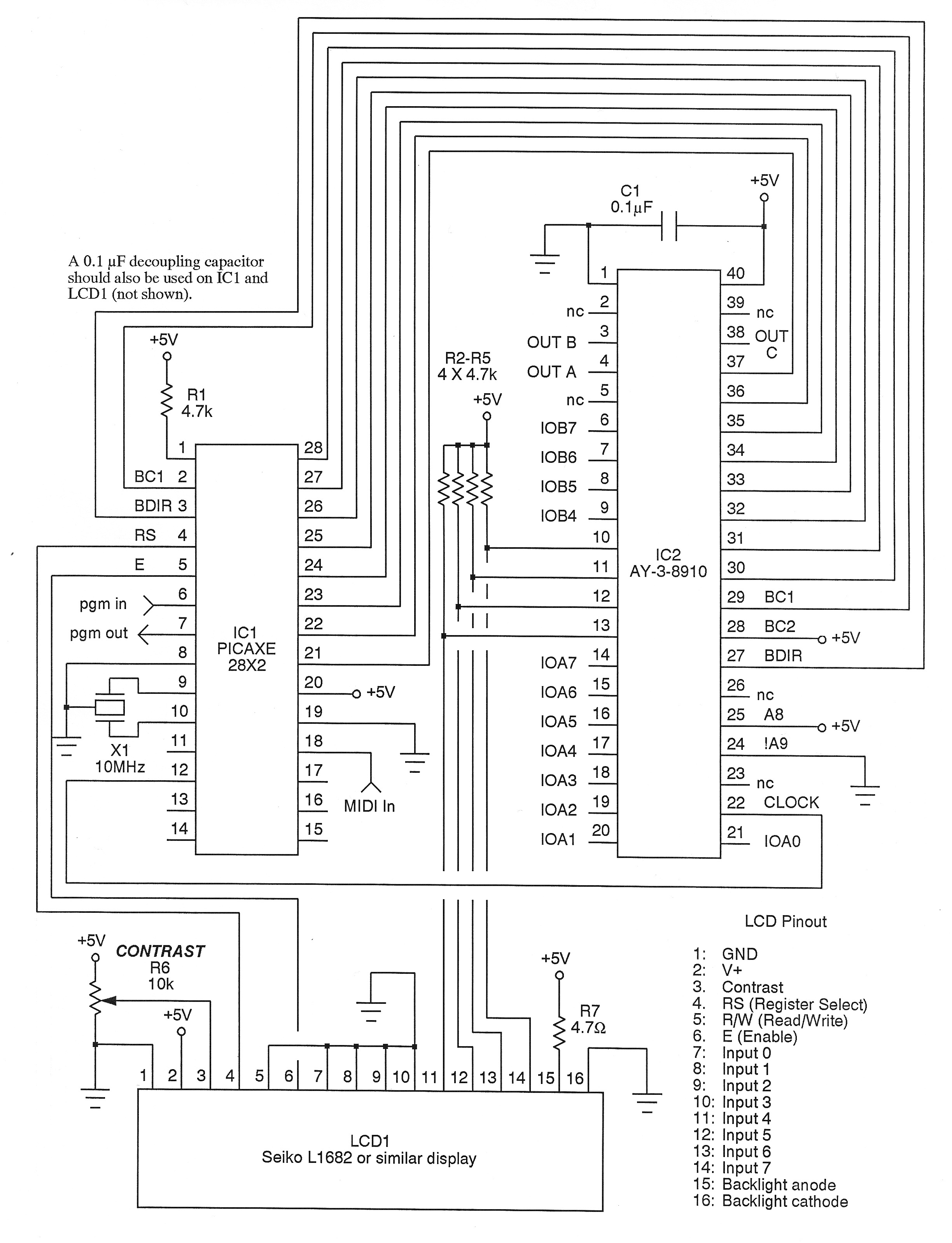

Hello all,
I decided to start a new thread for this so that it begins with the actual design rather than the philosophical meanderings of the previous announcement of a couple years ago.
Here's what we're shooting for. The AY-Voice will be a three-voice, polytonic affair with noise and tones, EG, LCD display, cursor keys for menu navigation, etc. It will also sport 8 gate/trigger outputs (good for percussion, etc.) and MIDI transport outs Start, Stop, Continue and Clock (good for sequencers and recorders).
The processor is the Picaxe 28X2 and the sound chip is the AY-3-8910. Note that the latter has two, 8-bit uncommitted data ports, hence the large number of features possible.
There's a lot to learn as we go along here, so I'll be building up the project step-by-step so I can learn the features of the AY-3-8910. (Its data sheet is some fifty pages long). As a first step, I confirmed that I knew how the Picaxe worked by simply blinking an LED once a second. That was a couple days ago.
The next step which I finished today is to again blink an LED, but with a huge difference. This time the Picaxe is controlling the AY which then blinks the LED. This confirms that bus access to the two ports is working as expected. It may sound trivial, but with a combined data/address bus it was an important first step. Since all control of the AY registers works in a similar way, it should be all downhill from here.
I'm hoping my comments will attract some of you for testing and confirmation. I'm attaching a pic of the breadboard, the Picaxe code and the schematic if you'd be willing to try it out. Note how simple it is (both hardware and software). In the fact, the circuit consists mainly of wires, rather than components. Here are a few other notes.
X1 is a three-pin 10MHz resonator. However, the Picaxe has an internal X4 multiplier, so the program actually runs at 40MHz. The middle pin is ground, otherwise the part is non-polarized. I'm guessing this will be fast enough for good MIDI performance. Notice also that the Picaxe has a 1024 byte queue for the serial input, and that serial input runs in the background (independent of the program) suggesting the MIDI might be reliable.
Pins 6 and 7 of the Picaxe are the programming pins as described in the excellent free manual from Revolution Education. Not shown are the pull-down and current limiting resistors; refer to the manual. I envision the final circuit board having a 3.5mm jack on these to make firmware updates a snap.
Again, there are 16 uncommitted port lines on the AY. I envision every pin of that chip and the Picaxe will be used, even though this stripped down starter circuit shows many unused pins.
Next step is to interface the LCD not with the Picaxe (which is easy to do) but with the AY which connects to the Picaxe. Hence the LED experiment here to confirm I understood the read/write/addressing protocol of the AY.
So, I'd be most happy if anyone here jumps in and confirms my results as we go along. Next installment (the LCD) should come along in a day or two.
This should be a great learning experience for those with a bent for hybrid analog/digital music.

I've spent the last two days working on interfacing the LCD by means of the AY IOB port. It's going to work! This is an important breakthrough for more reasons than one, but especially because it frees up oodles of port pins on the Picaxe for other things.
I do have one thing I have to work through, though. I still haven't coordinated the timing of the resets to the Picaxe, AY and LCD. The way it is now, the LCD works perfectly for all sorts of things (scrolling, printing backwards, block/underline cursors, blinking, etc.) but only after the unit has run for a minute or so. Like I say, this is something to do with the multiple resets I think, and I'll eventually figure it out. The important thing is that I now have confirmation that the Picaxe can drive the AY which drives the LCD and all beautifully.
I do have a schem and code, but won't post it until I figure out the necessary reset sequence. But this truly is getting exciting. It occurred to me last night that even if a person ignored the sound generators in the AY it would still make a great peripheral adapter what with its 16 port pins.
More tomorrow,
Thomas Henry |

Hi again,
Here's some more news. I've spent the last three days working exclusively on this project (some forty hours at the bench). My goal was to fire up the LCD by means of Port IOB on the AY.
Well! What should have been easy turned into a nightmare. I was in fact able to put the LCD through its paces. Sometimes it worked nonstop for hours and other times it would simply refuse to come up. After many, many experiments both in hardware and software it seems likely that there is a subtle timing problem in the reset sequence. (Keep in mind that the Picaxe, AY chip and the LCD all go through their own power-on resets). It's either that or a stray capacitance problem on the breadboard.
Speaking of which, I had to abandon the previous breadboard when I (finally) noticed that each power bus dropped an additional 0.2V. By the time I got to the last rail, the power supply was down to 4.4V or so. What junk!
Anyway, you get the idea. This week has been spent fighting some real-world things that sometimes happen. The design on paper looked fine, but not so on the breadboard.
So, I'm going to go back putting the LCD on the Picaxe (which I did get working well several years ago) and put the navigation switches on the AY. Speed is not an issue with switches as it is with the LCD.
I'll redraw the schem and revise the code appropriately. I should have both posted in a day.
Thomas Henry |

Hi All,
Okay, now I'm really pissed. After taking a break for a much needed several hours respite from the workbench it finally hit me: there is no major reason why this shouldn't work. After all, it's just digital data being transfered from register to register and at not too onerous a clock rate. I've decided that pumping the LCD from the AY is really the best way to go for several reasons so want to stick with this a bit longer. If nothing else, I want to know why this is acting up. (I hate mysteries, which is why I became a mathematician).
So who wants to help out with some testing and theorizing? I've attached the schem and code. On my breadboard, sometimes everything works well and sometimes it doesn't. The code was designed to put the LCD through its paces just for testing purposes. It should print various messages to the LCD, scroll left, right, blink and so forth. The purpose is simply to see what the LCD can do. If I don't use the AY as an intermediary, it works perfectly. When I use the AY, behavior is dicey.
Will someone please try this out and leave some comments here? For my part, I'm going to rebuild everything on the breadboard and double-check the code yet again.
Thanks for contributing!
Thomas Henry

But looking at the ckt diagram, what is the reason for managing RS and E from the picaxe directly rather than through the AY bus? Wouldn't using a couple more bus pins from the AY chip help be sure those were all in sync? |

RS may be possible that way, but handling E would be troublesome since it requires a trigger pulse. (RS is simply a logic level). The AY chip uses a data-address bus, i.e., first you latch the address and then you latch the data which goes into that address all on the same bus. Because of that, it takes several dozen Basic commands to toggle E on and off. E takes a trigger signal 10 uS wide which is easy to handle from the Picaxe using the PULSOUT command.
For what it's worth, in my experiments earlier this week I took your comment into account by testing various delays after latching the data just to make sure the Picaxe ports weren't outpacing the AY ports. No change.
However, I thought of another experiment to try later today which would help confirm the AY port isn't sluggish.
Thanks for the idea, and please keep them coming!
Thomas Henry |

I thought a bit more more about Elmegil's suggestion and decided to try putting RS and E on IOB.4 and IOB.5 of the AY. As it turns out, the code required to handle this isn't messy at all, so you can jettison my previous comment.
However, the behavior is the same. Sometimes it works, sometimes it doesn't. By not work, I mean that random characters appear on the screen.
My suspicion all along is that it has something to do with the reset sequence. I spent several hours with the LCD data sheet today and figured out how to code a manual reset. That too made no difference.
But there is a curious pattern to what's going on. Changing from the Picaxe to the AY for RS and E control suggests to me the dog which did nothing in the night.
I did warn everyone that this is a pilgrim's progress, didn't I?

Hi Gang,
This was yet another long day, but with an incremental progress to report. Here's the deal. The LCD works perfectly now...
BUT...
...only after the circuit has been running for a minute or two.
It really does work as expected (IOB ports on the AY, control lines, etc.) but only after the unit has been running for a couple of minutes.
I keep coming back to, my intuition tells me there is something not quite right with the power on reset of something-or-other. So the good news is that the AY port works just fine at 40 MHz, but somehow the LCD isn't latching on correctly.
Anyone care to try it out? Attached are the schem and code. Here's what I see; I would appreciate hearing if you can replicate my results. When powered up for a couple minutes I see a bit of garbage, a blank display and so forth. Then it kicks in and shows the character set, cursor movement, panning and all the other things it's supposed to do---perfectly.
Just so you know, I moved everything over to a different breadboard and completely rewired things.
I surely will appreciate a progress report from someone else.
Thomas Henry

I'm happy to report that all is hunky-dory now; the LCD works perfectly whilst connected to the AY chip.
After another dozen hours with the data sheets (which I can recite from memory now), I finally found one of the keys I was looking for. And after single-stepping the program through the Picaxe simulator (which is part of the free software by the way), I found another not so obvious error with a binary number in the code. Finally, with several hours at the bench today I deduced the last timing link that pulls it all together.
In broad terms (apart from the naughty binary number), some things were running too fast and some were running too slowly. It was today that I noticed the latter. Thinking of the LCD as a combinatoric device is a mistake; it truly is sequential in some regards.
Anyway, here's the dope. None of the problems I was seeing was due to the AY, just the LCD. And in a nutshell they all had to do with the power on reset sequence as I guessed early on. In particular, at 40 MHz, the Picaxe reset first, then the AY and finally the LCD. Once I figured that out it all became clear.
Again, if my notes have had you worried, worry no more. The AY works like a champ, and now so does the LCD.
The schem is the same as the last one, but the code has changed. I've attached it as version 3. Remember, the code is much inflated just to show all of things the LCD can do. In the actual AY-Voice we'll only be using a subset of the code. Even so, you'll notice I've only consumed 800 bytes of the 4000 available in program space.
So it works, at least on my breadboard. Keep me posted on anything fishy you might notice. As for me, I now turn my attention to the navigation buttons for winding around the menus. I've got three options to propose:

Option 2 is the most complex, Option 3 the least. But number 1 is my choice for ease of use in the studio.
What do you think?
Thomas Henry
| Description: |
| Working code for the LCD; use previous schematic |

Hi Thomas,
Yeah, I think option 1 is the most intuitive even though the other options are tempting. Just to let you know, I did use the Picaxe, cannibalizing your code, to make my DR110 clap drum retrofit (seen elsewhere in the DIY forum). Just sent a PM to you on it. _________________ Synth DIY since 1977! |

Hi Dan,
Thanks for your opinion. I do believe I'm going to go with the pushbutton cursor control approach you voted for.
I didn't get any PM today; do you need to resend it?

| I agree with option 1 as well. It's a fairly established interface trope. A 12 digit pad is going to be 'what do I type'? and a TV remote even more so. |

Posted: Tue Jun 05, 2012 10:49 am Post subject:
| i vote option 1. Very cool project Thomas! |
