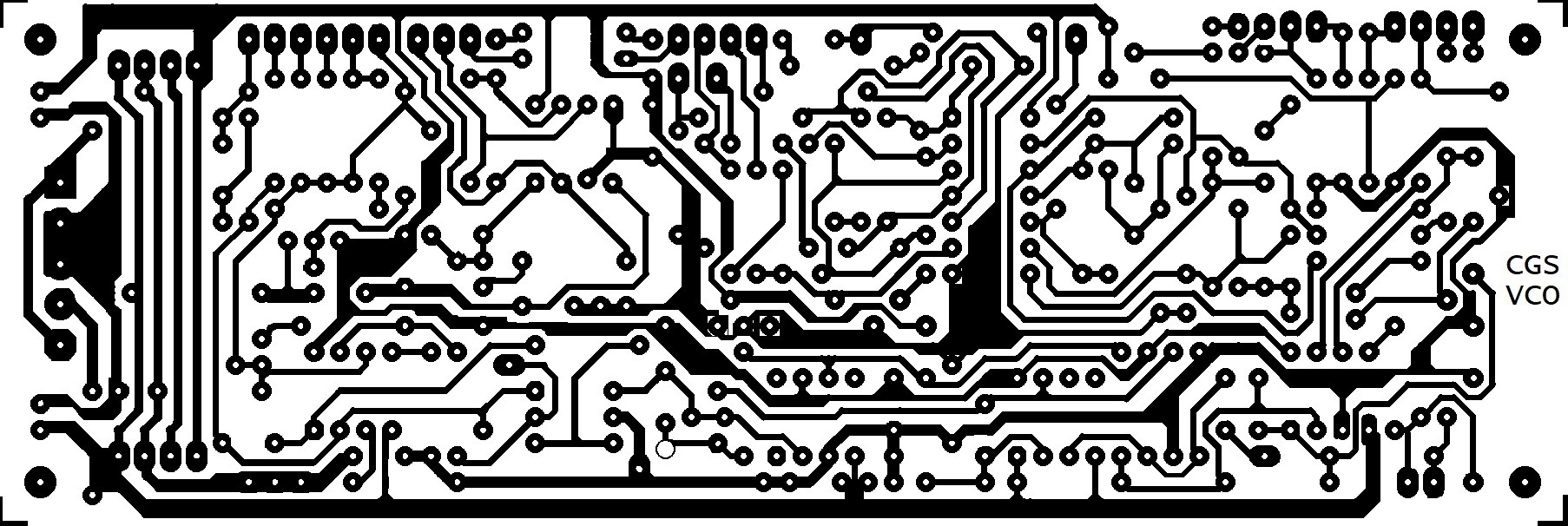

I just finished the VCO pcb, I haven't built it yet so it may have a few mistakes (hopefully not). I just messaged Ken to make sure he's cool with it.
Hubaswift
Joined: Jul 06, 2016
Posts: 91
PostPosted: Thu Oct 05, 2017 5:01 pm    Post subject: Reply with quote  Mark this post and the followings unread
The Buchla Timbre/Crossfader circuit looks really cool. I may decide to incorporate that into each VCO to make it more like a Buchla system. I just want to make sure I'm looking at the right circuit, is this it? http://modularsynthesis.com/lanterman/timbre-crossfader/timbre-crossfader.htm
Here's the CGS VCO pcb for you to etch at home, I don't know how to make it a pdf so that it's in the right scale, so you may have to play around with it for a bit to get the image the right size. I haven't tested it myself yet so there may be mistakes (hopefully not).
Edit: Mistakes corrected
 Filesize:  445.28 KB
 Viewed:  713 Time(s)

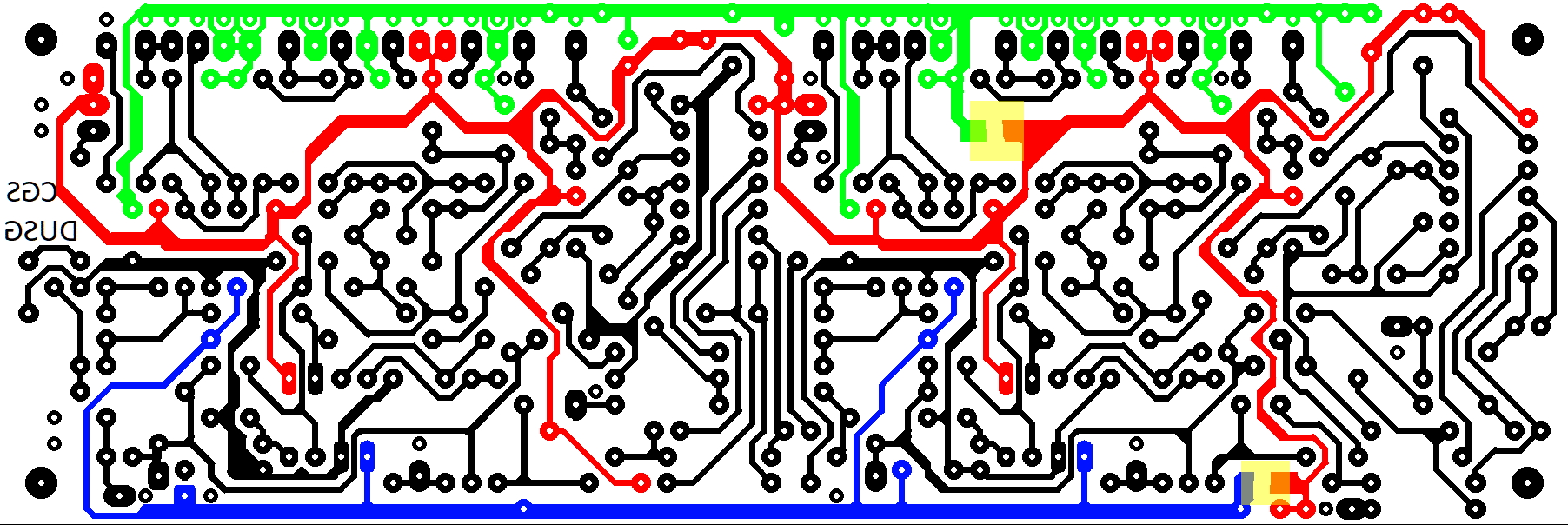

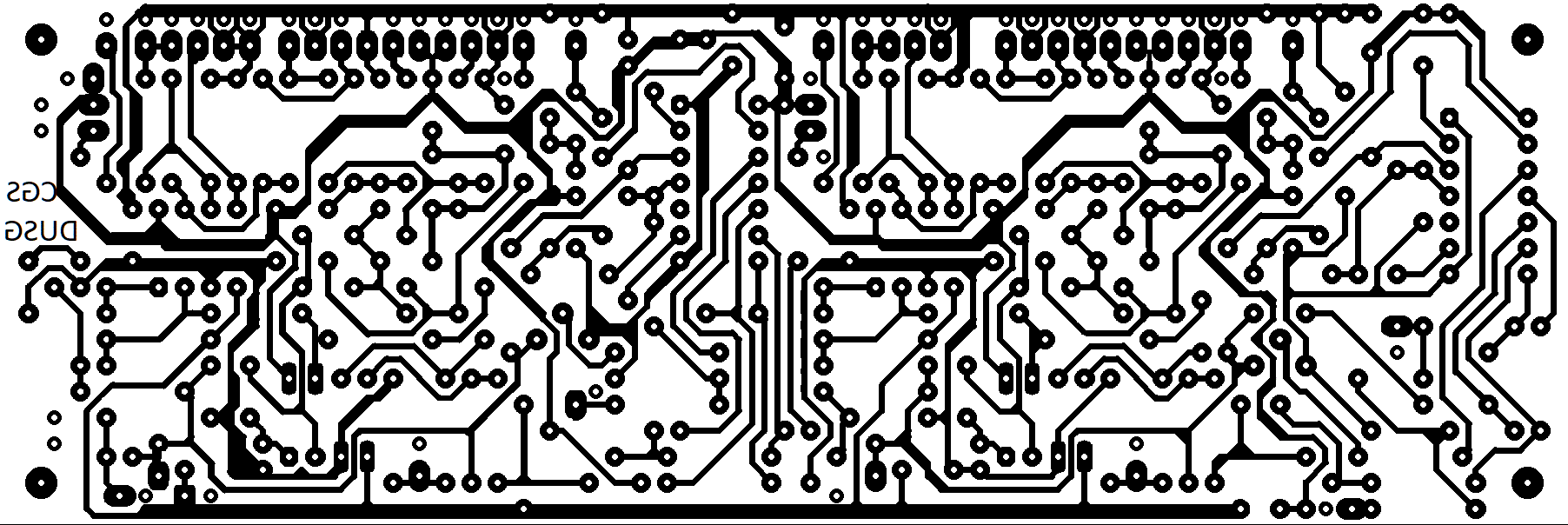

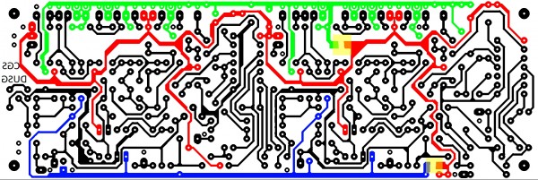

PostPosted: Fri Oct 06, 2017 9:43 pm    Post subject: Reply with quote  Mark this post and the followings unread
Here's the CGS DUSG pcb. Again, there may be mistakes as I haven't tested it yet (I'll get around to etching and building these all myself once I've finished all the pcbs I plan on doing). What do all of you think about starting a separate topic specifically for all the pcb layouts, so that people won't have to sift through this build thread?
Edit: Mistakes fixed
 Filesize:  51.32 KB
 Viewed:  731 Time(s)
gabbagabi
Joined: Nov 29, 2008
Posts: 652
Location: Berlin by n8
PostPosted: Mon Oct 09, 2017 6:46 am    Post subject: Reply with quote  Mark this post and the followings unread
wow, thats looking good!
You can make a PDF document with all the pcb layouts and put it in your first post.
edit: it really would be good if you can make pdf's. Normally every Layout program can printout the pcb layout, ether directly or you install first a pdf printer (eg PDF24), or use the microsoft xps printer option, (from xps to pdf it is only a few clicks)

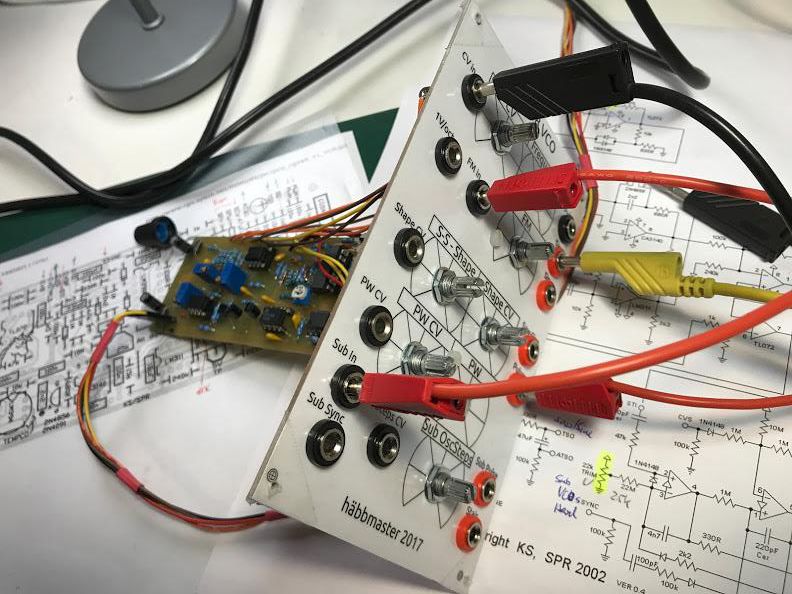

PostPosted: Mon Oct 09, 2017 7:10 am    Post subject: Reply with quote  Mark this post and the followings unread
This ist great work you're doing here. Thank you.
I already did 3 USGs on perfboards, but I will use your layouts now.
I don't think you should make another thread, so we have all in one place here

Hubaswift
Posts: 91
PostPosted: Mon Oct 09, 2017 5:10 pm    Post subject: Reply with quote  Mark this post and the followings unread
I haven't been using any layout program for these pcbs, literally MS paint... I should probably figure how to use a layout program though, I'll see if I can figure that out for the next pcb. I'll be less likely to make a mistake that way too. I just imagine it being a lot harder for it to line up perfectly with normal CGS boards.

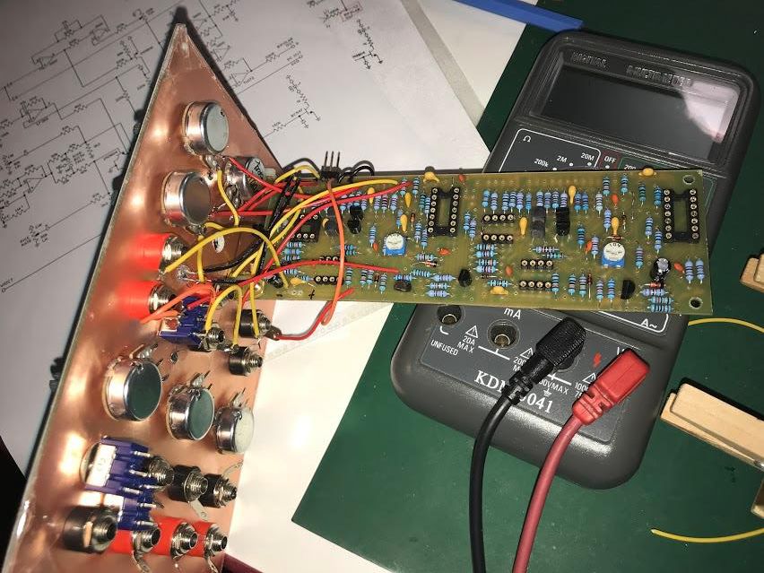

PostPosted: Sat Nov 04, 2017 1:09 pm    Post subject: Reply with quote  Mark this post and the followings unread
Thank you!!!!
It Works!

Hubaswift
Posts: 91
PostPosted: Sat Nov 04, 2017 9:13 pm    Post subject: Reply with quote  Mark this post and the followings unread
!!!! I'm really glad that it turned out good. Looks great Very Happy

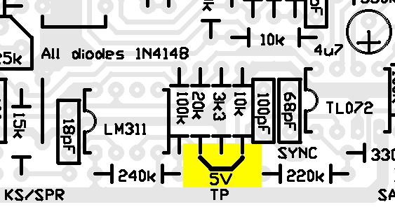

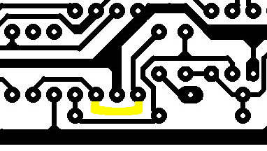

For those about to build:
There is a wire jumper that is not mentioned in the building instructions (at least I couldn't find it) and I didn't understand what it means when I looked at the picture. There are no holes for this.
Without this, nothing happens at all!
Perhaps you could insert a track here in the pcb (after checking wheter I'm right, please)

Yea, looks like a mistake on my part. Thanks for the heads up. I went back and edited the post to include this track.

No, it's a problem of the original PCB. Thanks for correcting.

So, for the DUSG:
You have to make two cuts on your PCB. The original of Ken Stone is a bit confusing here. Looks like he made these cuts afterwards too.
You can check for shorts with the fill function of your paint program.
