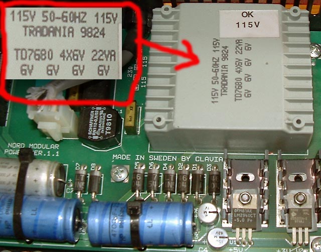

PostPosted: Tue Jun 15, 2004 6:45 am    Post subject: Reply with quote  Mark this post and the followings unread
OK.. this is why I did not trust the faq and the answers from Clavia:
 Filesize:  66.19 KB
 Viewed:  24079 Time(s)

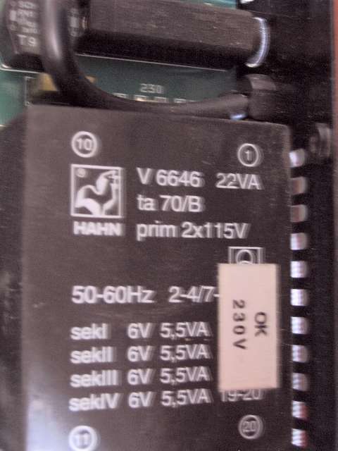

Posts: 24506
PostPosted: Tue Jun 15, 2004 11:14 am    Post subject: Reply with quote  Mark this post and the followings unread
The picture suggests the transformer has two 115 Volt windings/coils and ffour 6 Volt windings, just as the transformer in my NM (although mine has a different brand).
This means to me that the directions in the FAQ also apply to your NM.
I wanted to attach a picture to this, but unfortunately that didn't work (something with FTP settings that I should check it mumbled before throwing everything away).
Jan.
EU NM transformer

PostPosted: Tue Jun 15, 2004 3:51 pm    Post subject: Reply with quote  Mark this post and the followings unread
That makes sense, Jan. Sometimes manufacturers change part suppliers with no impact on the products quality. I understand Elektro80's concern, however. Nobody want to smoke a NM.
