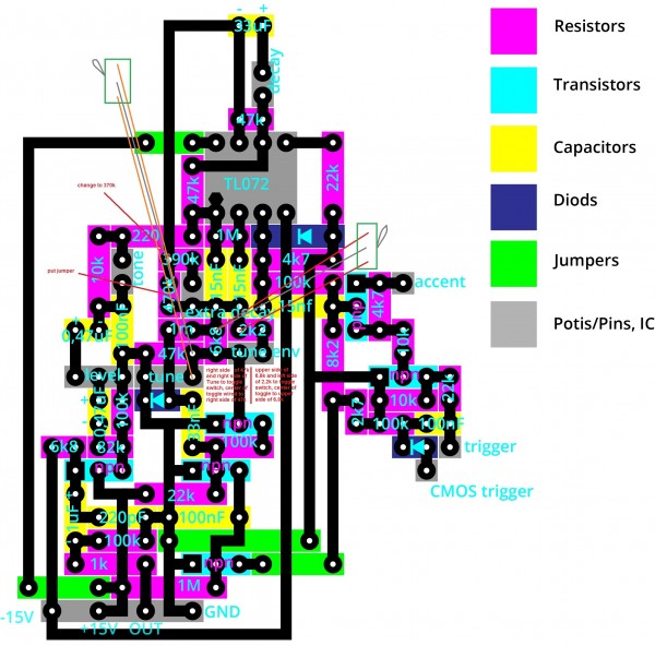

Hi guys.
today i finally built the TR808 BD using this layout..
http://praxistest.cc/wp-content/uploads/2012/02/platine.jpg
i connected the ACX lite mid2cv trigger out to the trigger in of the TR808 BD, i get nothing!
well, i get the osc working when turning the decay pot up, the tone is working, even the pitch works, but i dont get the kick, only the osc sound.
i've checked everything, orientation of the transistors, resistors, i dont know what to check anymore.
maybe i need to trigger with higher V? the ACX midi2cv is only outputting 5V.
BTW what is a CMOS trigger?
any help will be grateful.
Isak E.
PostPosted: Wed Oct 02, 2013 7:40 pm    Post subject: Reply with quote  Mark this post and the followings unread
Do you have anything wired to accent?
I went through that particular layout once before and it matches Eric Archer's take on the circuit. And I spent a lot of time crawling around the original circuit when I was troubleshooting a stripboard layout by minus.
The CMOS input basically is a trigger conditioner/gate to trigger circuit--you can feed it with more gate-like things and it will still trigger reasonably. The trigger input bypasses the diode/resistor/cap used for this purpose.
If you have nothing wired to accent, nothing will ever happen with your circuit. The original circuit actually worked a little backwards from what you might expect, looking at that. What this circuit uses as a trigger in was actually just the circuit enable. What actually triggered it was the "common trigger" pulse routed to all voices, which would then operate only if the enable signal was high as well. The common trigger would vary from 4V to 14V depending on the accent setting for a given step, and there would be one pulse for every step based on the rate.
All that said, I have not only wired up minus' stripboard version of this circuit, but also bananuerysm's PCB as well. If you're not driving it from a circuit meant to mimic the 808's setup as I've described it (and almost nobody is), your best bet is to:
1) use the CMOS input, you will get better results in general triggering from arbitrary sources.
2) normal the trigger jack to the accent jack. If you send the same trigger pulse to both points, it should work great. And if you do it with a switching jack for accent, that will let you get some accent variation using that jack when you choose to.
Hope this helps....
Edit: Another alternative would be to just wire the accent line high all the time, or to a pot for manual accent setting, I think I've seen that pretty commonly done.

Hi elmegil and thank you for replying.
As I got up today and saw your reply even before washing my eyes I run down to connect power to accent And it worked! I got 808 kick drum Smile
after making few tests I have further questions..
In the layout they don't say the values of the pots so I used MicroLarge site for the pots values.
For the Tune ENV pot I used 5k, it seems that it's doing nothing!?!
The decay is 500k Lin, when turning it a bit it starts to self osc, this the way it suppose to work?
The extra decay pot Is 100k, it work like a fine "tune" decay, this is how it suppose to be?
Beside that everything works great! I love the pitch add on, it's really cool.

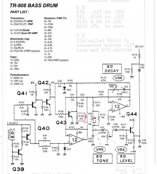

"Tune" is a mod, I've typically seen it documented as 100K. It replaces a 47k resistor that sets the frequency of the oscillator.
if i'm not mistaken the Tune pot is in parallel with the 47k, not instead, if this is the case eventually it gives me 32.203 kohms not 47k.
maybe i need to put a switch there, do you see my point?
take a look at the attachments .. (marked in red lines)

PostPosted: Fri Oct 04, 2013 6:53 am    Post subject: Reply with quote  Mark this post and the followings unread
So yes, having it in parallel, and that ending up peaking at 32K or so would leave you higher than the standard pitch. There are two ways to address that: put the pot in series and drop the 47K value down to something you'd want to be the lowest resistance on that leg (which would take some significant rework of the PCB, I think), or use a switch.
So the switch sounds like a good idea Very Happy

i have this thought..
instead of using a switch i want to use only a pot.
i'll connect an 47k pot instead of the 47k resistor, but connect the pot backwards, so when it will be all the way down i'll get 47k and when starting to turn it up it will go up the pitch cause the resistance will go down.
what do you think?
PostPosted: Fri Oct 04, 2013 10:11 am    Post subject: Reply with quote  Mark this post and the followings unread
I'd think that would work pretty well; you might want a series resistor to keep you from going ALL the way to zero, not sure whether the oscillator could handle that.

PostPosted: Sat Oct 05, 2013 7:53 am    Post subject: Reply with quote  Mark this post and the followings unread
hi elmegil
after giving it a thought i would like to put a switches, i want a true bypass of the mods.
after going through microlarge pcb ive decided to do the same way and the same values.
this is what i came up with..
i'll post my finding soon.
cheers.

I've tried 15V, 12V and 5V.
after founding this i disconnect the permanent power from the accent and connect the midi2cv 5V trigger and at the CMOS i connected the midi2cv 5V gate.
this is how i trigger the whole deal.
i didnt tried the trigger to the trigger and the accent in yet.
I tried few things to make it closer to the original click.
I put an EQ to the click, boost around 500hrz, it was very close!
So my thoughts are that there is a Q level (resonance), that I need to find a way to boost, or am I wrong?
isak
Joined: Dec 13, 2009
Posts: 847
Location: Israel
Audio files: 18
PostPosted: Tue Oct 08, 2013 3:20 pm    Post subject: Reply with quote  Mark this post and the followings unread
an update..
i manage to fix the punchy click sound Smile
i put a trimmer instead R166 which control the Env, now the click is high Smile
the only thing that got left is the pitch of the click, i need to get it higher, ill be happy if you can help with that please.
cheers.
 Filesize:  190.41 KB
 Viewed:  399 Time(s)
PostPosted: Tue Oct 08, 2013 5:19 pm    Post subject: Reply with quote  Mark this post and the followings unread
Unfortunately I'm not clear on what sets that pitch, and I don't have any cycles to measure it Sad Major work release 1am in the morning, still scrambling....
isak
Posts: 847
Location: Israel
Audio files: 18
PostPosted: Fri Oct 18, 2013 6:20 am    Post subject: Reply with quote  Mark this post and the followings unread
hi elmegil
i found a way to control the click with a help of a friend (thanks Sebo Smile )
i used the CMOS trigger in to trigger the BD but it needs to be 1ms trigger for it to sound like the original click.
he told me to lower the 100n cap to like 47n and from there to start checking.
so i did.
47n was a bit high pitch click so i lower it to 33n which was to low in pitch, so i add to the 33n another 4.7n in parallel and it was perfect!
the same click pitch as the original Cool
now the only thing i want to do is to amplify the click a bit for it to be like the original, i wander how... scratch
cheers
