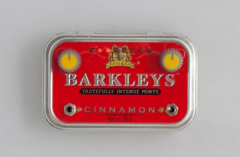

Hello,
been reading this forum since few years, now its time to go more active.
I would like to present my new design - hand-held sequencer/synthesizer.
Sound engine contains 3 square wave generators and 4 triangle/square wave LFOs. 3 LFOs modulate pulse width of 3 DCOs, while fourth LFO act as output volume modulator - its frequency goes to audio range. You can create 2 8-step sequences simultanously: sound pitch (note) sequence and note slide sequence. The interface is extremely reduced (only 2 knobs, 2 pushbuttons and 2 switches), but creating new sequences is quite easy. Device has also 8 memory slots, each holds 8 step note and slide sequence. Circuit uses no DAC, all waveforms are mixed analogue. All fits in mint can and is powered with 9V battery.
Topology:
- 3 DCOs, analog output & mixing,
- 3 triangle wave LFO, modulating DCOs pulse width, synchronized with sequence,
- 1 square wave "effect" LFO,
- 8-step sequencer with note/slide sequence,
- 8 memory slots.
Controls:
- note selection (over 6 octaves),
- slide on/off,
- sequence transpose,
- sequencer speed,
- "effect" LFO speed,
- memory bank selection / read / write,
- "live" effects - double speed, reset sequence (not implemented yet).
Inputs:
- sync input (not implemented yet).
Output:
- line out.
Demo was recoreded in one take. No external effects, pure OneDog audio output. At 1:11 "effect" LFO comes into play. Hope You enjoy it.
OneDog synthesizer view.
 Filesize:  72.68 KB
 Viewed:  235 Time(s)

The are some plans, but rather "foggy". Maybe i will launch it as kit, it's extremely easy to build and fits almost everywhere.

i'm in the middle of circuit / software redesign. I've added simple drum machine and improved synth engine (chords, oscillator sync, manual PWM and more). It sounds much better now and is quite power efficient. I will make some demo, after i finish.

It's based on ATMega8A microcontroller, clocked by internal oscillator @ 8MHz with 3,3V power supply. On 9V battery it works forever.
