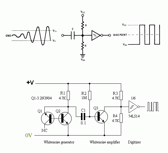

I've just build the heterodyne white noise part, and it seems to be a very "shy" white noise source...
Well, i used a 4049 as preamp, and i didn't use 2n3904, but bc547b instead for transistors...
Is it normal if it's not so loud ? Did il make mistakes in building this part as a stand alone ?
Thanks for any answer !

Most any general purpose npn transistor can be used in this type of noise circuit, but Q1 should be socketed so that you can select a transistor that makes the most noise.
I'm don't know that the 4049 can be used as an amplifier, but I do know that the 4069 (74C04,) can be.
Another thing you might try to boost the noise is replace diode D5 with a capacitor. I don't see why there needs to be a diode there.
If you still can't get enough noise, put back diode D5 and try one of the circuits below. You should have two 40106s left over. Try the top circuit (from National Application Note AN-140,) first. If that still doesn't get you enough noise, stick another transistor in front of the schmitt trigger, as in the bottom circuit.
And as long as I'm putting my 2cents in here... I must correct one bit of information in beavis' otherwise excellent article. Experiment 6 states "Diode D1 keeps oscillator two from feeding back into oscillator one." If anything, the direction D1 is pointing allows oscillator two to feedback to oscillator one, but that's not what's going on in this circuit. When U1a output is low, it pulls down U1b's input, preventing it from oscillating. When U1a output goes high, the diode blocks the DC level from reaching U1b's input, allowing it to oscillate. In other words, oscillator 1 gates oscillator 2 off/on.
