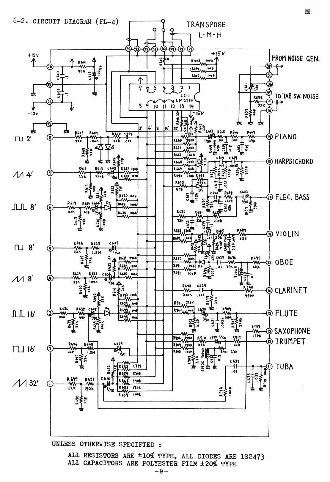

does anybody know how to exactly wire the 6 pins of the preset switches together ?
the descrition from mr. synth : You simply have to open you SH-2000 and reconnect the wires to all the preset-rocker-switches - sort of making a straight pass.
i tried some combinations already but it doesnt seem to change the sound with 2-3 wirings. will the effect only be audible when all the connections are done ?

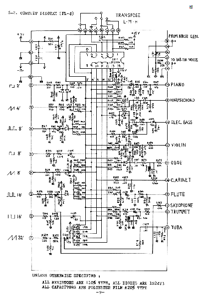

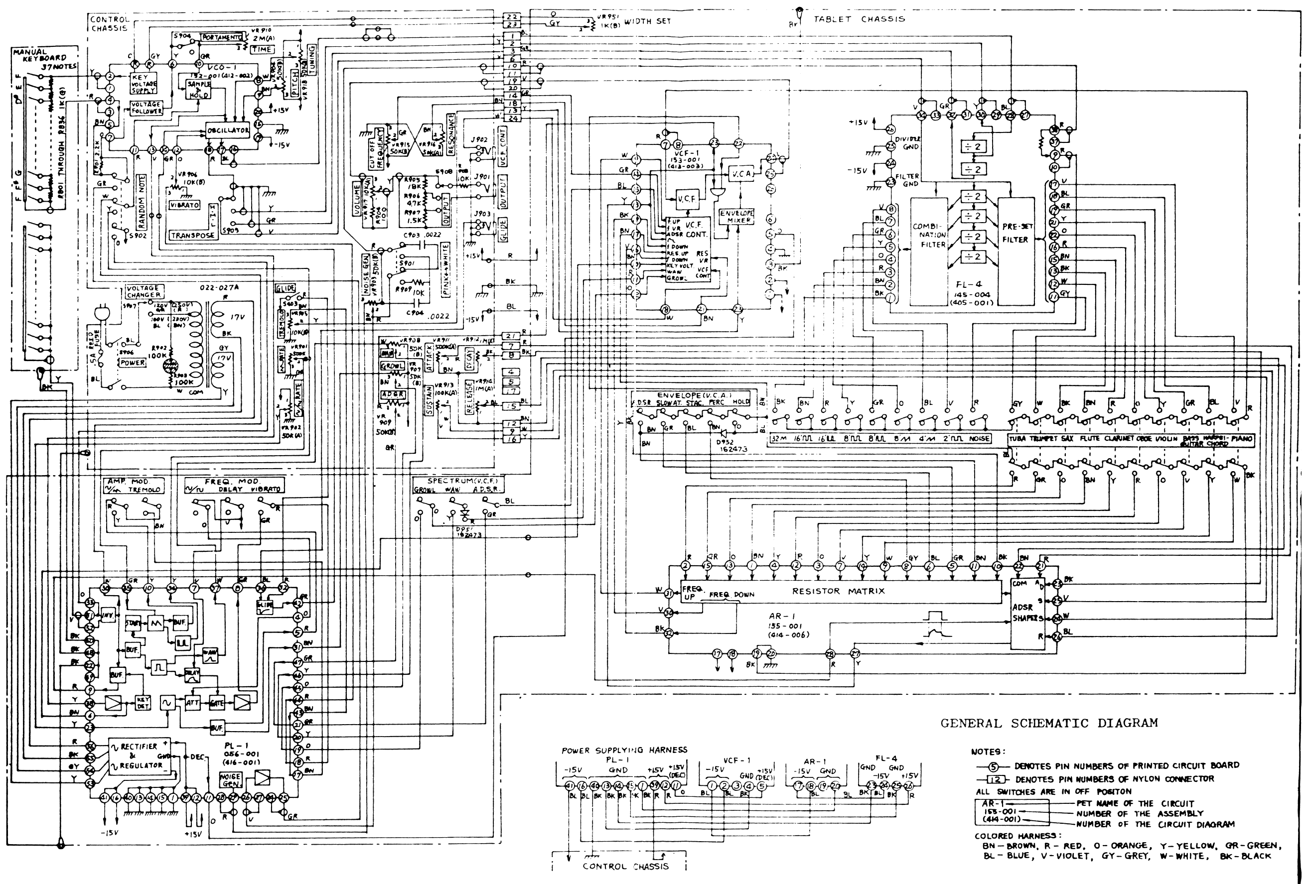

It does not compute for me. Maybe the attached files will help.
 Filesize:  611.33 KB
 Viewed:  817 Time(s)
 Filesize:  189.98 KB
 Viewed:  565 Time(s)

hey icky
thanks for this, but i would really need it explained in words Wink

PostPosted: Mon Mar 08, 2010 7:34 pm    Post subject: Reply with quote  Mark this post and the followings unread
Oh my, I misread this thread. Those schematics are from a SH1000! Embarassed
Sorry.

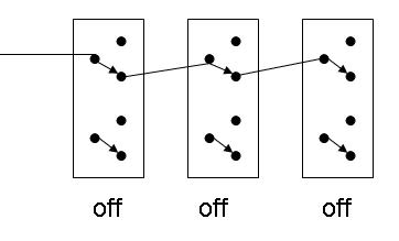

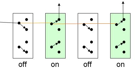

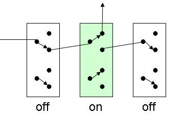

Here is the modfied circuit allowing other presets to be activated altogether.
 Filesize:  11.7 KB
 Viewed:  13852 Time(s)
original circuit : when one preset switch is ON, others (at the right side on the diagram) are OFF (disabled).

original circuit : all preset switches are OFF, voltage goes thru all of them.

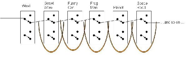

I did it and it works! I simplified the soldering task though... too many wires to resolder and I am not a skilled to do so. So I took another way to link all preset switches together. I added wires with hooks at both ends and soldered them between each preset connectors. So it means that I left the original wiring in place. It took me at least 3 hours to complete this task. See diagram for better understanding. Hope it helps.
Preset "Wind" not mixed. New wires soldered as "Bridges" between connectors, to avoid resoldering wires that link pin #3 to #2.
