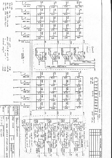

vtl5c3
Joined: Sep 08, 2006
Posts: 425
Location: PDX
PostPosted: Sun Jun 29, 2008 9:13 am    Post subject: Reply with quote  Mark this post and the followings unread
Hi Unkle Krunkus!
No, I didn't say I would post it. I'd assumed that it was on the net already, but as it turns out... it ain't. Here it is.
R.

PostPosted: Sun Jun 29, 2008 12:16 pm    Post subject: Reply with quote  Mark this post and the followings unread
would there be a sound difference between this one and doepfer one (scehmatic on doepfer diy page) http://www.doepfer.de/DIY/a100_diy.htm

PostPosted: Mon Jun 30, 2008 3:46 am    Post subject: Reply with quote  Mark this post and the followings unread
I'm still trying to work out what it does and how it does it! Confused Rolling Eyes

vtl5c3
Posts: 425
Location: PDX
PostPosted: Mon Jun 30, 2008 2:01 pm    Post subject: Reply with quote  Mark this post and the followings unread
OK, and here's the PCB layout. As you can see it's nothing fancy, just 6 dual opamps configured as summing opamps. The Buchla 205 had 4 opamps for one side (left), 4 for the other (right), and another 4 for both channels (L&R). There was also an opamp for the monitor outputs, but I left that off.

vtl5c3
Posts: 425
Location: PDX
PostPosted: Mon Jun 30, 2008 6:38 pm    Post subject: Reply with quote  Mark this post and the followings unread
Hi Krunkus!
The Buchla 205 has two sections that are both 5 input mixers where any of the 5 inputs can be sent to any of 4 outputs. In addition to the 4 outputs, there's an extra 4 outputs that are mixes of both sections.
For the live gig, I will be feeding 8 vcas into each of the matrix inputs and directing them to 6 monitors in the performance space. I will use the 2 additional outputs as effect sends. That's where I'll probably get some wacky feedback going!

PostPosted: Mon Jun 30, 2008 7:16 pm    Post subject: Reply with quote  Mark this post and the followings unread
So how have you adapted that to an 8*8?
