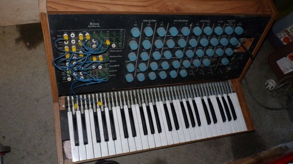

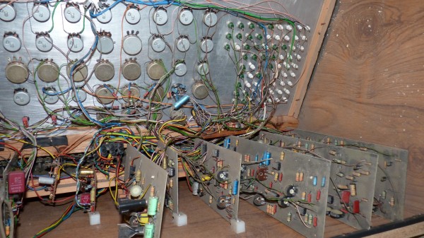

PostPosted: Mon Nov 15, 2021 3:12 am    Post subject: Back from the dead....?
Subject description: Wireless World Synthesizer 1973
Well.....magman, did you finish it?!
I'm just in the process of resurrecting mine....
A new link to the WW article:
http://www.keith-snook.info/wireless-world-magazine/Wireless-World-1973/Electronic%20sound%20Synthesizer.pdf
