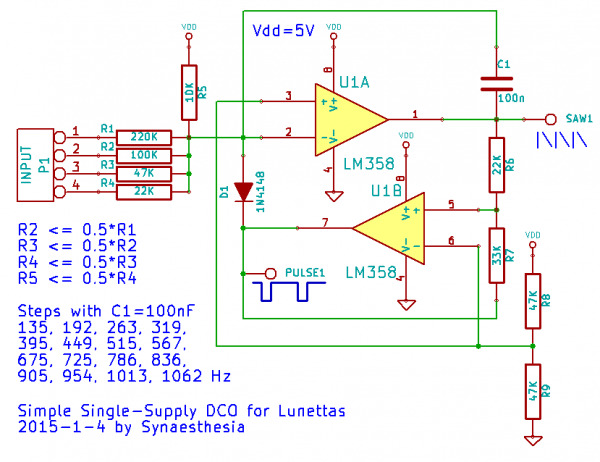

The oscillator won't work with 40106 inverters, but you can use op-amps instead. Haven't tried it with more than 5V, but it should work as well.
