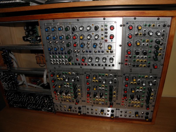

This is my latest ongoing project using the amazing boards and Panels designed by Ray.
The Cabinet is 900mm Wide and Holds an MFOS Ultimate, 4 MFOS Expanders, and 4 Rows of 64HP = 256HP Eurorack Space.
The MFOS Components are basically completed with some modifications.
I added 49 Extra LEDS to the 4 MFOS panels.
Ultimate:
- 3 x LFO Mode Output LEDS (VCO switched to LFO Mode and show frequencies).
- AR Trigger.
- AR Output.
- Mixer Clip.
- VCA Clip (High Signal).
- VCF Clip (High Signal).
- Sample and Hold (BiPolar) Output (shows the stepped output).
- Attenuators x 4 (BiPolar)
Expanders x 4:
- ADSR Gate/Trigger
- ADSR Output (shows the amplitude).
- EXT Pre-Amp Signal Clip.
- Attenuators x 2.
- Envelope Follower.
- Signal Mixer Clip.
Since I had 4 Expanders and the Ultimate had White Noise, I added extra TR808 White and Pink Noise / TR808 Hex Schmitt trigger (Metallic) Noise and Cowbell and TR909 White and Pink Noise using the (Extra Unused Ultimate Mixer Out's).
I also did a few other small modifications so the VCA's have a better response and don't bleed through so much.
And converted the 3 VCO's into switchable LFO's with Bipolar (Red/Green) LED's so you can see where the cycle is (Positive or Negative).
I also added these bipolar LED's to the LFO's and the Attenuators.
On the left Eurorack Section is space for some DIY components that I am yet to finish, there is a bunch of Synthrotek modules completed already.
All of the Eurorack modules will compliment the main Section which is of course MFOS.
There are also 3 Power Supplies in the Cabinet (You can see one in the image)
