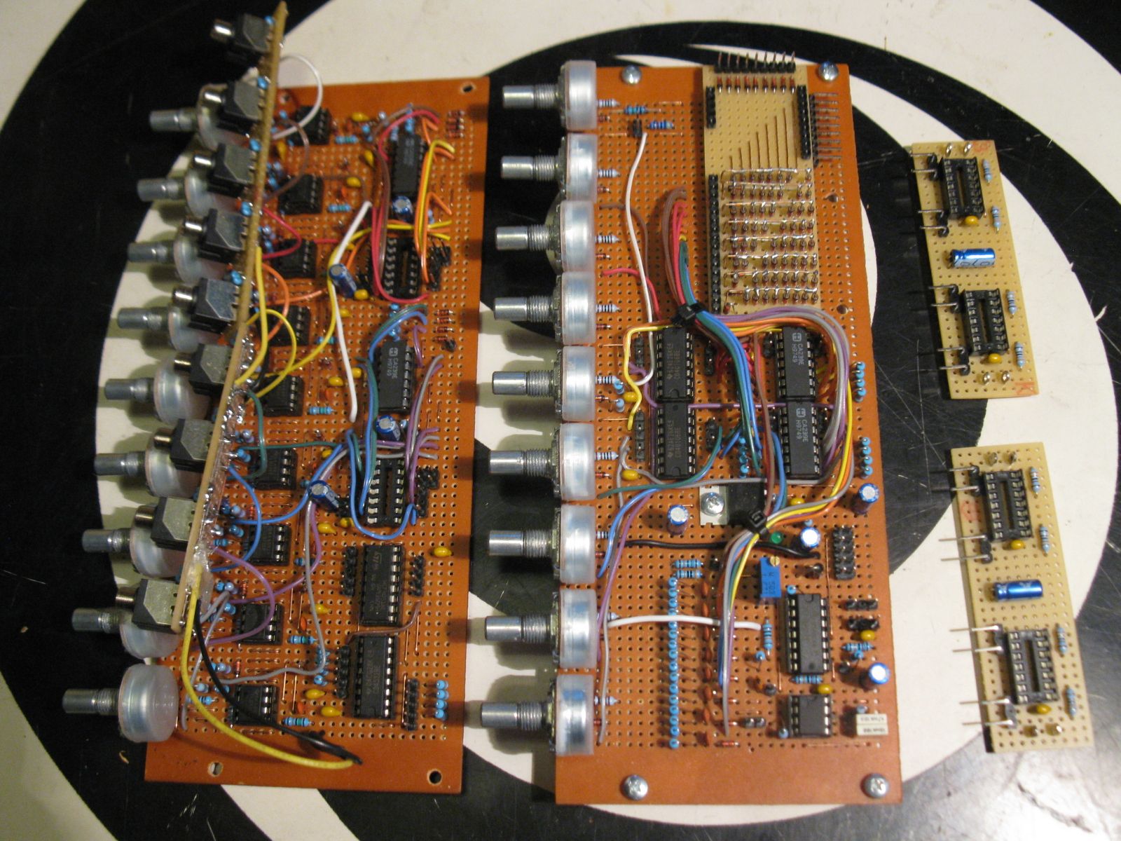

Joined: Jan 14, 2010 Posts: 5939 Location: Moon Base
Posted: Sat Jan 06, 2018 6:19 am Post subject:
I've started building QuaZar a couple of weeks ago. Most of the circuit is soldered up but I was out of diodes so
couldn't continue. Shipping those took a bit longer then usual and I had almost given up on them but but they
finally arrived. To make the diode matrix I am first creating diode arrays.
step 1: bend the diodes at an angle on one side using one of those bending tools.
step 2: stuff the diodes into a piece of perf and wrap the legs around to hold them in place. Also add a piece
of copper wire to connect them together.
step 3: solder the diodes to the wire.
step 4: remove the diode array from the perf board by cutting of the legs that have been bend over the edge
and folding the other legs back.
step 5: cut the exces legs away.

Posted: Wed Apr 18, 2018 5:47 pm Post subject:
I received the dupont cables which I used to connect everything together, so I was able to finish it over the weekend
Besides a couple minor fixes it pretty much worked instantly, or at least I think it does. The trigger output seems to
behave a bit nervous at times but I don't think there is anything wrong with it.
I did make a couple of changes to the circuit compared to the original schematic.
- There are some extra diodes added to the rectifying circuits, which I initially thought were not needed but when
testing it for something else I noticed oscillations which dissapeared when I added them.
- I added a switch to select the 0 step as well just like the other 8 (which are selected with the priority keyboard).
Note that it doesn't produce a gate or trigger signal.
- I added a voltage to the CTRL input when nothing is plugged in (normalized) for manual control.
- I used red/green LEDs and some logic to drive them. The LEDs I used are the ones with 2 pins that have a different
color depending on the polarity. The circuit I designed for drivng them turns them green when the treshold level is
reached and red when it is the highest set treshold level and thus the currently selected step. So when the CTRL
voltage rises more green LEDs turn on and only 1 red LED at a time. If you set the treshol levels for the steps from
low to high (A lowest, H highest) it actually is a nice voltage monitor.
I also have plans to make some extensions. One module will have a binary counter with an R2R which can be used
to turn it into a standard CLK triggered sequencer. The other module will have seperate gate outputs for all the steps
and 2 mixed trigger outputs that can be selected with switches. This could create some very interesting patterns.
I already added a connector for this on one of the the PCBs with all the signals I'd need.
I still need to get some knobs which would be very useful to see at what voltage the treshold levels are actually set.
Although when modulating them it gets pretty difficult to see very quickly.
Then there is one more thing. I am planning on making a seperate keyboard for it, maybe using arcade buttons, this
is what the 9-pin connector on the right side is for. However what I didn't think about is that although it works fine to
select a certain step, as soon as you release the button it will instantly return to whatever step is selected by the control
voltage/treshold level. This will of course also change the pitch. An easy solution for this is to make a keyboard with the
electronic equivalent of radio switches. So it will hold whatever key is pushed last. I will have to add a seperate gate
output which will only be high as long as a button is pressed. I could actually put a programmable sequencer in there,..

Maybe you understand what it does if I tell you it can be used as a step-sequencer but instead of a clock to step through the steps
it uses a voltage to determine which step is active. Each step uses a comparator and the treshold level is adjustable and voltage controlled.
Because of this the order of the steps and the timing between them can be completely changed. I originally intended it to be used as
a quantizer as it can change any input voltage (or actually a voltage range) to a different output voltage.
special thanks to Dave who supplied me with some great music (Orchard/Epicyclus) for wiring and soldering!  _________________ "My perf, it's full of holes!"

| PHOBoS wrote: | | Maybe you understand what it does if I tell you |
Ohhh! Now I get it!
What if two stages are set to the same threshold? |
Posted: Fri Apr 20, 2018 7:19 am Post subject:
thanks guys!
| AlanP wrote: | | What if two stages are set to the same threshold? |
Setting two or more stages at the same treshold causes a tear in the fabric of space so I try to avoid that
honestly, with some careful tuning I can get leds to light up both red and green at the same time which means it is
probably oscillating. If you listen to the CV output it sounds a bit like white noise but at a pretty low level and the frequency
is probably very high, I'll have to check it on my scope sometime. If I try it with more channels the noise is more profound.
I also did a quick test earlier, routing the CV output back to the control input which seems to cause some weird oscillations as well. _________________ "My perf, it's full of holes!"
