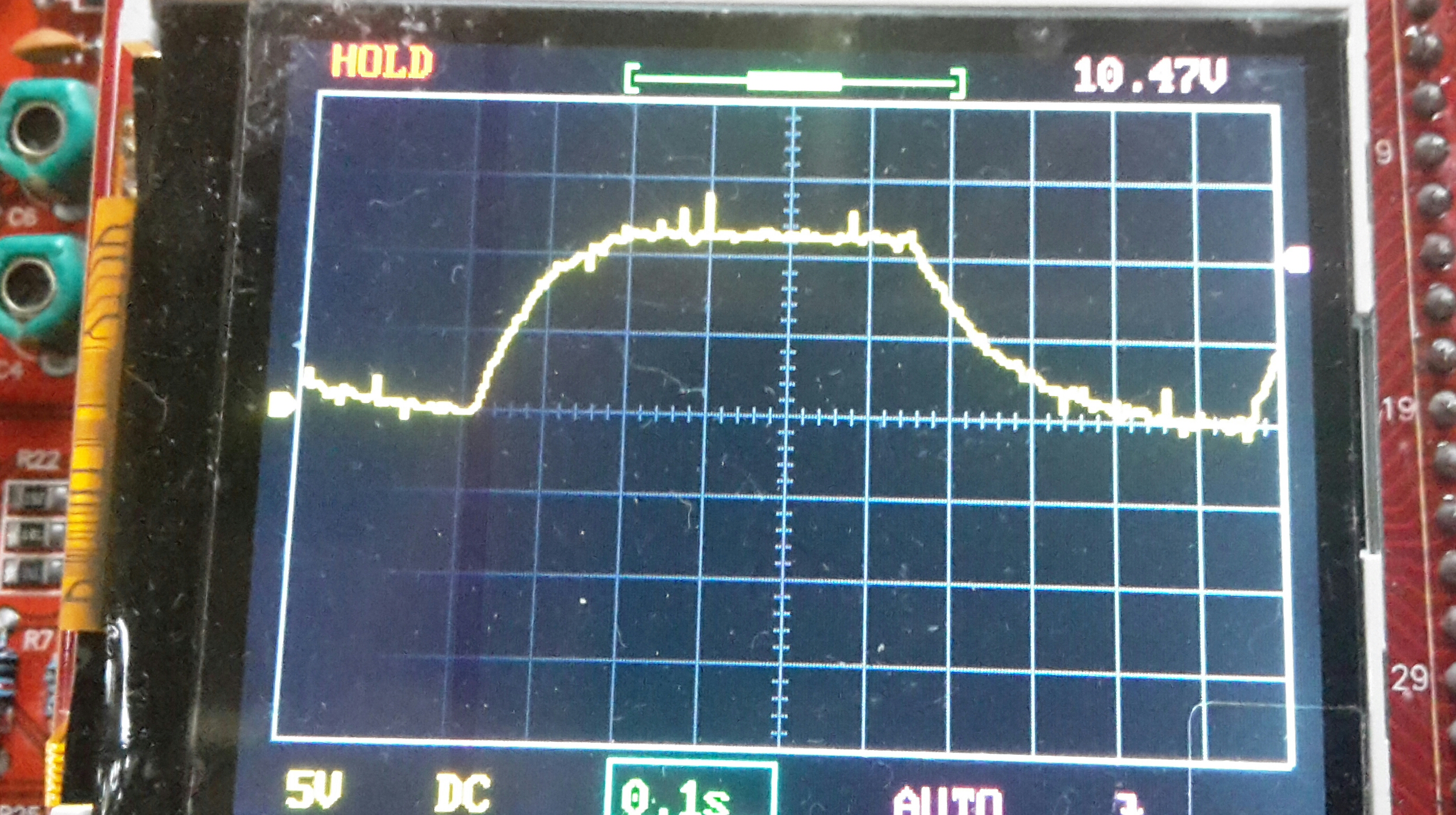

I built the new version of yusynth´s ADSR, it works but there is no affect in the decay and sustain pots. What could be wrong?
Thanks a lot - Lu

Tha adsr is working like a a/r generator. The attack and release pots are working well, but the decay and sustain pots are simply do nothing. I checked the schematic few times, but cant find any mistakes.[/img]
The photo was taken when all pots at ca 30%

http://www.yusynth.net/Modular/Commun/ADSR/ADSR555-FINAL.gif

first impulse-guessing: check if D4 is soldered in, in the rigth direction
then i would see how pin12/U2d is behaving, while attacking there should be 15V present, after attack (output reaching 10V) it should change to the sustain voltage, while release it should go back to 15V.

Problem solved! Smile
There was a failure in the pcb, Pin 1 Of the 7555 Chip was not connected to ground, but instead Pin 2 was connected to ground!
Now i'm happy to have a nice ADSR Very Happy
