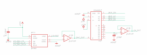

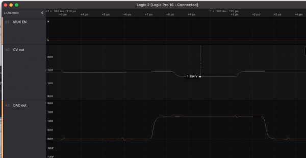

I am trying to make a high speed CV multiplexer that should update 16CVs 24000 times per second using a single DAC, but I can't get it to sample the correct voltage.
I use two Vishay DG408 multiplexers updating op amp buffers, each with a sample and hold capacitor just like any other synth from the good old days.
Because of the high refresh rate, I'm using a quite small capacitor (220-470pF) instead of the more standard 10nF that for example the Juno 106 uses.
During the time the mux is on for a channel, the channel outputs whatever the DAC outputs. But when I turn OFF the Mux, long before I change the DAC, the output rises by almost 200mV. This stays fairly constant until the next refresh.
I feel like I've tried everything and the only remedy so far has been to increase the capacitor size. I'm going mad, is there something basic I'm overlooking here? This is currently on a breadboard, so there are of course a ton of stray capacitances etc here, but I really want to get as good a result as possible before ordering a circuit board.
Any tips/things I could try out would be greatly appreciated!
CV out drops to the same level as the DAC output during the sample period, but pops back up afterwards

Not sure what causes it ... looking at the data sheets for a bit there are two things I can think of:
* For the S&H buffer you could try a CMOS opamp like CA3140 (or 3130 .. but that one has a limited supply voltage range and tends to be a bit nervous re. stability).
* The other thing could be charge injection, maybe read the section about charge injection in https://www.analog.com/en/analog-dialogue/articles/ask-the-applications-engineer-26.html# .. charge injection is specified as 20pC for the DG408 multiplexer you used .. which seems relatively high for the storage cap used (220pF).
The link above has some suggestions for minimizing the effect, you may want to look for another multiplexer to solve this issue.

Possibly: The converter IC can use more current during conversion than during idle. If the power supply voltages dip because there's not enough juice then you could see this behavior.
Try adding (relatively larger) caps near the power supply inputs to the converter IC and see if there's any change.

elektrouwe
Joined: May 27, 2012
Posts: 146
PostPosted: Sun Mar 07, 2021 5:59 am    Post subject: Re: High speed CV multiplexer - inaccurate sampling
Subject description: I'm trying to make a high speed CV multiplexer to generate 16 CVs from a single dac, but have issues
tysseng wrote:
Because of the high refresh rate, I'm using a quite small capacitor 220-470pF)
what is your refresh rate ?
TL07x as S&H buffer is ok, but not as MUX driver; you may need a faster opamp with high drive capability :
https://www.ti.com/lit/ds/symlink/tlv9352.pdf?ts=1615121532542&ref_url=https%253A%252F%252Fwww.google.com%252F
what kind of capcitor is used ? NP0/COG needed here !
https://electronics.stackexchange.com/questions/289312/how-do-i-find-capacitors-for-low-dielectric-absorption
Charge transfer could be the main reason here. Use 2 DG4051E with 0.3pC instead of a DG406 with 15pC for such small capacitors. But with a better opamp as driver you can probably use >=1n ...
if your final output voltage needs amplification or even bipolar range extention, I would do this with the mux-driving opamp to further minimize S&H/MUX error contribution.
