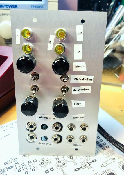

PostPosted: Sun Dec 08, 2019 12:30 pm    Post subject: Reply with quote  Mark this post and the followings unread
Hey there, I've built this same thing but using Arduino Pro Mini clones.
Using arduino, easy to get control of delay, gate length (controllable via pot or CV) as well as switches to ignore gate-off or not. Pretty low parts count.
https://audiodiwhy.blogspot.com/2019/12/gate-delay-part-iii-works.html
