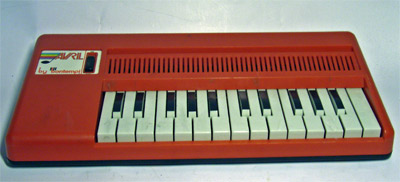

my project is this:
i will use this bontempi air pump keybord as a case , a keyboard and as a new voice going thru the sound lab. i mean: i will add a mic in inside the keyboard for capture his very noisy sound, i will amplify this signal and add a pot in the mixer section.so i can put the vintage sound of this bontempi thru vca and vcf.in the same time the keyboard will give a CV and A gate control and drive my SL.
I want just two octaves (=2volts) so i must use a +/-12V or i can use a +/-9V instead?
can i use this ?

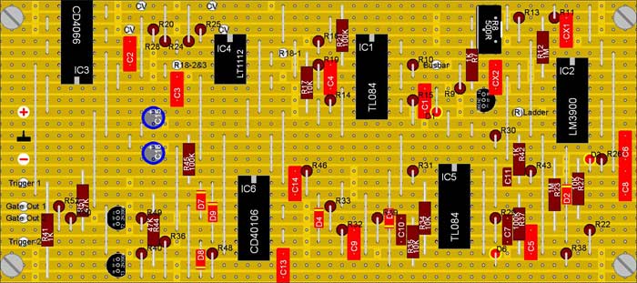

I have started the layout for the single bus CV stripboard.
It's quite big, and I'll need to double check it, so I estimate Thurs or Friday.
See ya,
Andrew
PostPosted: Thu Oct 27, 2005 7:04 am    Post subject: Reply with quote  Mark this post and the followings unread
Here it is.
I've double checked it but I haven't built it yet, (I will soon)
Same designators as Ray's schematic. Watch IC3: -It's the only one upside down. There are 52 links, check them. Any questions, you know where to find me Wink
Have fun.
Andrew

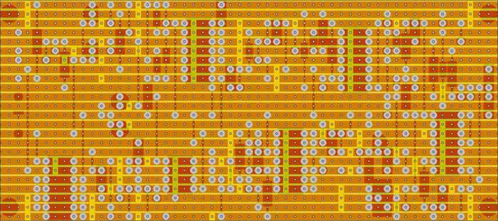

Here's the copper side cutting guide.
 Filesize:  50.98 KB
 Viewed:  59447 Time(s)

Wow, thats nice Smile What software do you use?

Thanks,
It's called Lochmaster. It's by a German company, Abacom: -
http://www.abacom-online.de/default.html
I've got version 2.0
There's a version 3 now which uses much more realistic pics of components.
I'm going to start building that board in the next few days. I'll let you know how it goes.

Just a quick post to let everyone know that this stripboard layout for the single bus to CV+Gate board works perfectly. I hooked mine up tonight for the first time and now the old Baleani organ is starting to sound like a (slightly out of tune) SH101. I haven't adjusted my 1V/Oct pots yet so it's pretty damn good just straight off the bench. Very Happy

there are a couple of things not realy clear in the picture mostly becouse its not realy high resolution, i mistook R15 for R16 and for the diodes that are standing up i had to look up in the schematic witch way they went...
for the rest, superb work, thanx a lot for the design!
PostPosted: Sun Dec 17, 2006 2:26 pm    Post subject: Reply with quote  Mark this post and the followings unread
If you'd like a higher res pic, just PM me. Any other questions, don't hesitate to ask. Smile

PostPosted: Tue Dec 19, 2006 12:49 pm    Post subject: Reply with quote  Mark this post and the followings unread
thanks a lot for the high res pic!
its very helpful.
maybe you could host it somewhere and post a link here, it might help other people too
