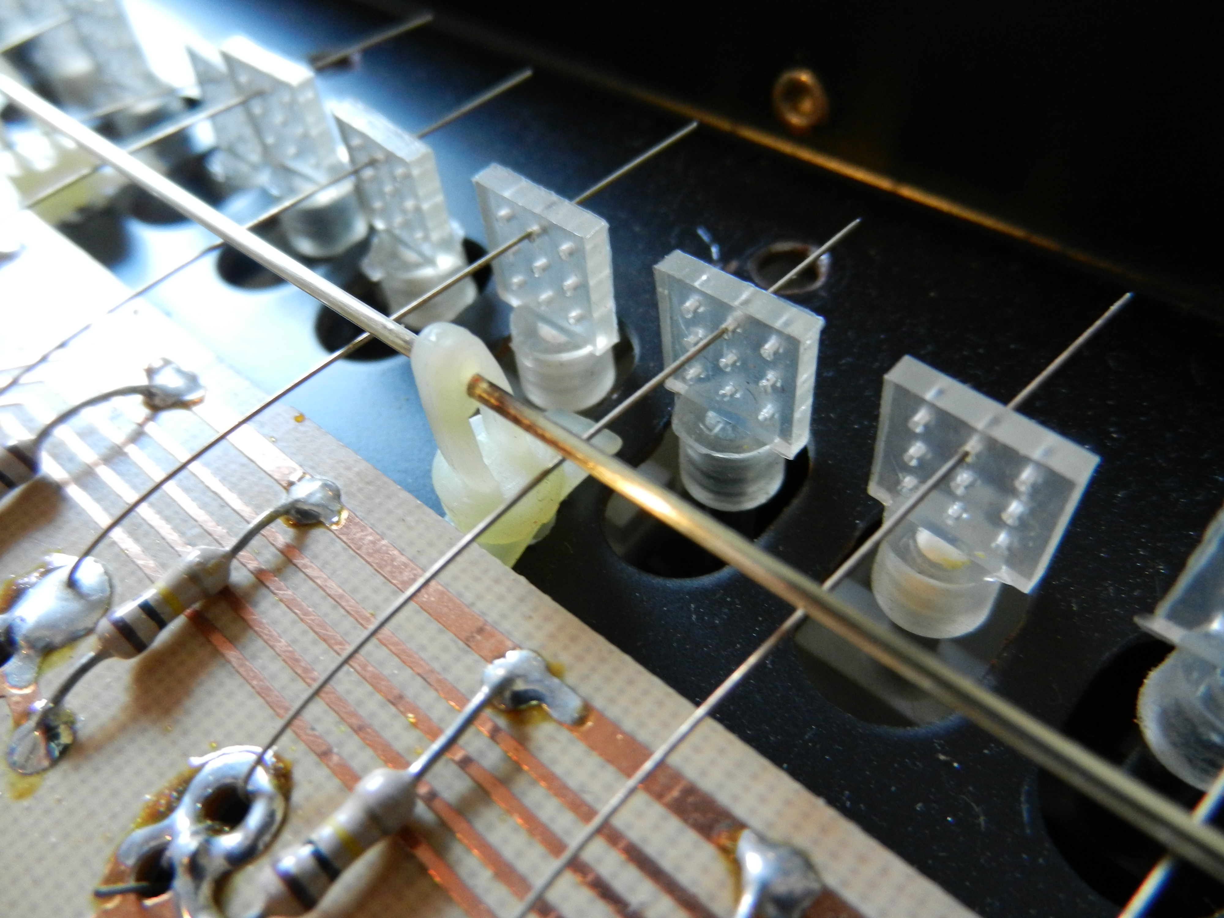

PostPosted: Mon Jun 13, 2011 8:30 am    Post subject: Reply with quote  Mark this post and the followings unread
One thing though - my Kitten has only one wire per key for connection with the bar. (see pic) Worked perfectly well for 25 years!
Inside of Octave-Plateau Kitten II Synthesizer showing keyboard contacts.

After a little research it seems I have the Kitten II - an updated version circa 1982 with modified boards etc... This is why it has just one bar and one wire per key... I have found by plugging in a jack lead into the EXTERNAL CV/GATE IN and touching the end of the lead I can trigger the Kitten - though of course still not the pitch.
I have checked continuity on as many of the traces as I can and it all seems fine. I have cleaned the bar and the wires and checked the multipin lead that connects the keyboard to the PCB and all is well... Touching the keys gives the same affect as touching the end of the jack in the Ext. CV/Gate i.e. triggers the ADSR but no pitch change.
One thing is this: The Keyboard Control switch on the VCO panel seems a little stiff and almost feels like it has three positions instead of the two it should have. The "new" central position for the switch changes the pitch but still the keyboard itself will not control it. Is it worth me removing/replacing this switch?
Any advice would be very welcome.
