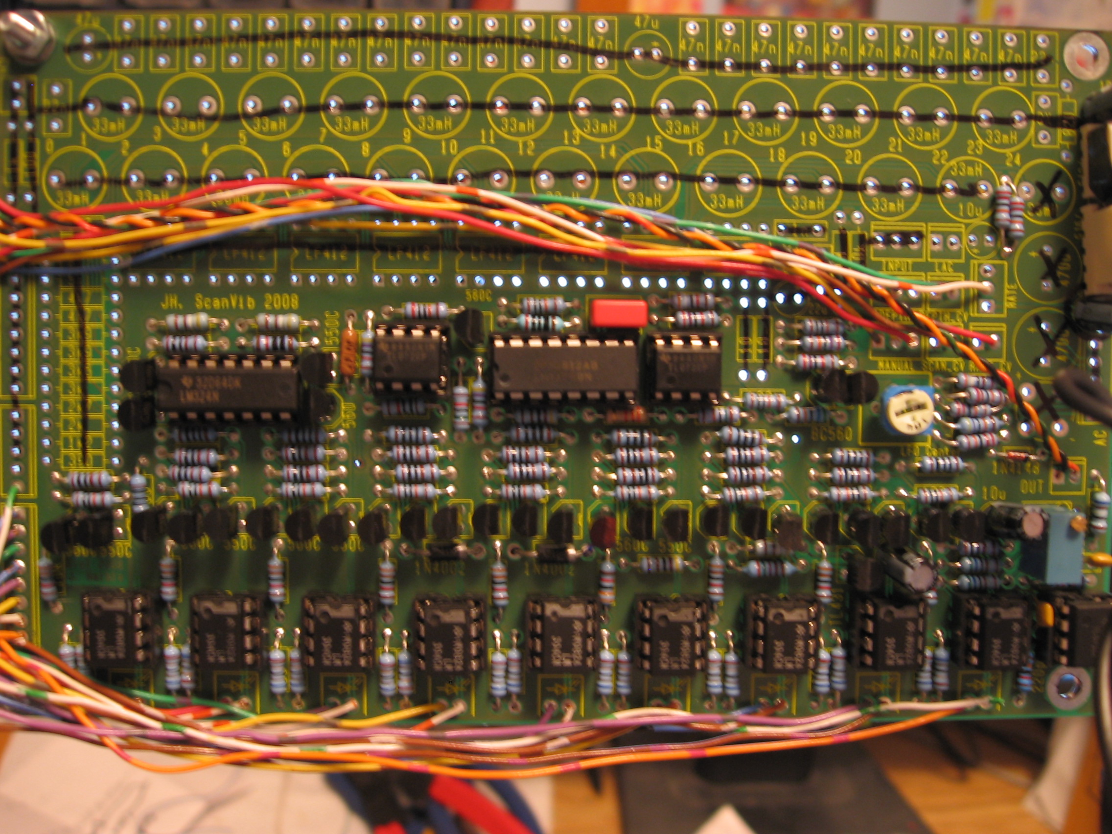

PostPosted: Mon Nov 09, 2009 5:31 pm    Post subject: Reply with quote  Mark this post and the followings unread
Hi Jurgen. I recently finished my interpolating scanner/function generator version and I'm trying to figure out how to fix it. When I turn the scan pot the first LED lights up slightly, then the second, dimmer than the first, then the third, very dim. For the rest of the rotation all the LEDs are dark. When I insert audio into the inputs, it sounds just like you would expect from looking at the LEDs.
I've tried changing all the chips and checked to make sure I read .6-.7v across both junctions of all the transistors when measured with a diode checker. I also measured the output of U13 on pin 1 while I sweep the scan pot. It goes from -4v to 2.7v. I applied an external DC10v and swept the manual pot again and measured 2.1v to 3.5v, but it didn't make any of the LED's light up.
Any idea what's wrong? Also, I noticed that LEDs are an integral part of the circuit and you specified 2mA LEDs and I'm not sure exactly what that means. I used these LED's here:
http://www.futurlec.com/LED/LED5G.shtml
I've also attached a picture of the board. Before anyone asks, there are two places where I had to solder 2 resistors in parallel to get the correct value.

PostPosted: Mon Nov 09, 2009 11:37 pm    Post subject: Reply with quote  Mark this post and the followings unread
2mA LEDs just means that for the LEDs to light up enough that you see them, they should be of that "low current" (2mA) type. If you's use 10mA or 20mA LEDs, the circuit would still work, but yo'd ony see the LEDs shining in a dark room.
So, the LEDs could not be a problem, except when they are defective (open circuit) or soldered in backwards.
As long as you cannot move the LED dot across all 9 channels, it's useless to check further with audio.
There's a lot of npn (BC550) and pnp (BC560) transistors - any chance that you mixed one up somewhere?
JH.

PostPosted: Tue Nov 10, 2009 3:42 pm    Post subject: Reply with quote  Mark this post and the followings unread
Thanks Jurgen.
jhaible wrote:
iThere's a lot of npn (BC550) and pnp (BC560) transistors - any chance that you mixed one up somewhere?
Unfortunately not. I just triple checked.
Do the voltages I read sound normal, meaning that the problem would be somewhere in the VCA's rather than the control section?

PostPosted: Tue Nov 24, 2009 2:35 am    Post subject: Reply with quote  Mark this post and the followings unread
Ok, I found the problem. You were very close. I had a BC560 in place of the TL431 regulator. I didn't read the TL431 text on the board and just put BC560's in any transistor holes that weren't marked for BC550's doh
Now it's working perfectly Very Happy There are so many uses for this module, I wish I had three.
Glad it works now!
I already felt a bit guilty for not providing much help here ... but my PSpice is still down Sad
No problem in selling you two more boards. Smile
JH.
