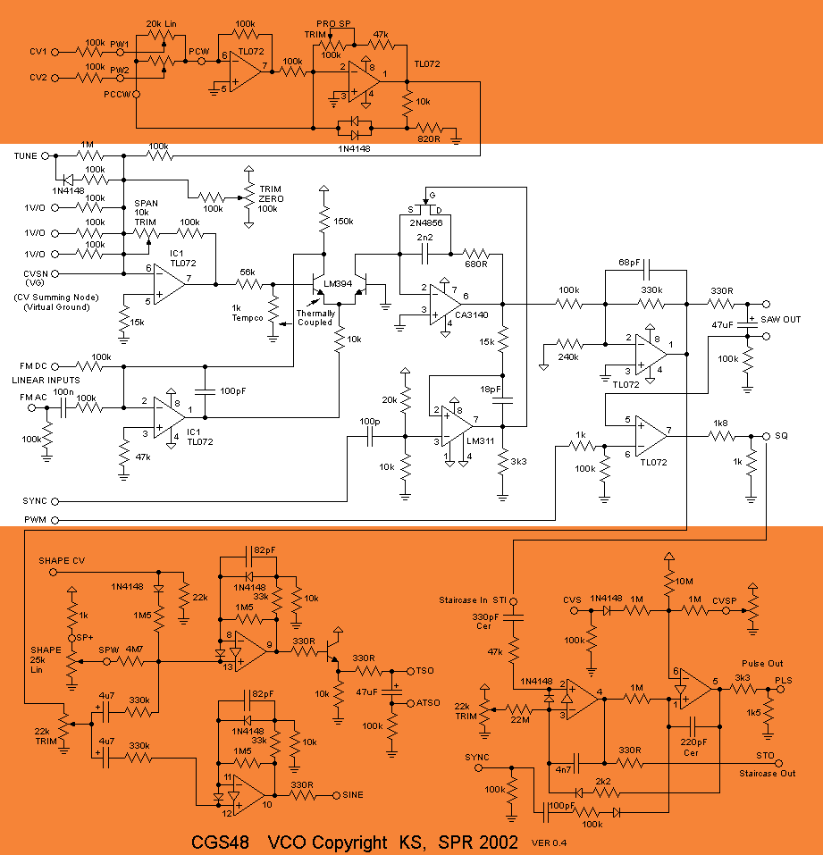

*IF* that fails I'd love some pointers on how to do a stripped build of your VCO - that would certainly come in handy.
That would be Richard Brewster's version -
http://pugix.com/synth/cgs-vco-project/

Hey - check out the CA3080 cookbook from Thomas Henry (available from Magic Smoke, I think?) - the VCO design is basically the standard utility LFO design but with an OTA replacing the manual speed control. You could, of course, make a double using an LM13700.
Actually the THVCO1 is this sort of design:
http://mypeoplepc.com/members/scottnoanh/birthofasynth/id33.html
...though it uses a discreet transistor based comparator section (opamp in the standard utility LFO design)

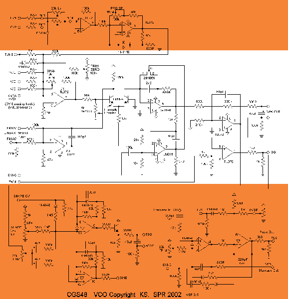

zthee
Joined: Feb 20, 2008
Posts: 414
Location: Stockholm
PostPosted: Tue Apr 07, 2009 1:02 pm    Post subject: Reply with quote  Mark this post and the followings unread
wetterberg wrote:
andrewF wrote:
cheers. hmmm. I've been over there before... I wish there were a less techy approach, though. CGS-as-seen-from-the-noob, as it were. I guess that'll have to be me Wink
Just skip the orange parts and you got a simple VCO Smile
Though the to part might be fun to have.. Since you can invert the gain of incomming CV banana
