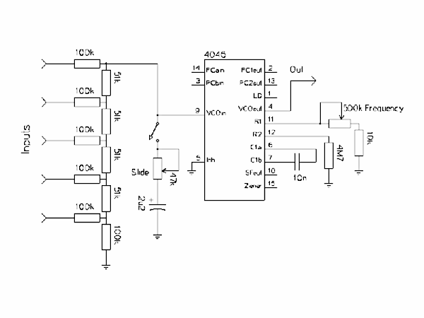

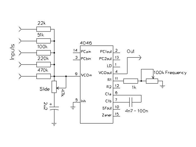

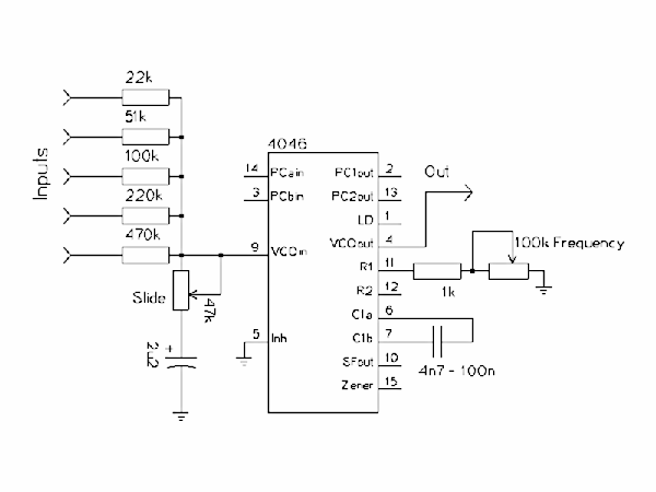

Here's a schematic and a couple of sound clips for a simple CD4046 based VCO.
Just feed its inputs with signals and depending on which inputs are high or low it plays a different pitch, if I've got it right it should play 32 different pitches. The resistors should really be scaled so each one is twice the size of the previous one ie:- 25k, 50k, 100k, 200k, 400k but I figured the values I had were close enough for a Lunetta. You could also use an R-2R ladder instead, but that uses more components. You can add more inputs to give a greater number of notes.
The overall range of the pitches is set by the frequency pot and the value of the capacitor between pins 6 and 7. The slide pot adds glide or portamento to the notes.
Pin 5 can be used to add modulation, I haven't experimented with the other pins yet.
In the sound clips it's being driven by a bunch of outputs from a shift register.
Enjoy Smile

Pehr
Joined: Aug 14, 2005
Posts: 1307
Location: Björkvik, Sweden
PostPosted: Sun Apr 12, 2009 8:14 am    Post subject: Reply with quote  Mark this post and the followings unread
nice one. I'm actually planning to some PLLs in my lunetta core, but haventä figured out how.
The idea with R2R-ladder network is a good idea, I think I'll try that one.
I will also make pure PLL-modules so one can use the frequency tracking aswell http://www.doepfer.de/A196.htm
btw, what is the range of this VCO?

slacker
Joined: Nov 18, 2007
Posts: 301
PostPosted: Sun Apr 12, 2009 9:50 am    Post subject: Reply with quote  Mark this post and the followings unread
At the minute with a 47n cap between pins 6 and 7 it goes from a few Hz to about 3.5Khz. I'm still experimenting with values to get the most useful range.
Playing with it again the slide pot probably needs a switch to disconnect it when you don't want portamento. Even a 1 meg pot still gives a bit of slide on low notes.
I think you're right an R-2R ladder will probably be better, especially if you made it so it could be used on its own for other things. I just threw it together like this on the breadboard to see if it worked.
Thanks for posting that Doepfer thing, it looks pretty interesting.
I've tried some other PLL ideas to do pitch tracking, that might be useful to you. Basically just based on the Wasp glide circuit and Scott Gravenhorst's PLL frequency mulitplier.

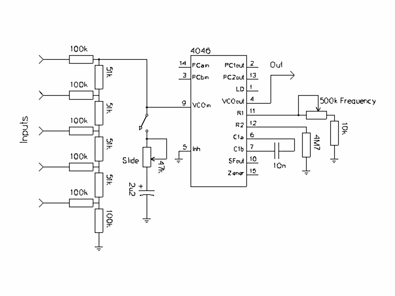

PostPosted: Sun Apr 12, 2009 2:21 pm    Post subject: Reply with quote  Mark this post and the followings unread
Here's a slightly better version using an R-2R ladder on the inputs. The changes in component values and the added resistor off pin 12 means it now goes from just below audio up to about 16Khz.
When I build it I'll probably patch out the resistor ladder so I can use it for other things. That will hopefully also mean it should be possible to add a switchable resistor or pot from pin 9 to pins 2 or 13 to use it for frequency tracking like Pehr mentioned.
Yes, I had that thought about a separate ladder aswell, since I prob want to use it as an output stage too.
Also, I think you need a 7-bit ladder for chromatic scale. But I'm not sure since it is a linear VCO.
Then it becomes some kind of DCO! just connect a binary counter to all the inputs and it will ramp Very Happy or random clocks to make weird sequences...

slacker
Posts: 301
PostPosted: Mon Apr 13, 2009 12:53 pm    Post subject: Reply with quote  Mark this post and the followings unread
I'm not sure either, I'll try hooking it up to a tuner and see what sort of intervals I'm getting between pitches. I don't expect it to be in tune but it would be interesting to see roughly how many octaves it's got and how they are spilt.
I'll probably play around with different size ladders. I went with 5-bit because I thought it would give the opportunity for a lot more variation than 4-bit. That, plus the fact I ran out of crocodile leads to hook it up.
Like this you mean Very Happy
