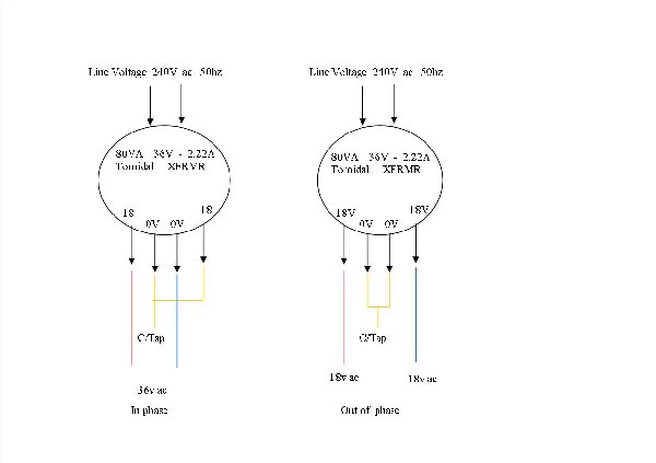

Hi, I have a few of these power supply boards. They specify a centre tapped transformer, but would they work using dual 15v secondary windings with both neutral wires together as the centre tap?

Yeah, that's fine Joe.
Just make sure you wire the outputs in phase.
For example,
There'll be 4 output wires, and the side of the transformer will show them as White/Orange/Yellow/Blue - 15-0-15-0
In this case you need to use the Orange/Yellow together as the centre tap. (or the White/Blue) but not the Orange/Blue. Does that make sense?
Get it checked by an electrician if you have any doubts at all.
Also keep in mind that that particular transformer won't deliver 1Amp per rail. It's rated at about 800mA in series, so I wouldn't push it past 500mA (per rail)

I'm interested in what problems would ouccur if the secondarys were wired out of phase, has anyone wired a toroidal like that and found exessive hum or very hot regulators or even a potential voltage difference to mains earth from the center tap ????.

Joe, The model 62063 that you have chosen is 2X15V, but it should give 2X18 in order to supply if needed +/-15V.
LM317 data says 3V ≤ (VIN − VOUT) ≤ 40V.
So it should be better the model 62064.
Uncle, I think that the secondary should be configured OUT of phase. http://en.wikipedia.org/wiki/Centre_tap
Volts center tapped (VCT) describes the voltage output of a center tapped transformer. For example: A 24 VCT transformer will measure 24 VAC across the outer two taps (winding as a whole), and 12VAC from each outer tap to the center-tap (half winding). These two 12 VAC supplies are 180 degrees out of phase with each other, thus making it easy to derive positive and negative 12 volt DC power supplies from them.
According its schematics is red and brown together as a centre tap.

Yeah, Sound, schematically that's what I meant. I just thought that would be called in phase. Most transformers have a pic on the side which says something like "15-0/15-0". So for a positive excursion on the primary, the second "0" is -15 with respect to the second 15, so by connecting the middle "0-15" together, you create a +15,0,-15 arrangement. (or something like that)

Aha, I think that the key is in the link of Benuron, where is explained that is possible connect two secondary in parallel or series and in phase or out of phase. So as I understood the correct name for the configuration needed in bipolar or split supplies is in series and out of phase.
Out of phase assure that the positive and negative rails always receive current, now by one secondary, after by the other depending on the phase.

Ciao Benuron, I think that it is not the reason. Also you can tap the ground in a 'Series/in phase' configuration. I think the reason is that the Series/out of phase configuration has best performance.
As I understand in the Eliot site http://sound.westhost.com/xfmr2.htm#8.series-parallel there are four ways of configure two secondaries:
Series/in phase,
Series/out of phase,
Parallel/in phase and
Parallel/out of phase*
*This last configuration -parallel/out of phase- must be avoided since will destroy the transformer -or in the best case the fuse- Actually is like short a "Series/out of phase" configuration.
For "bipolar supplies" or "split supplies" (+V,-V, 0) we are interested in the series configuration, in order to tap the ground within the two secundaries.
As you can see in the pictures attached the "Series/out of phase" configuration is the one with best performance. I took these pictures measuring after the ring diode, red for the +V output, yellow for the-V output. As you can see it will provide the current more spread to the rails +V and -V. It will make easier the job of the filter capacitor, I think.
Picture 1 corresponds at configuration Series/out of phase.
Picture 2 corresponds at configuration Series/in phase.
