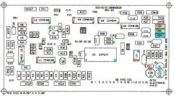

I've solved the problem with my build; it was the power supply traces.
The postive supply feeds over the digital board with traces on the top and the bottom of the board. On checking more rigorously than I'd done previously, I found that whereas the components fed from the traces on the bottom were fine, the components fed from the tracks on the top were only getting 5V (I'm using a +/-15V supply).
Turns out there was a defect with the top trace at one point so that barely any power was getting through.
Solution - I carefully sanded off the solder mask at the offfending point and added a solder bridge.
Now works perfectly!
May be worth checking, o-w1, in case there was a bad batch of boards.

Unfortunately I cannot seem to find a voltage drop. Could you please let me know what components have a faulty power supply?
Thanks so much!
jaidee
Joined: Oct 28, 2007
Posts: 44
Location: Newcastle upon Tyne, UK
PostPosted: Fri Nov 12, 2010 6:06 pm    Post subject: Reply with quote  Mark this post and the followings unread
Sorry - it's taken me a while to get back on this.
I've marked on the component layout diagram the parts which are directly connected to the power lines. Tracing back to the poisitve line, the first component connected is the left side of R28. I found that the positive voltage at this component and at all of the relevant pins of the ICs was only about 5V (I am using a 15V supply).
As previously mentioned, on closer insprection I found that there part of the t6race close to the connector was far thinner than it should have been and was in effect acting as a resistor.
Hope this helps!
