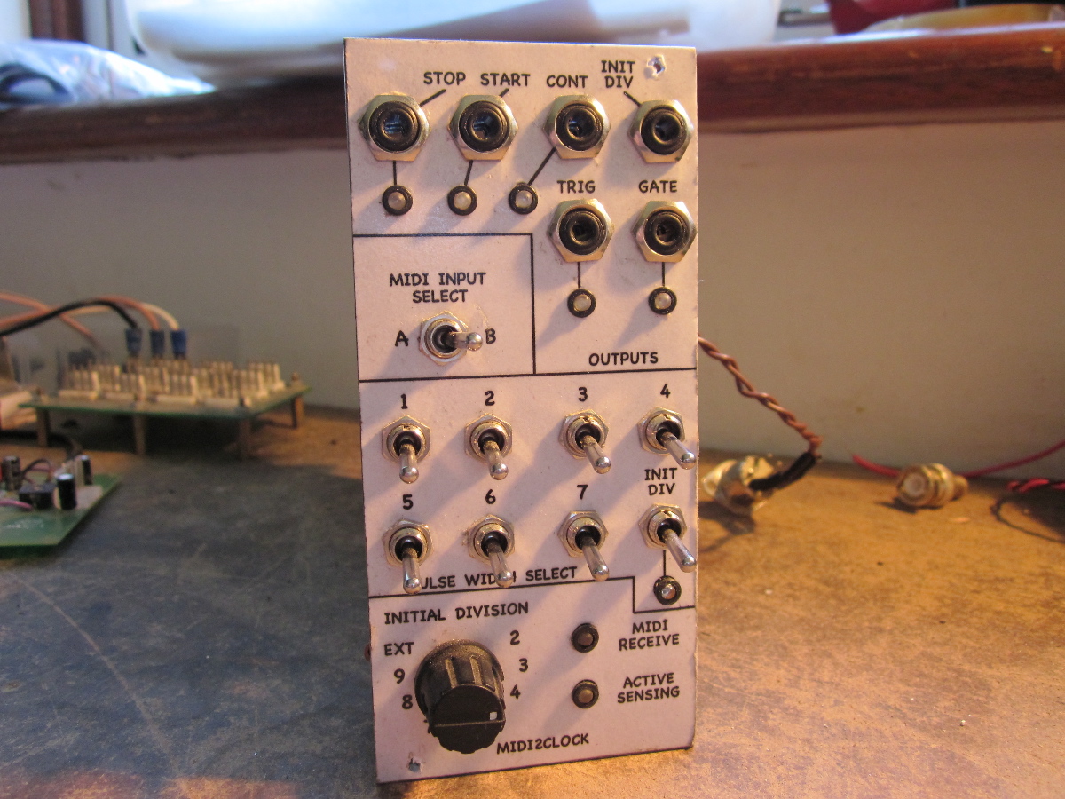

Hi guys
Thought you all might like to see a circuit I've been working on for a few years.....
Last year, Fonik and I teamed up and turned the perfboard builds into a couple of PCBs. Matthias did his usual beautiful work on the layout, and helped a lot in the final design stages - cheers mate! Wink
The MIDI2CLOCK (M2C) takes a MIDI input, and outputs 24PPQN CLOCKS, START, CONTINUE and STOP pulses. These can be +5V or +10v by installing links or pairs of resistors. There is also an onboard 2-stage divider network with GATE and TRIGGER outputs, that allows different time signatures, pulse divisions and pulse widths to be set up, using just a rotary switch and 8 SPST changeover toggle switches. No menus or LCDs, or any of that malarkey.
It handles MIDI clocks, not MTC (midi timecode) - MTC is a completely different beastie....
The circuit has been tested operating from 1 BPM to 250 BPM, and will track tempo changes smoothly. The gate length is proportional to the tempo, so slower tempi give longer gate lengths.
There are LED indicators for the various outputs, and a MIDI receive LED that lights when any MIDI signal is present at the circuit's MIDI input.
As well as that, there is a pin-header on the PCB that carries decoded MIDI as CMOS-compatible 8-bit parallel +5V logic, along with other useful internal circuit signals. Other pin-headers on the board allow for expansion to further circuits, eg, more divider stages, or remotely controlling the action of the switches. They could even be used to decode other types of MIDI messages with extra circuits , but that is for the truly adventurous Smile
There are pin headers too for the transmit section of the main processor (CV to MIDI). It is not used in the basic design, but is there for those who wish to experiment with it. Additional circuitry will need to be added in order to use this function.
There are no programmable ICs used, and no calibration is needed, so it can be simply soldered up and is then ready to go. All components used are in current production as of may 2nd 2011, with only one slightly unusual IC, which is still being manufactured, and is stocked by Digikey, Debco.com, Jameco, Farnell and others.
12HP euro format. Yes there *is* a reason why all the jacks are at the top......

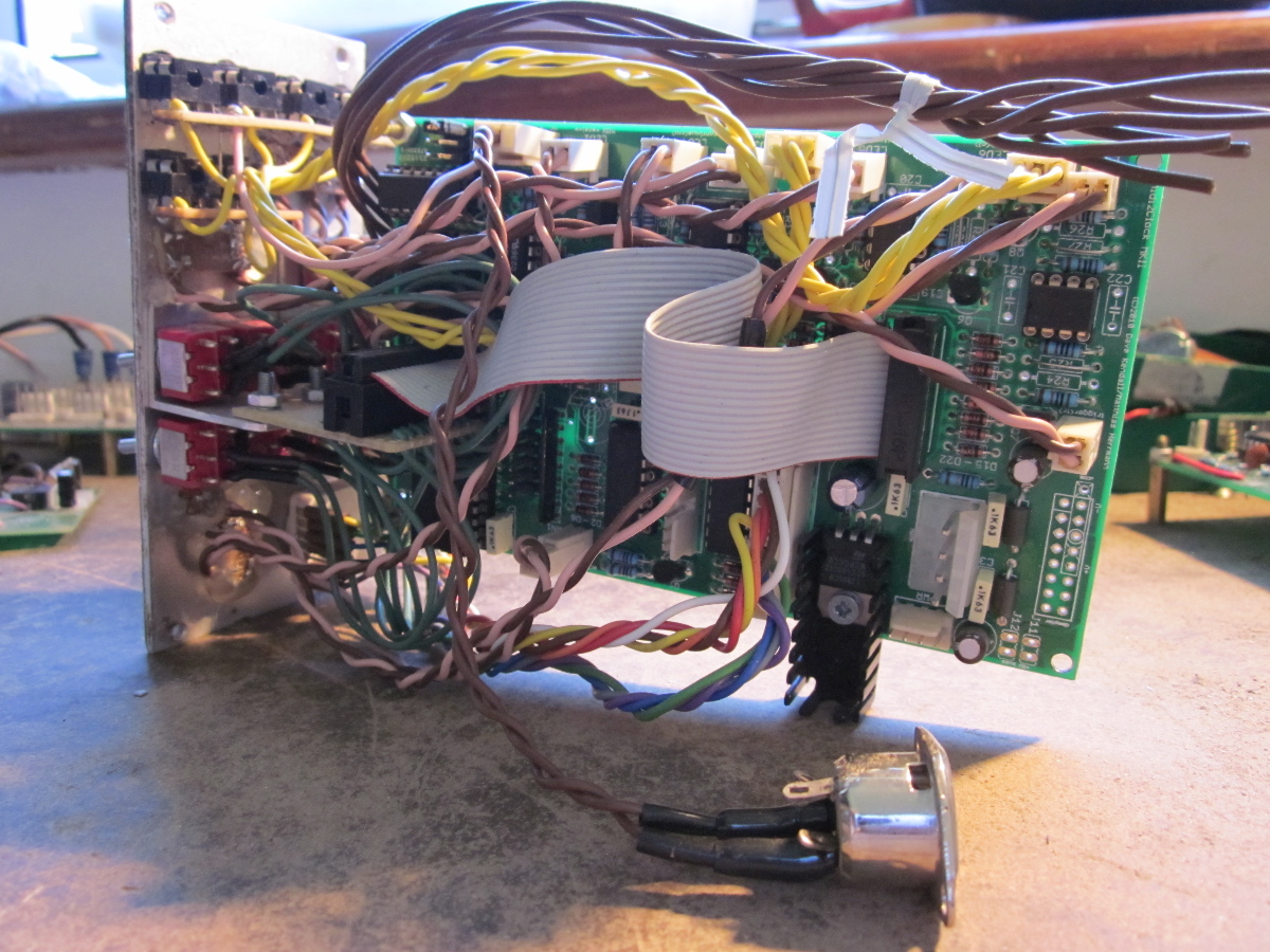

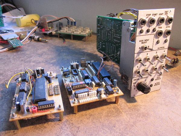

PostPosted: Tue May 03, 2011 8:19 am    Post subject: a couple more pics... Reply with quote  Mark this post and the followings unread
Top one show how cramped the module is in euro....
The bottom one shows the MK1 and MK2 prototypes on perfboard.

Hi all.
Bit of a long post, but I'll try to explain how the M2C works. It may seem complicated, but when you actually use it, it's dead simple.
Diablojoy - I guess if a PCB run happens, the schematics will be released at the end of the first run, along with a BOM and build/user notes. I'm working on the latter at the moment, though it will take a while due to work pressure.
Tommi - Yes, the two stages divide down from the initial 24PPQN that MIDI clocks arrive in. The initial division divides this down into a more usable number. Let's say it's set to divide by 3. That then gives you 8 PPQN, or 32 beats in a 4-beat bar. With the INIT DIV toggle on, that is what would come out of the GATE and TRIGGER jacks. (The trigger is just a narrow pulse, the gate is variable length)
The second divider stage sets the division *and* pulse width from the GATE out jack, and is controlled by the toggles. It is indeed a gate sequencer, although I originally thought of it as an 8-input OR gate.
For setting pulse widths and divisions, lets set the INITIAL DIVISION to 3.
With Toggles 1,3,5 and 7 ON, you would get 16 beats to the bar from the GATE and TRIGGER out jacks. With 1 and 5 ON, you get 8 beats and so on.
With only toggle 1 ON, you get 4 beats to the bar. If toggle 2 is also ON, the pulse length doubles. With the first 7 toggles ON, you get 4 beats to the bar, but with a pulse length that is *nearly* the whole length of a beat. This is a function of the circuit design, but I think it is a good thing, as, if you trigger an envelope from the GATE out, the gate goes low quickly at the end of the beat, and the envelope is re-triggered at the start of the next beat.
With the INITIAL DIVISION set to divide by 6, you get the same behaviour as above, but the maximum number of beats is now 16, and at the slowest setting (only toggle 1 ON) you get just 2 beats to the bar in 4/4.
If the INITIAL DIVISION is set to divide by 4 or 8, you get a 3/4 meter.
You can have a lot of fun by setting random patterns of the toggles - you get odd rhythms with pulses of different lengths. These can be switched ON and OFF while the thing is running, and it won't affect the sync. Switching the initial division while the sequencer is running gives much more unpredictable results. The other odd numbered divisions in the initial divider (divide by 5, 7 etc.) are there just for fun - a simple build could just have divide by 3 or 4.
I did once test a gate-controlled 2nd divider stage on perfboard, where incoming gates switched the stage 2 dividers ON or OFF. This worked in conjunction with the existing toggles, so that any toggle, when OFF, could be controlled with external gates, and the toggle could overide that, making that stage always ON. I think putting the 8 outputs of Ken Stone's CGS13 gated comparator into this add-on board could be fun..... Smile
The M2C could also be fun with a KLEE, with another set of initial and secondary divisions........
The EXT position on the rotary was a position left for expansion, where the INITIAL DIVISION could also be gate selected. I have some ideas on how to achieve this, it wouldn't be too hard. A possible expansion board could combine a 2nd gate controlled secondary stage, possibly a gate controlled initial stage, and DIN SYNC, which should be easy enough to implement.
Finally, Tommi, you're right again - the MIDI input select switches between two physical MIDI inputs. I always try and run MIDI clocks, and definitely MTC, on its own down a separate MIDI cable from NOTE and other information. MIDI protocol will allow MIDI clocks to be sent in the middle of *any* midi messages, including SYS-EX, so in practice, they can end up delaying other information like note-ons, particularly at faster tempi. There are lots of the little buggers flying around, and MIDI still runs at the same baud rate, so there is less room for notes etc. to be transmitted. I totally recommend using a separate cable for MIDI clocks. These days, multi output MIDI interfaces for computers are cheap enough, so dedicating one from the 8 for clocks, helps a lot to tighten things up. Hence, the select switch - I can either feed the M2C from the dedicated clock line, or another line if needed.
A while back, I had some preliminary ideas about how to implement MIDI PGM changes. It may even be possible to use these to set different patterns in the secondary divider stage, but that would be quite difficult, due to the more complex nature of MIDI PGM change messages. NOTE ON and OFFS are *very* complex by comparison, and I would guess that a whole bunch of logic would be needed for them..... still it's possible - all the raw MIDI data and useful signals, like a SYSTEM REAL TIME flag are on the headers....
Hope this has helped a bit to explain. It *is* easy to use when you have it in your hand, and you can just switch away until you have something you like. Smile
I'll try to get a quick audio demo or two up, to show what it can do.
