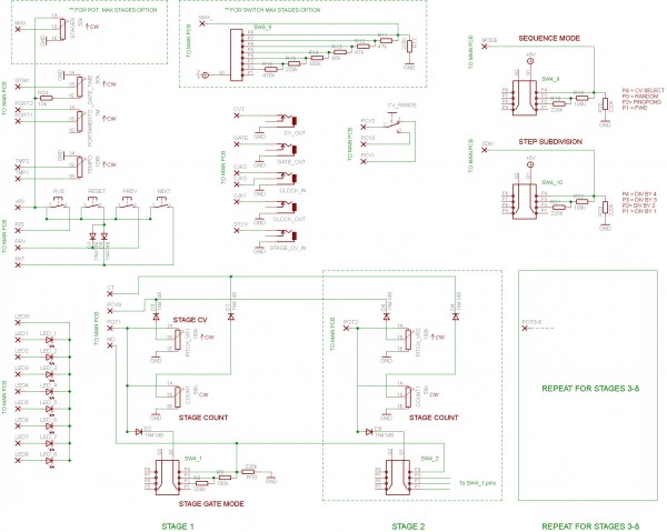

may I confirm, if possible-- the wiring instructions for using pots instead of switches-- these instructiuons are somewhere in the documentation?
I apologize, I can't download the build doc right now.
Hello
Here is an alternate Panel Wiring schematic, featuring
50k Linear pots instead of the 8-way switches.
Should work, let me know how you get on.
-ryk

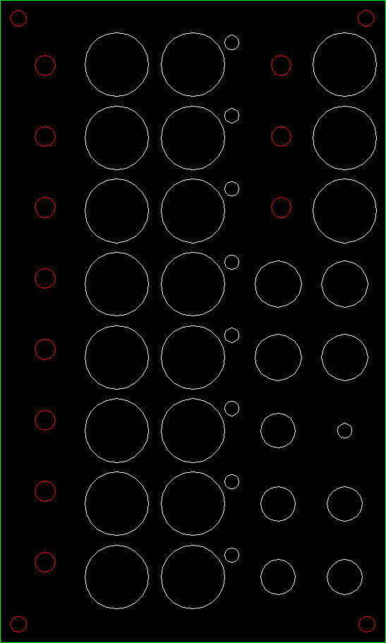

This was as far as i got with rotaries -
(the large white circles are not the knobs, but the space that the switches take up behind the panel)
The panel is still 3u, and uses those cheap 12way rotaries for all switches.
If there was a revival of interest in this project, i would confirm the panel, and cut a few.

Bastian wrote:
...the sliders...take up a lot of space.
Uh...I beg to differ on that. Not when you're trying to pack in 8 of the 4P and 8 of the 8P switches. You actually use up a lot less spce like that than with rotary switches because with the slide switches arranged as Julian has them, you can get the switches pretty close together on the vertical axis. Take a look at Julian's V2.0 With Portamento Mod panel and try eyeballing it. Imagine adding 2 columns of rotaries to the right of the CV knobs. It can be done, but it's not as finger-friendly as with the slider switches.
I haven't found any 8P mini rotary switches that I can afford (plus I hate how the mini rotaries have tiny shafts that pretty much limit you to using the knobs that come with them...doesnt' fit my designs at all), and the less expensive rotaries have nearly 1" bodies. With 5U modules being about 8.75" high, that doesn't leave a lot of wiggle room behind the panel.
But keep in mind that these can be built with pots rather than switches. So both slider pots and rotary pots are viable options.

This panel -
..was laid out to be able to use these (cheap, widely availible) switches -
Like i say, i have not tested the panel yet, and i last worked on it, probably, over a year ago (!) but i think it should work, and i dont think it will really be much more cluttered than the slide switch version (remember, the large white cicles are *not* knobs, but the area the body of the switch takes up behind the panel)
For custom cnc engraved panels see - http://www.thebeast.co.uk/cnc/

....i guess what i am trying to say is that, whilst i (and many others) recieved the slide switches from Ryk, i do not think that the lack of availibilty of them now should kill this project.
Indeed, if i were to start over, i may even opt for using rotaries, rather than slide, simply due to their availibility. Again, i always try and stay away from 'rare' parts, so that i know things are repairable in the future, when they go wrong. For me, the use of a comonly availible part in a design is much more desirable than a rare one.
