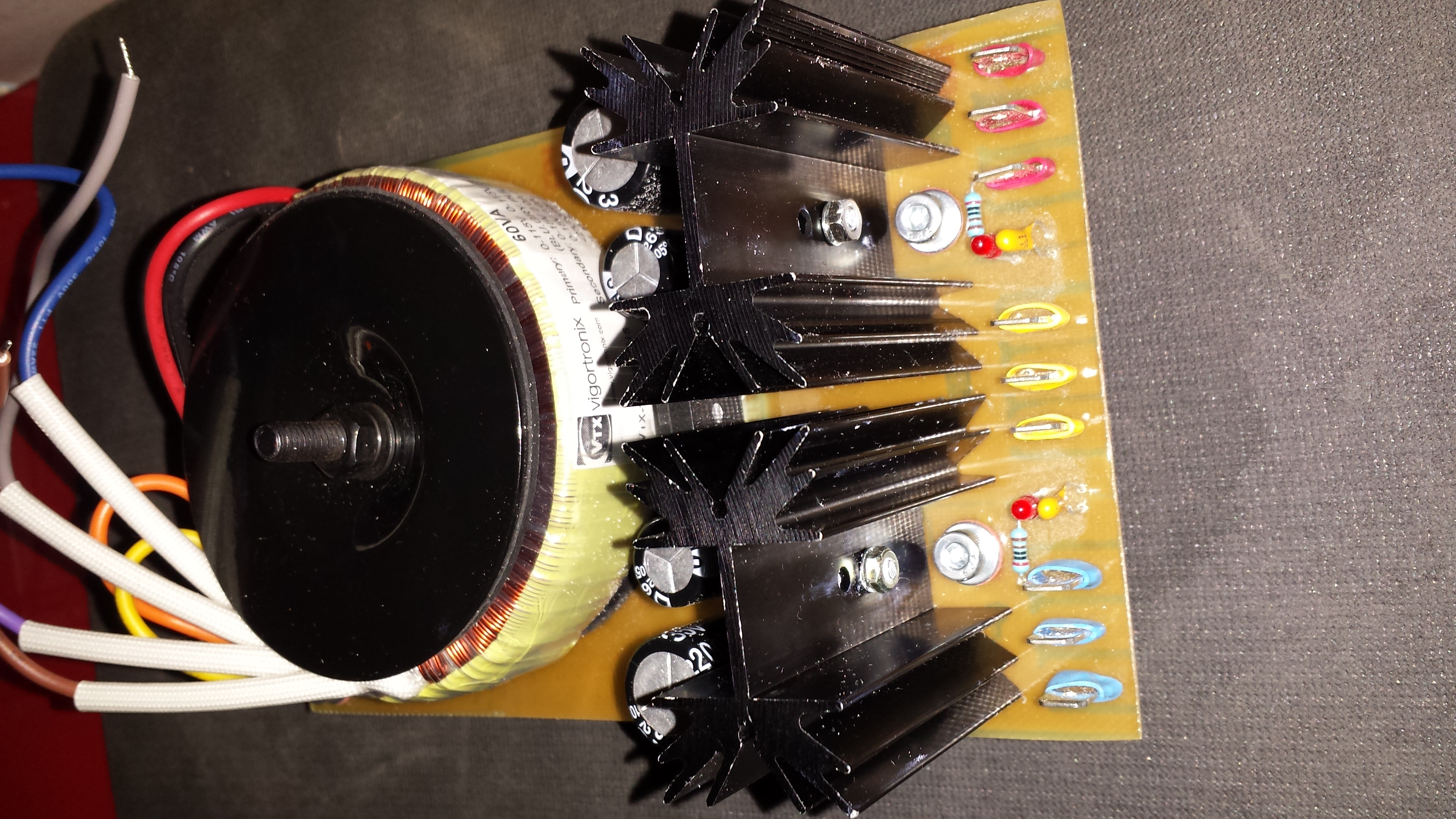

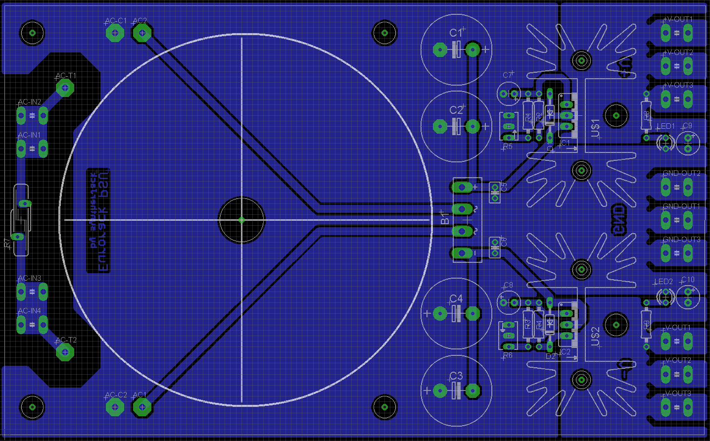

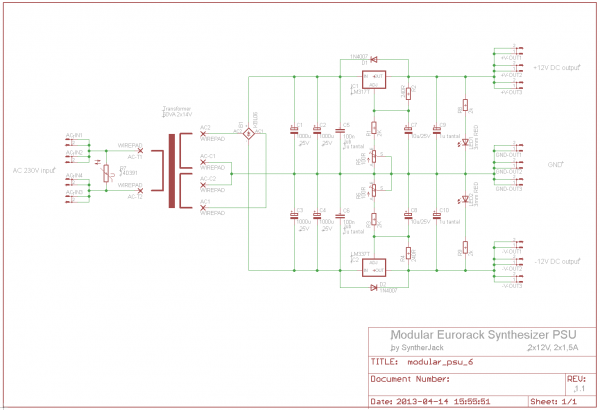

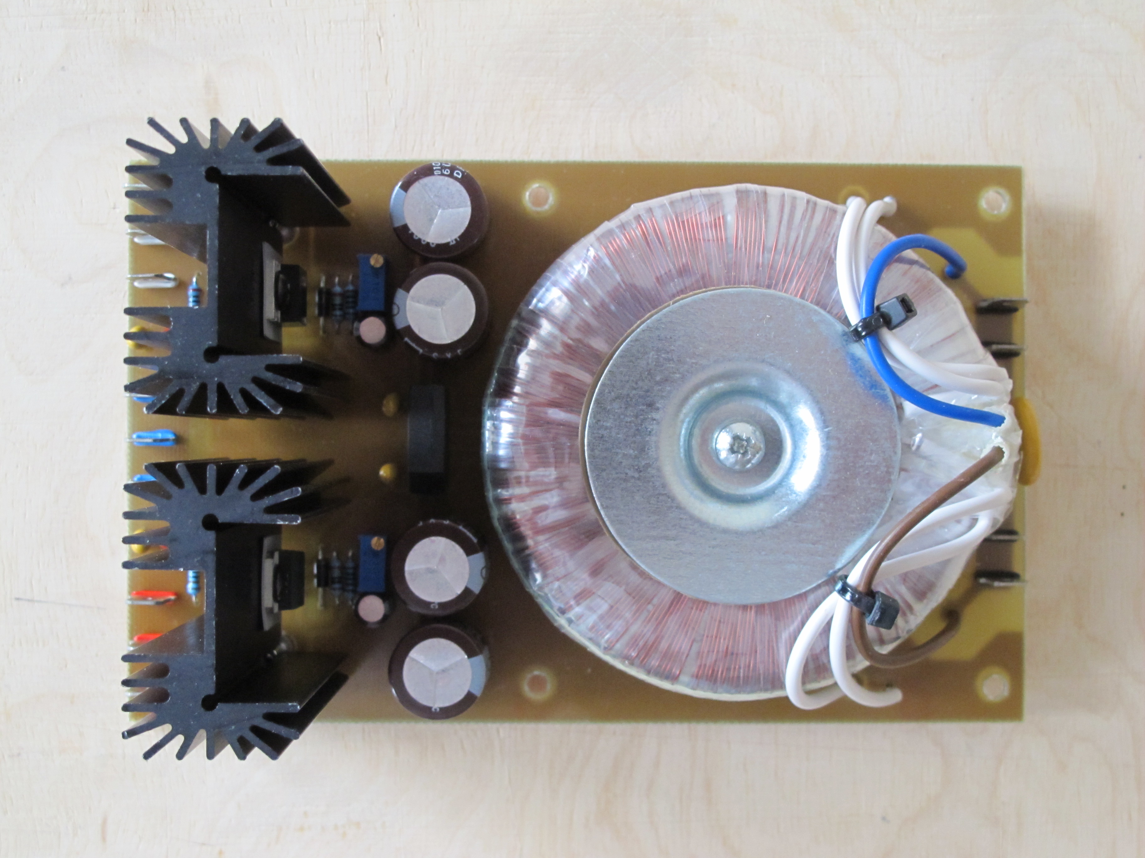

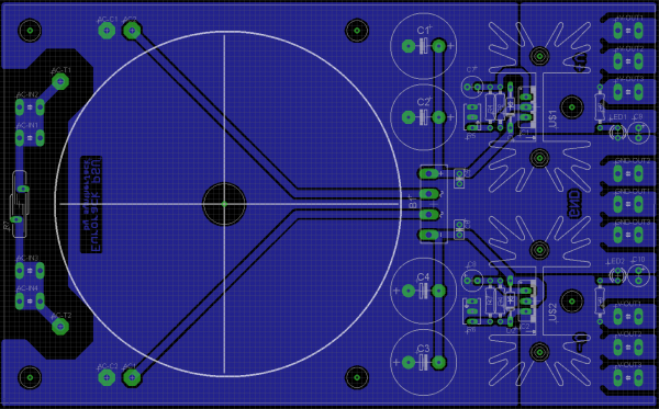

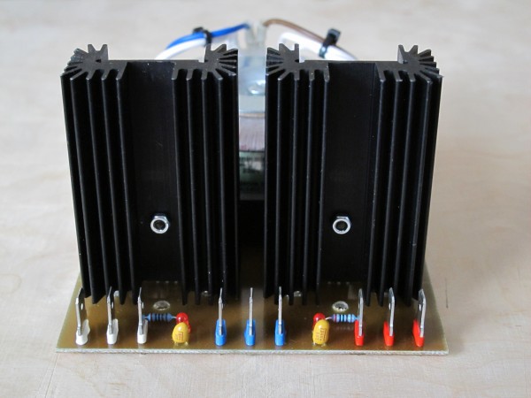

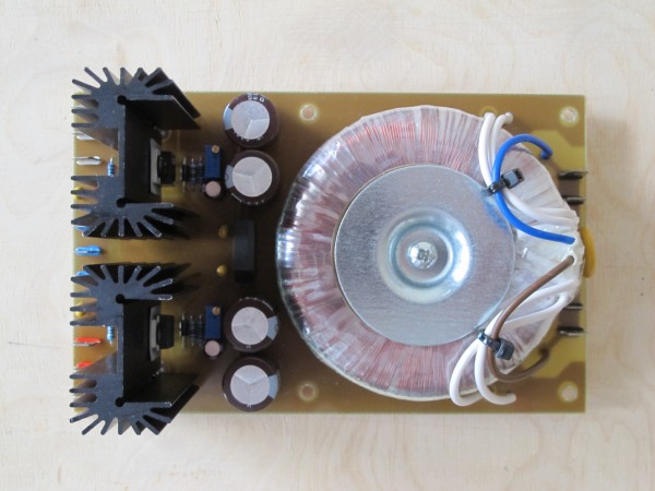

Hello,
I'm working on my big and fat modular drum synth. As first, I completed PSU - it is designed for euro standard (+/- 12V). Below you can find:
- full schematics,
- PCB for easy DIY cloning,
- BOM,
- some pictures.
PSU in based on Doepfers Modular PSU, but has few little upgrades:
- it uses more popular, cheap heat-sinks,
- better quality capacitors,
- protection diodes,
- changed connector spacing for easy operation,
- 2x1,5A output @ 12V (tested).
The PCB is 160x100mm (standard EURO card), one sided.
Total cost cost about 25 euro (when you do PCB on your own).
Happy DIYing!
Completed PSU, output connectors.

One question though: Is there any specific reason for the tantalum caps? Are they just for decoupling the LEDs? I'd like to avoid tantalum because apparently they tend to short circuit in some cases.
syntherjack
Joined: Oct 29, 2012
Posts: 21
Location: Poland, Poznan
PostPosted: Tue Apr 16, 2013 11:46 am    Post subject: Reply with quote  Mark this post and the followings unread
The main reason to use tantalum caps is LM317 datasheet, they're recommeded. Those caps tend to short circuit when thermal and voltage limits are exceeded. I used 25V, 85C caps, so there shouldn't be a problem. If you have bad experiences with tantalum, you can always 100uF parallel with 100nF.

Thanks for this! Would you consider open-sourcing schematics and layout files? It would be easier for me to get a few fabricated then to etch myself.

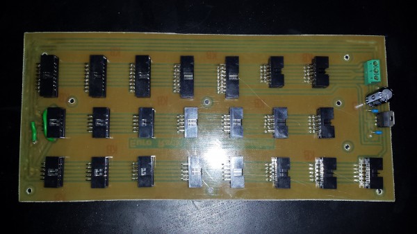

I decided to build this projects too as I have some concerned about wiring up to 230 mains I decided was a better idea to get a friend to check and tested as i am a bit scared of blowing my self up My friend had some concerned on how close the tracks are to the main ground plain also he decided it was thing to build the tracks up with solder too.. and thxs for uploading the info it help a lot

Nice job!
I hope it will work fine for long years!
