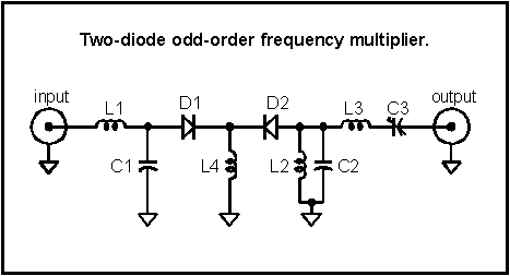

I came across this schematic, I haven't had much experience with inductors before, and I don't have any in my parts stash ATM to breadboard this out but would something like this be useful in a lunetta?
taken from here: http://www.rlocman.ru/shem/shem-cache.html?di=19481

Hi rossics.
This is a radio frequency (RF) circuit, designed to work in the megahertz region (or above, possibly). I know little about RF circuits, but I know that usually there is a problem with converting an RF circuit to an audio frequency circuit. The inductors need to have impossibly high values for practical use. Normally, inductors come in microhenrys or the low millihenrys, but my guess is that much larger values would be required (if it would work at all at audio frequencies).
If I'm wrong, someone will soon post about it Laughing
Gary
