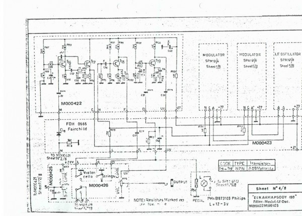

PostPosted: Sat Mar 08, 2014 7:13 am    Post subject: Reply with quote  Mark this post and the followings unread
There is one other thing that I wanted to do with this keyboard that I'm sure will be far easier. I would like to be able to disable the modulation via a switch. I know there are 2 modulation circuits, what would be the best way to do this please? I've attached the overall schematic of the modulation section. Is it a case of grounding the signal somewhere?
Many thanks for any help.

aladan
Joined: Aug 13, 2011
Posts: 52
Location: Australia
PostPosted: Sun Mar 16, 2014 4:37 pm    Post subject: Reply with quote  Mark this post and the followings unread
Sorry for the delay on this response.
I'm really not sure how to give you what you want - I don't completely understand the modulation circuitry. I think all LFO pitch mod is purely done by the BBD circuitry - looks like there's no modulation at the TOG which I would have expected to be much easier to implement. But I'm not completely sure. Maybe try varying the "depth control" trimmer on SPM61-8 (page 5/Cool and see what affect that has? If it does what you want then you could bring it out to a panel switch.
If only I had a 490 of my own I might be able to be more helpful!
A.
