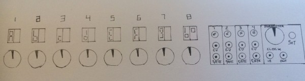

It's pretty rude to read someone's mind without permission. Very Happy
I had the same exact idea for my sequencer. I've got a giant bag of rotary encoders for the project. Any tips on how to multiplex that many encoders? I have ideas but was looking for more.

Code:
// ROTARY ENCODER TEST
int lastForwards[8];
int forwards[8];
int backwards[8];
#define maxRotaries 2
#define A 2
#define B 3
#define C 4 //pins for output to mux#1
#define muxOneIn 5
int counter[8] ; //test variable
int values[8][3] = {
  { 0,0,0 },
  { 1,0,0 },
  { 0,1,0 },
  { 1,1,0 },
  { 0,0,1 },
  { 1,0,1 },
  { 0,1,1 },
  { 1,1,1 }
void setup()
  pinMode(A,OUTPUT);
  pinMode(B,OUTPUT);
  pinMode(C,OUTPUT);
  pinMode(muxOneIn, INPUT_PULLUP);
  Serial.begin(115200);
void loop()
  for(int i = 0 ; i <=maxRotaries; i+=2)
   forwards[i] = getMuxData(i+0);
   backwards[i] = getMuxData(i+1);
  if(!forwards[i] && lastForwards[i])
    if(backwards[i])
      counter[i]++;
          Serial.print(i,DEC);
          Serial.print(" : ");
    Serial.println(counter[i]);
    else
    counter[i]--;
  lastForwards[i] = forwards[i];
  ////TEST 2
int getMuxData(int data)
  digitalWrite(A,values[data][0]);
  digitalWrite(B,values[data][1]);
  digitalWrite(C,values[data][2]);
  int muxValue = digitalRead(muxOneIn);
  return muxValue;
kinda works, might need some tweaking Smile
