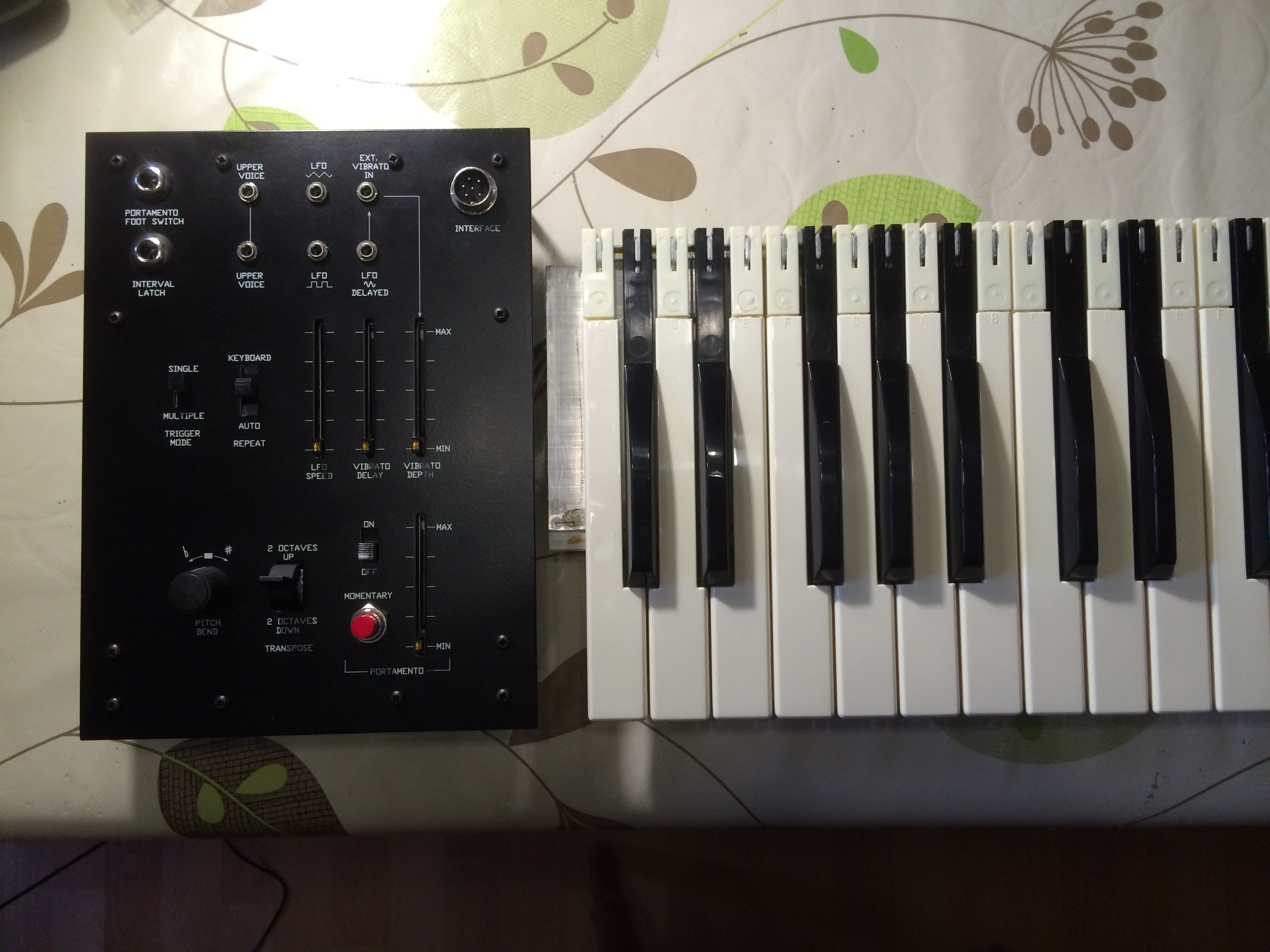

Kipling wrote:
The original front panel design shows an arrow between the two sockets suggesting that they are perhaps linked by the switched contacts of one or both sockets so it feeds back into the external vibrato input if no plugs are inserted in either socket. The service manual does not show any connection between the two on the schematic nor mention it in the text. It's a simple job to connect them if required.
I also presume the Lower Voice Output (CV) goes via the lead to the 2600/TTSH as the main CV output, and the Upper Voice Output goes to both Upper Voice Output sockets on the front panel.
Hi Kipling… Correct on both accounts. The delayed vibrato output goes to the 3.5 socket switch side, and the external vibrato goes back to the CV mix, that will disconnect the delayed vibrato when using an external modulation input.
The upper voice is a separate socket on the panel, and the lower voice is outputted along with Gate & Trigger (and of course the +/-/0v supply), via a 6 core cable to the main console.

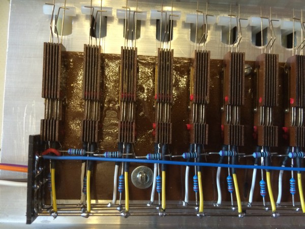

PostPosted: Thu Jun 26, 2014 12:59 pm    Post subject: Reply with quote  Mark this post and the followings unread
Well after ages of PCB tweaking and panel making (by hand apart from the slider slots which I used a router for), not to mention many hours wiring up the very fiddly Kimber Allen keyboard contacts with resulting burnt finger tips, I've finally finished the 3620 clone PCB, lead, panel and keybed, All I need to do now is build and tolex the case for it, and have done the CAD drawings in preparation.
Oh, and finish building the TTSH which has taken a back seat while I build the 3620, so I can plug it in and test/calibrate it.....
It is built to the original ARP circuit (right down to IMF3958 dual J-FETs) and 2N4392 replacements for two of the 2N5459s as per factory change note, on a single PCB to which everything is mounted apart from three sockets. I managed to get some 0.47uF polycarbonate capacitors (Philips MKC344 series) from an ebay member in Poland so hopefully S/H will work fine. I made the PCB compatible with those and the polystyrene brick capacitors I already had from Rush Online.
If I were to start again, I'd get all the ceramic capacitor lead spacing correct (did all of them as 7.5mm instead of 5mm) and the Bourns trimmers which I wrongly thought were on a 0.2 x 0.2" grid. They're 0.2 x 0.1" but thankfully the wiper lead is long enough to bend to reach the pad.
If it all works, and if anyone were interested, I have three spare PCBs so would be open to sensible offers for them (circa £30 each plus postage), and can supply CAD files for the panel, screen printing and case.
Thanks to those who've offered help in getting this far, especially AndyR1960, without whom I'd probably not have started the project.
Will post pics of the finished article ASAP.
