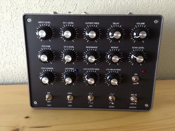

OK, so I was really frustrated with my first build and all the noise and radio station interference I was getting in my echo circuit. After multiple troubleshooting attempts, chip replacements, etc, I decided to just start from scratch.
I built a new one with a new board and all new chips. I am happy to report that there is no external noise or radio interference in my new build. The echo unit can be a bit 'muddy' sometimes but that may be because I don't know the proper way to use it. It is kind of hit or miss and takes a bit of experimenting until you get a really nice echo/delay effect that you like. It does not work as well as the PT2399 based Rebote Delay I built... but that is a dedicated delay and not part of a synth.
Here are the additions I made:
Added a VCO fine pot.
This is a nice little addition but probably not really necessary but it does help fill up the panel space.
Changed the CV input levels. I found the 150ohm resisters did not allow for much CV control from my other synth builds. So I changed the resistors to only 10ohm. I then added a pot to each CV input so you could control the CV amount.
LED I added a red power indicator and a blue LFO indicator. The blue indicator is driven by the LFO square wave (I could not get the triangle to work).
I like to play my synths and use headphones rather than an amp. I notice that with the Echo Rocket you need to turn the volume all the way up in order to get sound. On the Noise Toaster you can hear the synth from 0 and up. I imagine that is because there is an amp in the Noise Toaster.

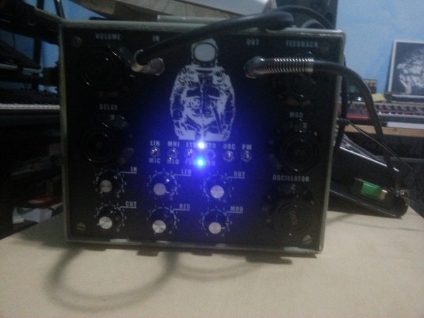

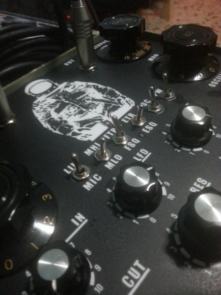

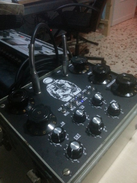

PostPosted: Tue Oct 28, 2014 12:02 pm    Post subject: Reply with quote  Mark this post and the followings unread
This is mine unit built inside a 1954's military resistor bridge
http://www.youtube.com/watch?v=p_hCcGwsmCs
