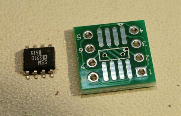

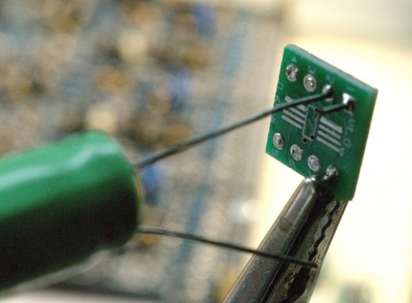

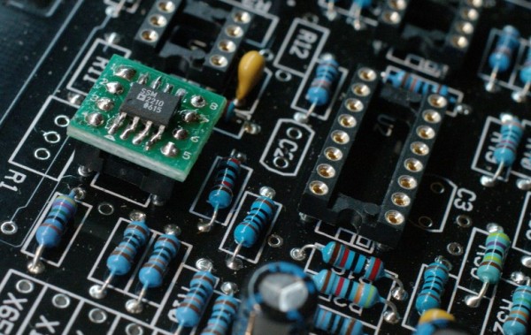

PostPosted: Fri Apr 27, 2018 5:11 am    Post subject: Re: Parts Reply with quote  Mark this post and the followings unread
matinnin wrote:
you will not be able to get redily
SSM2210
At least the SSM2210 are more or less readily available as SMD ICs (I got mine off Ebay, and they weren't too expensive). There are tiny adapter PCBs available as well, and an old cap can serve as a leg donor Wink.
The pics are of my MFOS Ultimate build, but that doesn't matter in this case Smile.

PostPosted: Fri Apr 27, 2018 6:32 am    Post subject: VCO PCB is ready for SMD Reply with quote  Mark this post and the followings unread
SSM2212 is available - and Ray indicates is superior to 2210
and the VCO PCB has pads for the SMD , so that will work fine
~ $15 for the 2 important ICs
