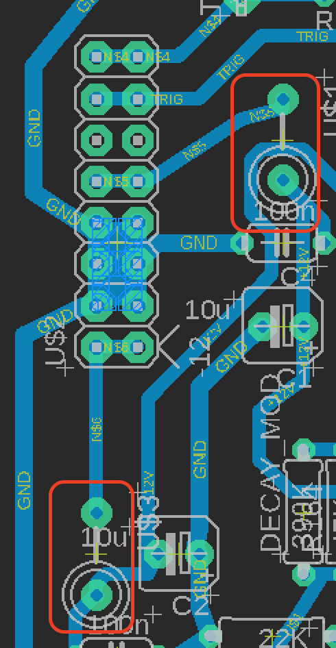

On a series of stupid questions, but what are these U$1,U$2, U$3 etc?
On BD U$2 is power connector, U$1 seems to be between +12V rail and U$3 between -12V rail, so are these output pins to somewhere or jumperwires?
Regards
Jake

PostPosted: Wed Mar 13, 2019 5:28 am    Post subject: Reply with quote  Mark this post and the followings unread
I don’t have the layout infront of me but at a guess I would say they are the trigger and accent outs, I will take a look when I’m home
Hi
Thanks for helping.
I think trigger and accent are their own since these are straight "cuts" from power connectors -12v and 12v. So something must be there so that the rest of the board get power..
Edit, added screenshot
 Filesize:  48.31 KB
 Viewed:  300 Time(s)

I’m pretty sure us2 is a generic name for the power connector

Could be, but yet I don’t seem to understand where or what should be connected there. Power connector is giving -12v and 12v and after that these will break the connection.

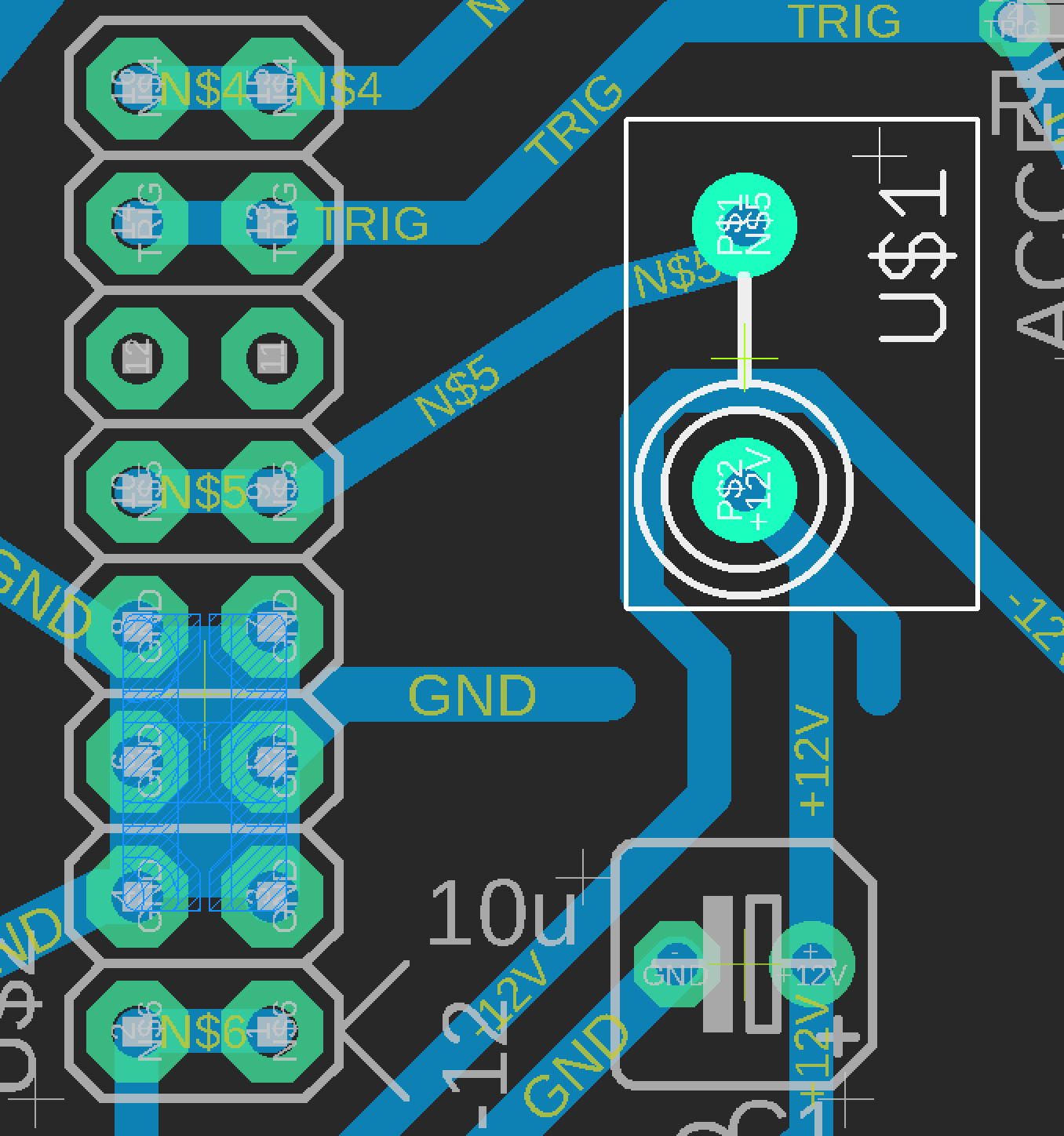

Directly from +/-12v goes into a 100nanofarad capacitor that has a red line around it. Is that what you are referring to?
Hi
No, that’s C4 atleast in +12v side and its from ground.
Regards
Jake
Edit. Picrure added. in the picture C4 is removed so it's much clearer image. So the U$1 here, I don't get it or what it should be.
FootPrint: PB
Value: FB
Edit2, added picture from schematics.
 Filesize:  183.9 KB
 Viewed:  267 Time(s)

Ahh I see what you mean, those are ferrite beads

Thanks. Any idea what value or anything since the FB is not saying anything to me..
