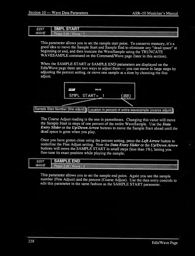

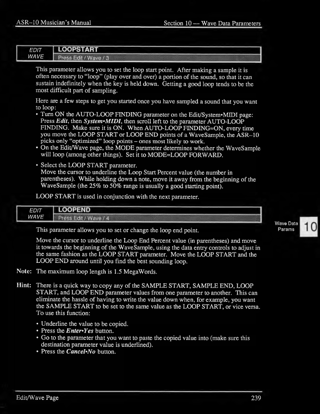

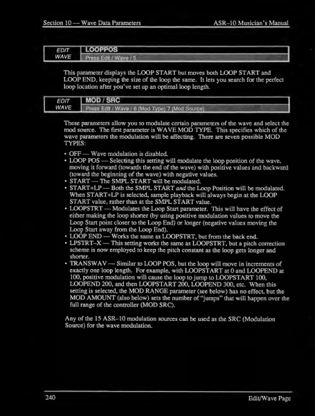

Re. the wave table sequencing thingies you mentioned .. I might find it interesting to look into that a bit better .. but was wondering .. maybe the WavePlayer module could be used for such stuff . as it has a position input .. so theoretically ... I guess I'll have to wonder a bit more about this Laughing

Apologize for not clarifying. That was asio driver from fl studio. Sometimes i'm using it because this driver didn't take all asio exclusively for one app. Waveplayer module is nice for granular stuff i think and this is no problem, there are plenty plugins for this type of synthesis. Ensoniq is more "wavesequencing" thing. Uploading wren log and pieces of manual about waveform manipulations.
