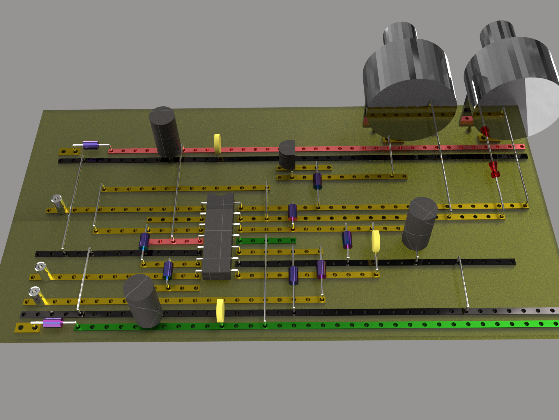

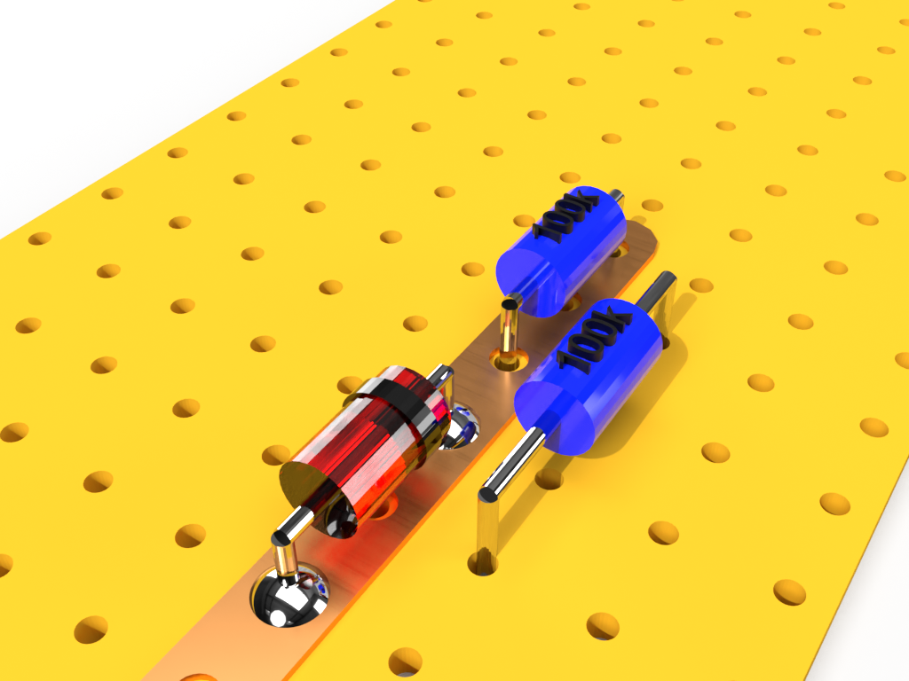

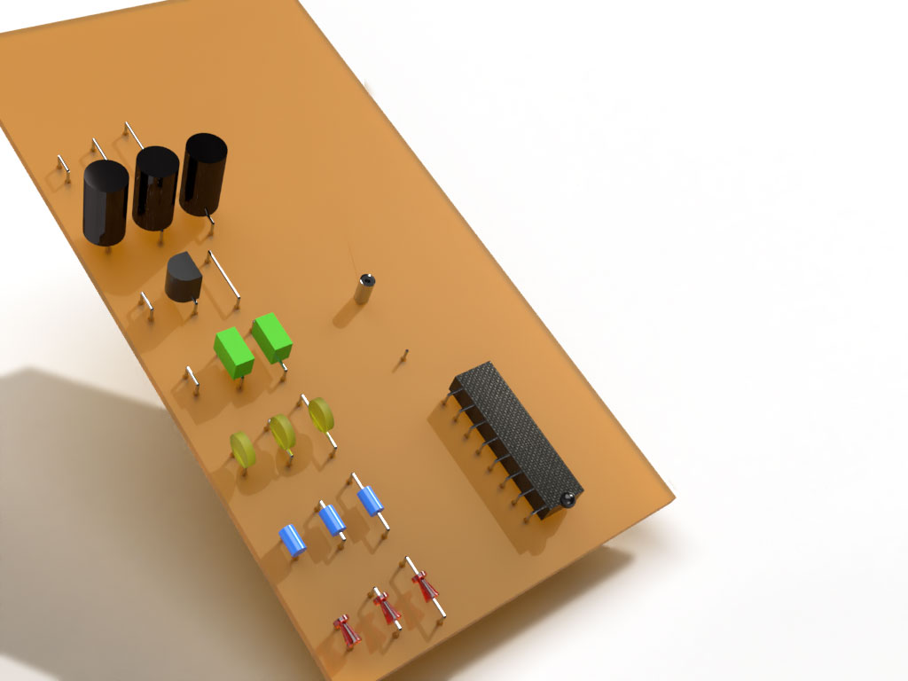

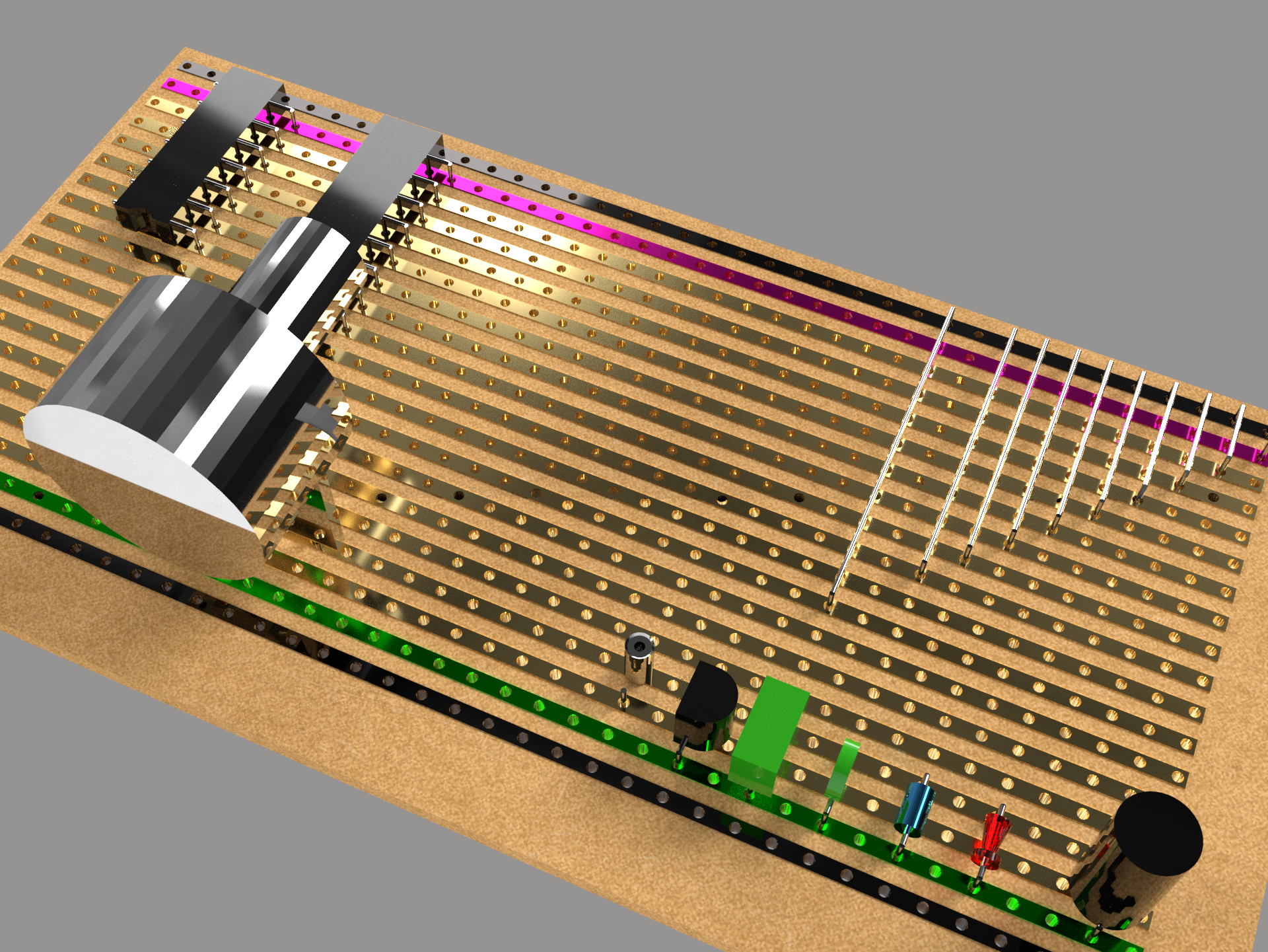

Hi Guys,
due to my forced non-access to any hardware and the desperate try to keep me sane, i try out some things i ever wished to have.
This case "3D stripboard design".
Since it does not exist, i had to invent something (luckily).
Well it is not really designing stripboard in 3D but to have show-of 3D rederings of the designs.
Nothing comes for free, of course.
workflow:
- design the stripboard (in my case in Lochmaster)
- recreate the design in DipTrace, using simple 3D models prepared in freecad
- export to a step file from DipTrace 3DView, open this in Freecad and export the different materials seperatly to a STL file
- import the STL files in Adobe Dimension and give them the coresponding atributes in terms of material and color
- render it and wank a bit Smile
Since iam a lazy writer, i will not write down all the things if no one is interested, but if you are interested - i will try my best to answer
OR if you know how to do it better/easyer - please let me know
I guess the CADRAYS renderer can do similar thing to Adobe Dimensions, and it seem it is kind of freeware, but i cant find a way to get it. Do you?

Laughing nice!
Posts: 5856
PostPosted: Fri Aug 06, 2021 1:10 pm    Post subject: Reply with quote  Mark this post and the followings unread
not what I had in mind when I read the title (I was thinking something with layers of traces to mount components between)
but that looks great! Razz

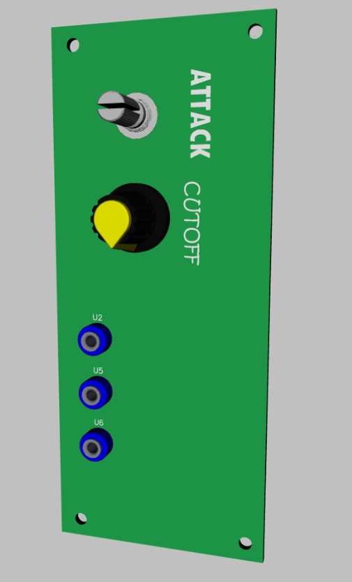

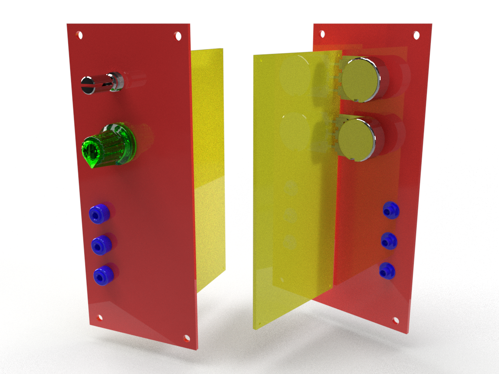

Wow looks excellent. Have you tried front panel design in 3d?
gabbagabi
Joined: Nov 29, 2008
Posts: 652
Location: Berlin by n8
PostPosted: Sat Aug 28, 2021 5:53 am    Post subject: Reply with quote  Mark this post and the followings unread
yup Smile

Looks great. There will be some amazing virtual reality synths one day!
