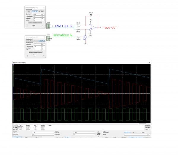

you have dual power! thats good.
Dont know how good the LDR´s are acting as VCA,
but,
if you are planing to use only the rectangle Waves from the 40106,
may that little circuit would be interesting for you,
it acts like a inverting VCA for rectangle waves.
Other good thing, you feed in an unipolar rectangle, output is bi-polar,
no offset or decoupling needed
GLHF

Thanks gabbagabi!
Does the circuit you posted also act as a buffer for each voice?
I made this on breadboard and it made my envelope work in reverse, so I’ll come back to it and try again!
gabbagabi
Joined: Nov 29, 2008
Posts: 652
Location: Berlin by n8
PostPosted: Mon Mar 14, 2022 2:10 am    Post subject: Reply with quote  Mark this post and the followings unread
Indeed it serves also as a buffer.
Regarding the reverse of your envelope,
This circuit acts as an inverter if the signal
on the transistor is steady high ( above 0,7V).
If its low it acts non inverting.
If you would raise the resistor value
to something like 1M you cold probably
even save the Buffer on the envelope.
So you would only need 2 opamps for vca and env.
That's only four Quad opamps like TL084 or LM324,
for your eight "voices".
Will post a Simulation later.
GLHF

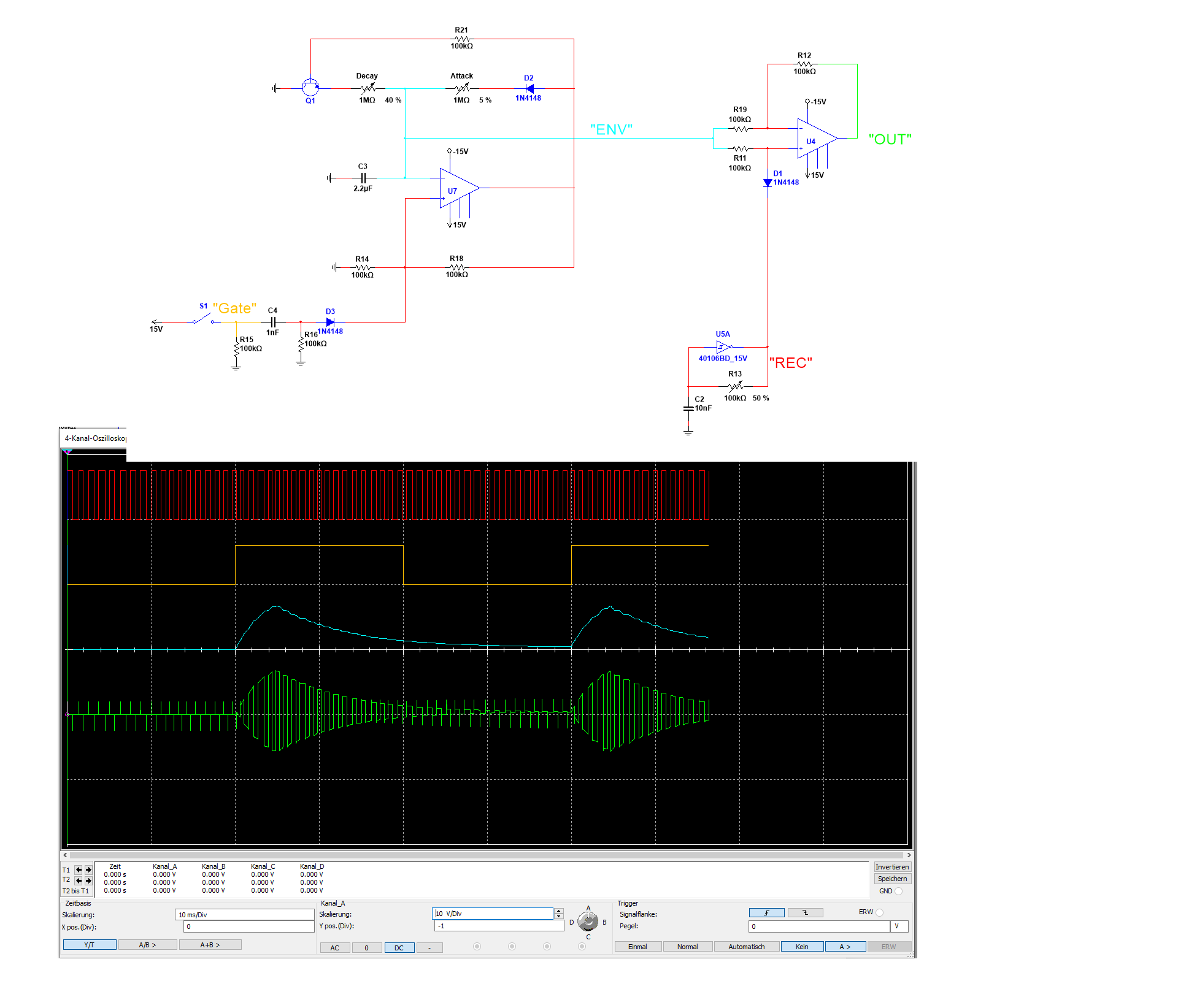

gabbagabi
Posts: 652
PostPosted: Mon Mar 14, 2022 6:27 am    Post subject: Reply with quote  Mark this post and the followings unread
attached the simulation,
it is a little variation which ,in my opinion, is worth to try,
instead of the transistor we have now a diode on the
REC Input of the "so called" VCA,
which makes a potential stripboard design even more simple.
in the simulation there are a lot of "glitches",
not shure if they are appear also in reality,
but you have a breadboard Smile
the input resistance of the VCA with 1M does not take a lot of current out of the Envelope, so there is no buffer anymore.
(Since there is no Schemo for the LMNC-Envelope, i used my one meanwhile Cool )
 Filesize:  86.49 KB
 Viewed:  247 Time(s)
