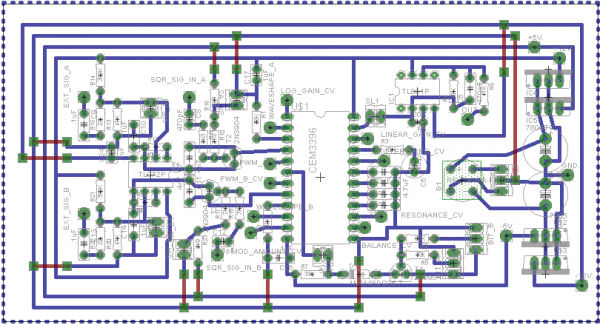

After reading the datasheet I decided that the best thing to do is to build a “trainer”. This trainer should have :
a) four supply voltages (+12, +5, -5, -12)
b) all the circuits that are on the datasheet to control the chip
So I build this:
After building the trainer I discovered that some section did not worked as expected (or worked at all)
Building the trainer:
(Please read all before wasting your money and time)
1) The “DCOs buffer and external signal” part do not work – so don’t build them
2) The waveselection part work as expected (I mean the voltages and bit selection are ok) but do not have influence on the wave selection – (maybe if you use the Abalog part only) I only change R37 from 33K to 1K to be in the voltages the chip needs (regarding the datasheet), but If the jumper is removed, the analog part becomes a little unstable. I thing the best thing to do is to connect the WS CV Pin (6) to the -5V supply directly (both converter on). Not tested.
3) After building the PCB and BEFORE inserting any chip:
A) control the supply voltages
B) build the CV part (not shown in the schematic) Almost every input worked with 0 - 5 V. Except the balance -2.5V / +2.5V, and the filter CV (-2.5V / +5V).
Every CV is done with a 100KB pot. (one end to GND and the other to +5V). BUT the filter CV has a 33K resistor and is connected to the -5V supply (-5V / 33k / 100KB pot / +5V) and the Balance is connected to the -5v and +5V supply with a 47K res. (-5V / 47K / 100KB pot / 47K / +5V)
C) connect the CV potentiometers to the PCB
D) check (test) every voltage in the chip socket (first the supply and then the CV – test if they are in the expected range)
E) test the WS selection (if you decided to build it anyway) – If the voltages are not in the expected range, tweak the R37 resistor. Refer to the datasheet
If everything works as expected, disconnect the supply and insert the chips.
First test:
The first test I made, was to produce some noise with the resonance (self oscillation). I power up the thing and did not worked. Then I increased the LIN and LOG VCA CV voltage to the max and ….. ITS ALIVE….
You must turn both VCA CVs to the max (or near to hear something) because they are in a serial fashion).
Second Test:
Was to input some signal in the EXT SIG . The thing did not worked (that’s why I tell you not to build it) I got +12V in the CTA pin and not 0 - 2.5V signal I was looking for.
So I discarded this part, cut the trace from pin 4 and 8 (CTA & CTB) and apply the signal directly. If you read the datasheet (recommended) the signal must be 0 – 2.5 V (offset 1.25V), but the best result (more output) I got from a 0 – 5V signal. I took them from 2 oscillators made from the 40106.
Here is the sound file I got. Its not pretty, but show some noise you can make with this chip. Mainly I played with the filter and resonace, and was all done with pot CVs, no modulation from ADSR, LFO, etc.
It was recorded with an SB live 24, and the cables were long and everything was connected with clamps, so expect no pro sound an a lot of noise.
The sound file:
In the first seconds are the RAW “noises” taken directly from 40106 (this is to test how the chip alters the sound)
At sec. 5 you will hear how the balance CV works (Filter fully open , RES: 0)
At sec. 23 , how the filter works (res: 0)
At 50, playing with res,
At 2:30 no input, only self oscillation (and playing)
At 3:10 no input, self oscillation and playing with the MOD CV.
Well this is it. I think the first part is finished. Here are the PCB and Layout EAGLE files, If someone wants to make a better PCB, take the parts that do not work out, and made a nice Analog module, feel free.
