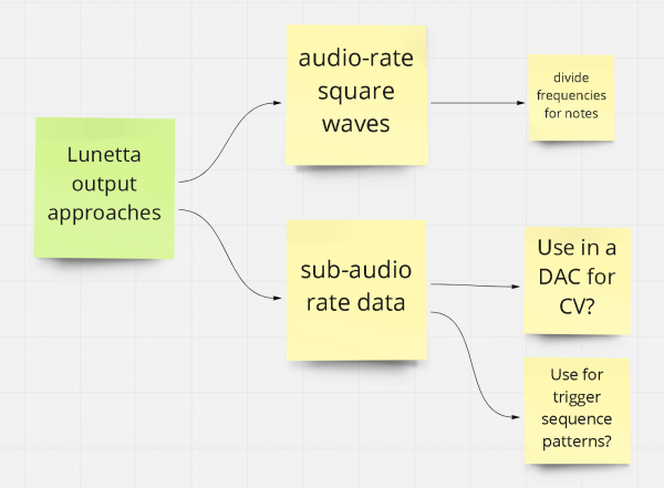

Hi all, hope you're doing well.
I have a lot of old obsolete sound and graphics cards.
Let's see if they can do anything interesting with Lunettas!
The approach:
-Learn about the connector pinouts
-Power them appropriately (more or less)
-Find out what the other pins do (address?? data?? huh?)
-Try to get some interesting data out of them for sequencing and CV
-Try to get some interesting audio-rate stuff out of them
I've chosen a first card, will post with some pictures soon.
Happy for others to join in as well.
Edit: Spelling mistakes.

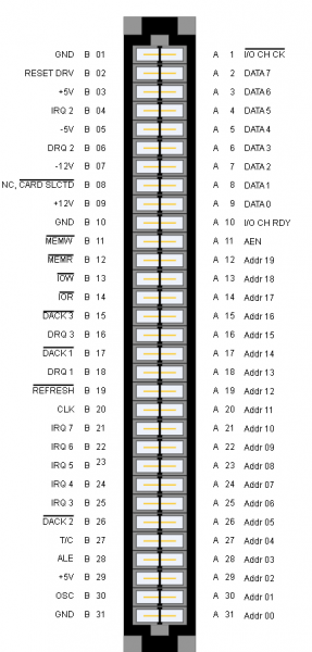

As far as I can tell, this is called the ATI Graphics Solution Plus.
Here's a link to some information about it, but suffice to say it is very old(1987!) and was one of the very first graphics cards offered by ATI. Quite amazing.
https://www.techpowerup.com/gpu-specs/graphics-solution-plus.c3175
https://en.wikipedia.org/wiki/ATI_Wonder_series
But anyway, now it aspires to be some kind of strange sound machine.
The main connector pinout is the same as an ISA slot:
The EGA port pinout is a 9 pin arrangement.
It outputs Analog signals...(CV?)
I'm no expert, quite the contrary, but we seem to have a lot of address pins, some data pins, some control pins, and some analog outputs.
I'm guessing the address pins will output as a binary counter? There are pints to read and write to memory, maybe If I feed it to itself and then play it back something will happen.

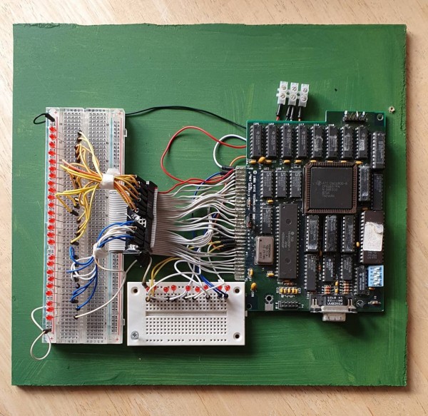

A little update.
Nothing interesting or cool yet in terms of output from the card, but I have some other ideas.
I soldered connectors to the pins on the card and separated the address and data pins. There are 20 address pins and 8 data pins. There are also a number of pins to control the whole thing, but I don't know how to use them yet.
So I hooked up my lunetta to the control pins and started just inputting randon data. Nothing cool is going on just yet.
Here's a video of random data going into the card and no real output from data pins (the blue and white ones on the left.)
https://www.youtube.com/shorts/NP5GxWBlF1c
Next plan is to work with the individual ICs to try to get something going. There are cool ICs on there, but that is for another post.

Posts: 24493
PostPosted: Sun Jun 05, 2022 7:04 pm    Post subject: Reply with quote  Mark this post and the followings unread
love it!
I expect that it could be quite tricky to get something out of it, but then again I don't know much about how these cards function.
Basically ..
A video card is a bunch of memory that you can write data to which will then be displayed on a screen.
It may have an output which tells you when to write, but the idea is that you put data into it.
There may be support for reading the memory .. it would then have to have a signal called RD, WR or DIR or something to indicate the direction of data transfer.
The device being memory could still be interesting of course, especially when it would be readable too. But then again .. the video output would present reads as well .. for VGA an analog(-ish) signal with some video specific things mixed in .. although the card may need some configuration before it will do so.
edit: looking at https://electro-music.com/forum/phpbb-files/xtisabuspinout_401.png (the connector description) it looks like it supports both reads and writes - separated for memorory and IO (the latter probably is for configuration).

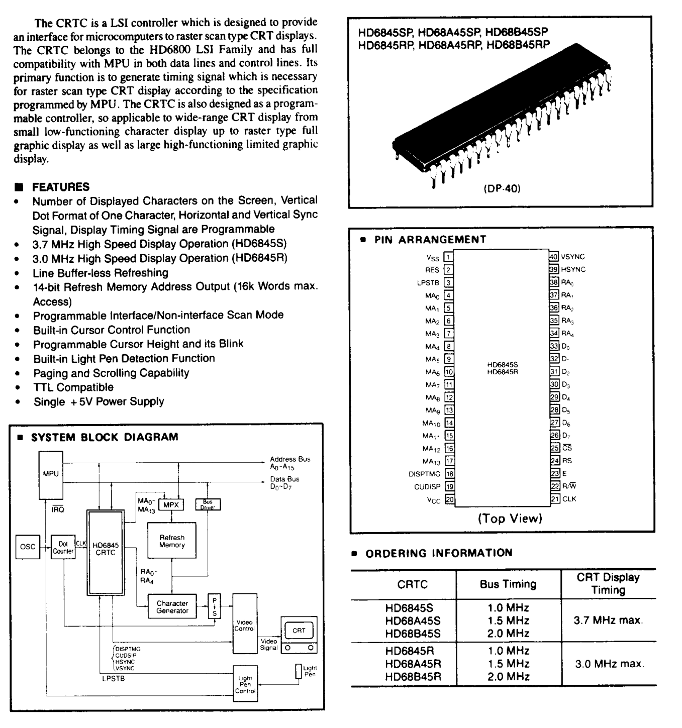

Thanks for your comments.
Lots of reading and research at the moment.
I'm going to have to learn how to code interactions with ports and registers eventually, this might be the project to do it.

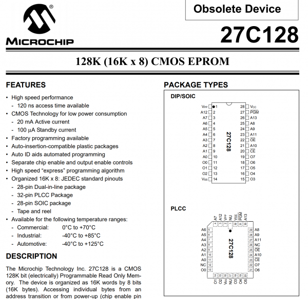

I don't have a monitor to display the output on, but I was hoping interesting audio would come out of the video port if I run the whole system at a much lower clock rate than it would usually expect. There pins to insert custom clock and oscillator.

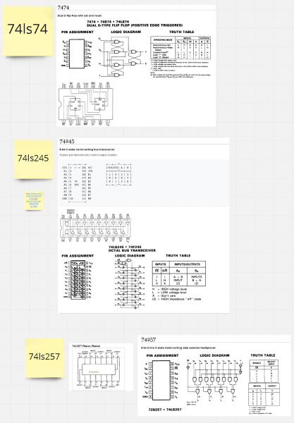

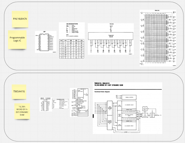

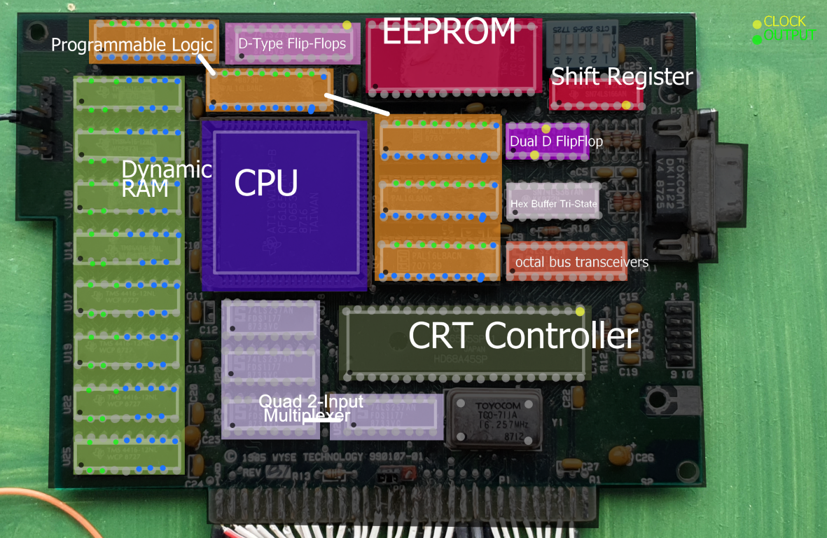

The good thing about this board is that it's so old that they haven't reduced whole boards into an all-in-one IC yet. Tons of 74 series ICs on there. Shift registers, multiplexers. It could be a mega melody generator? This creates a couple of options for ways to move forward:
1. Learn to control the address and data ports to read and write memory and see what that brings. Maybe the pseudo-random output of my main lunetta can be saved into memory and read back to have repeatable somethings. I'd like to be able to make proper use of an ay-3-8910 chip someday, so this might be a good path.
2. Treat it like my main lunetta, with all the jumper connections and LEDs, and do a lot of soldering of the inputs and outputs of everything to a companion interface protoboard.
So far it's just fun to try to learn about how the bus interactions work. This kind of coding is way out of my realm of experience.
Fun images attached for general knowledge.
