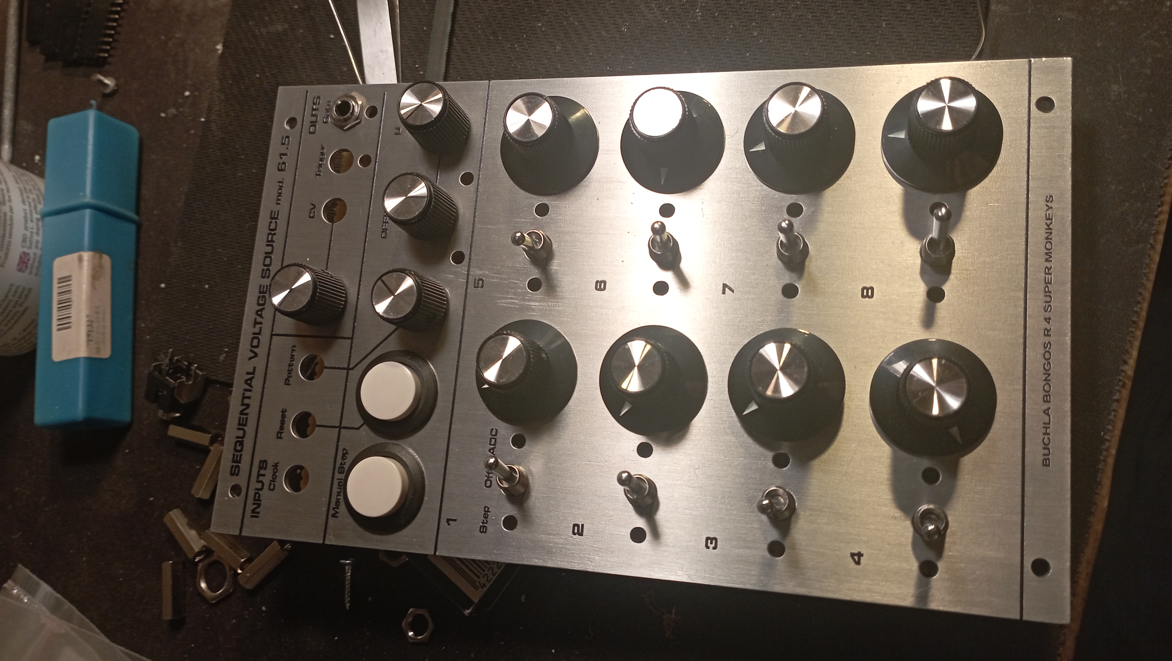

Hi folks
Almost done with the wiring of this long neglected project...
I realized now there are two CV outputs available....??
What's the difference between the "processed CV out" from W1 and the attenuated "CV out" from J2??

PostPosted: Mon Nov 18, 2024 9:13 pm    Post subject: Reply with quote  Mark this post and the followings unread
The processed CV out is just the input CV combined with the offset and fine controls. The CV out from J2 is the actual sequencer CV output from each step.

sticks & gongs
Joined: Sep 21, 2024
Posts: 9
Location: Berlin
PostPosted: Tue Nov 19, 2024 8:00 am    Post subject: Reply with quote  Mark this post and the followings unread
Thanks for the explanation

PostPosted: Tue Nov 19, 2024 11:08 am    Post subject: Reply with quote  Mark this post and the followings unread
Thanks...trying to put together a basic buchla system....this sequencer seemed a bit tight for a eurorack...better would be if it even start to work correctly
Take care,
Doug
Thanks a lot
