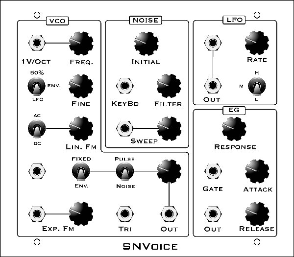

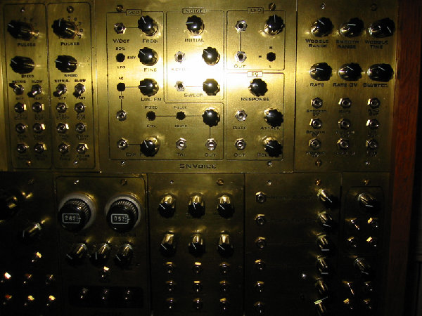

PostPosted: Mon Dec 10, 2007 6:43 pm    Post subject: Reply with quote  Mark this post and the followings unread
Heres the panel. crap photo (sorry my camera is a toy), but I think you get the idea. The pcb isn't wired to the panel yet bec. I haven't figured out how to wire the on-on-on switches to work as 3-way selectors (paging Mr. Herrmann...) as seen on Foniks' SNV.
hope this gives you some ideas.

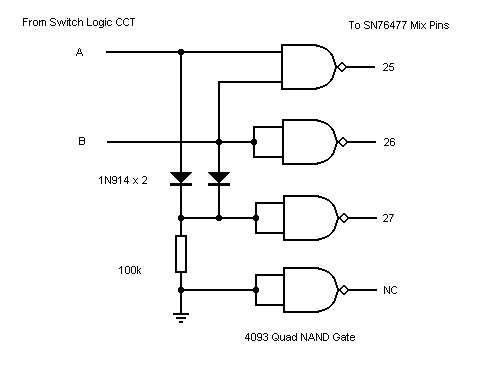

Has anyone figured out how to use a 7211 switch to select VCO or Noise or a mix of both. I have been trying and trying but so far i have VCO or Noise or LFO Sad
Adam-V
Joined: Jan 29, 2007
Posts: 300
Location: Australia
PostPosted: Tue Jan 22, 2008 8:35 pm    Post subject: Reply with quote  Mark this post and the followings unread
I don't think you need to waste a 7211 switch on this.
The logic for selection of noise/VCO/both is as follows:
Code:
         SN76477 Pins
Output    25  26  27
Noise     1   0   0
Pulse     0   0   0
mixed     1   1   0
You only need a 3 position switch (on-off-on) to get the three required logic levels at the SN chip.
Check the following diagrams for switch wiring and simple logic gate circuit required to perform the translation. Points A and B correspond to each other on both diagrams.
When the switch is up, A is Low, B is High. This translates to pin 25 being high, and pins 26 & 276 being low so noise is selected.
When the switch is in the centre, Both A & B are high. This translates to pins 25, 26 and 27 being low so Pulse is selected.
When the switch is down, A is High and B is Low. This translates to pins 25 & 26 being high and pin 27 being low so both noise and pulse are selected.
Looking at it in truth table form:
Code:
   Switch    SN76477
             2  2  2
    A  B     5  6  7
U | 0  1 =>  1  0  0
C | 1  1 =>  0  0  0
D | 1  0 =>  1  1  0
Which means:
Pin 25 = A NAND B
Pin 26 = ! B
Pin 27 = A NOR B
Obtaining 2 logic lines from a single 3 pos switch.

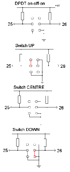

PostPosted: Tue Jan 22, 2008 9:19 pm    Post subject: Reply with quote  Mark this post and the followings unread
Actually, since pin 27 is always low for selection of noise/pulse or mix you don't even need to be that complex.
The attached hastily put together diagram shows wiring for a standard DPDT on-off-on switch which will give you selection of noise, mix or pulse.
Assuming pin 27 is tied to ground.
In the up position, pin 25 is held high, 26 is held low. (Noise is selected)
In the centre position, pins 25 and 26 are held high. (Mix is selected)
in the down position, Pins 25 and 26 are held low. (Pulse is selected)
Adam-V
SNV Output select with a single DPDT Centre off switch (on-off-on)
 Filesize:  5.58 KB
 Viewed:  499 Time(s)
