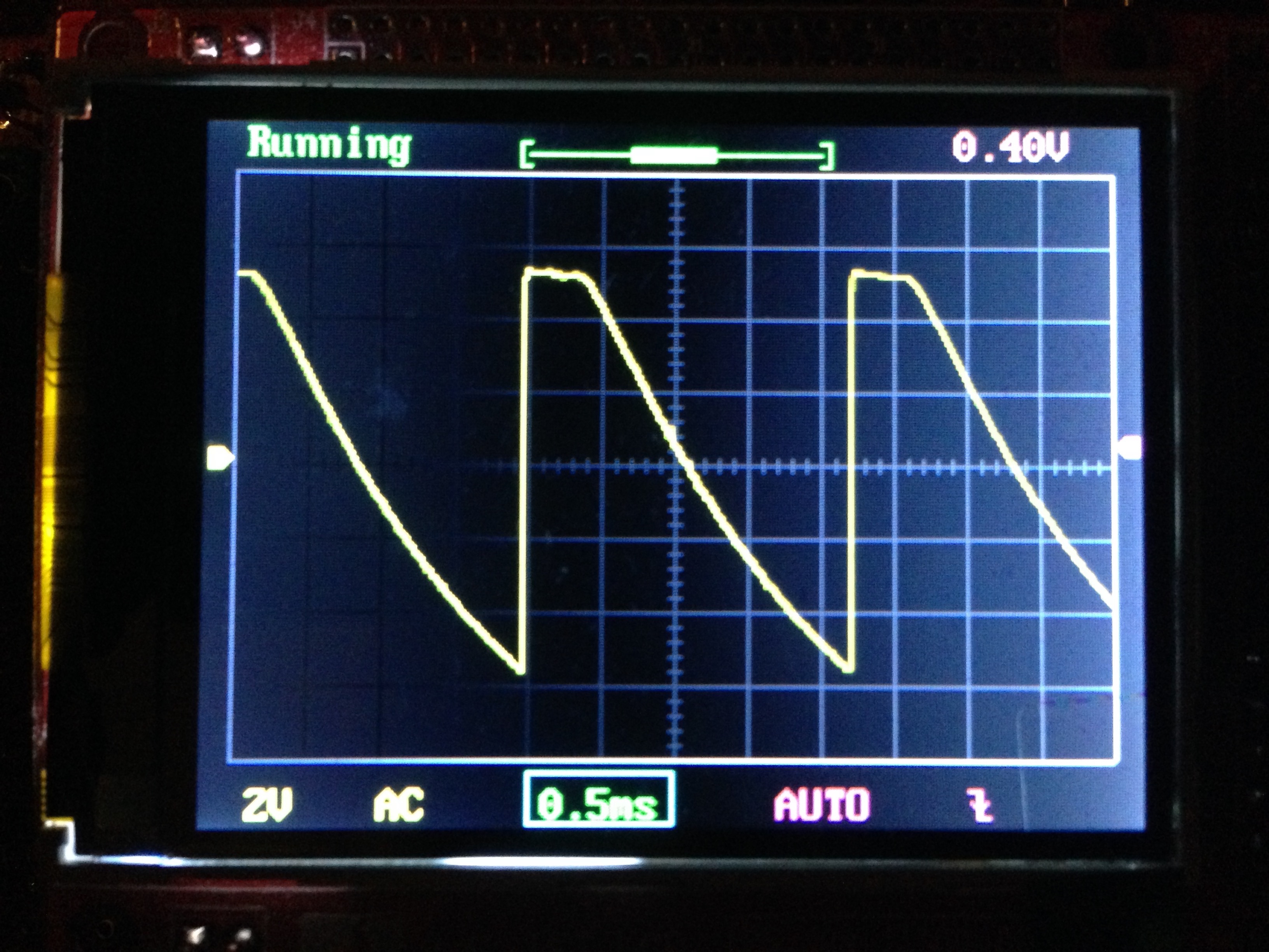

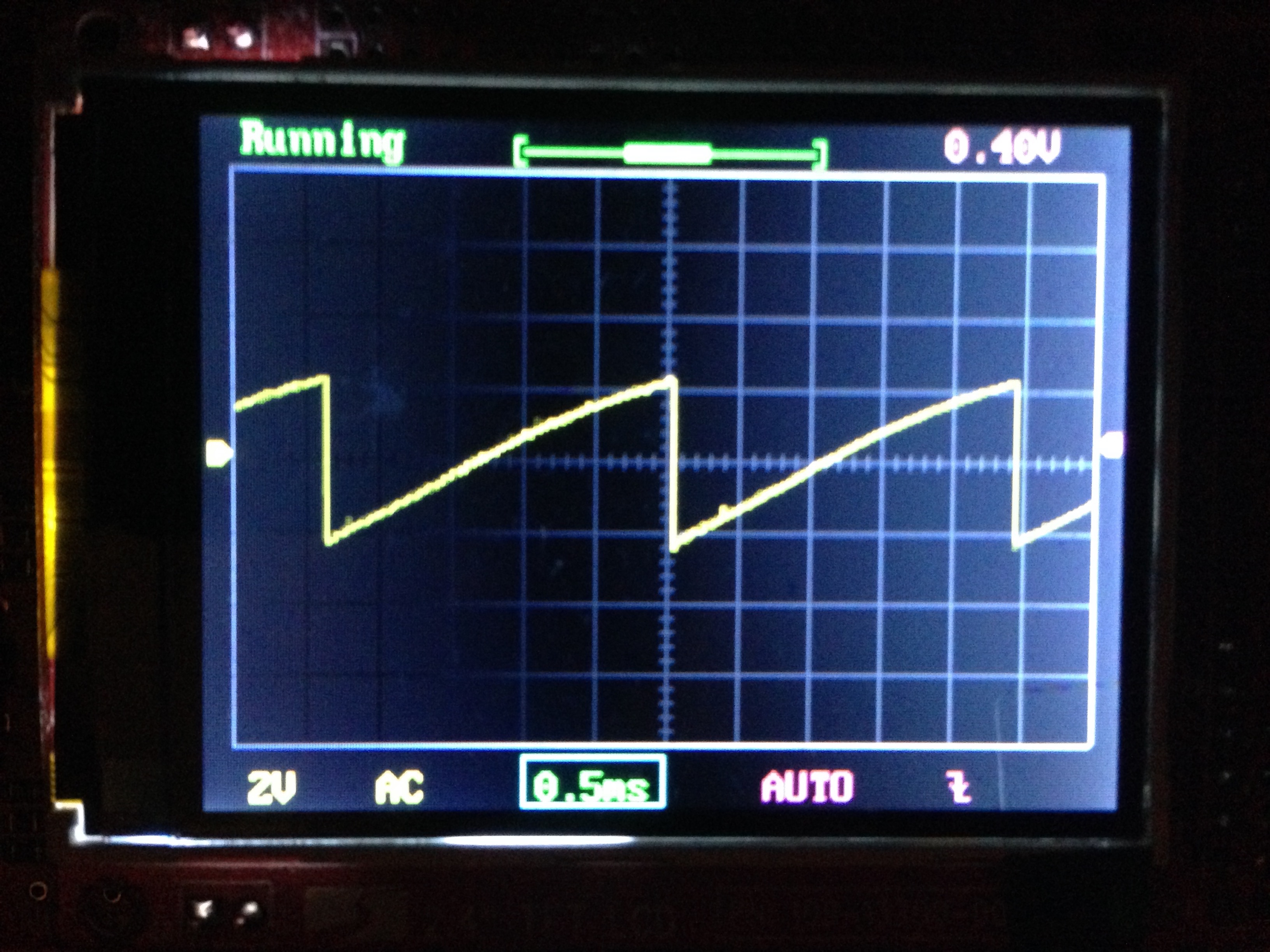

Hi all
I've recently built Rene Schmitz's 4069 VCO on veroboard including the sawtooth buffer using my own layout. I'm running it from +-9V and used the stated component values, I'm not sure if it would have been wise to change the resistors in the buffer because that is shown for +-15V use.
From the pics you can see I am getting a square and saw wave out but the output from the buffer is clipped and seems to have become a downward ramp which is not what I expected. If anyone can shed some light on why this may have happened it would be great! I think I've got the layout correct but this is my first proper VCO so I could have missed something...
Any help will be greatly appreciated
Thanks

From the scope output, it looks like the buffer is clipping. You could increase the buffer's input resistor or decrease it's feedback resistor. And I'm assuming the top image is the buffer output.

That is exactly the same output wave shapes I got on my breadboard this week!
Anyway, yes the buffer is clipping the top of the saw, so you need to tweak the resistor values somewhat around the transistor.
It is an inverting buffer which is why you are getting a saw/ramp. I believe they are more or less the same to your ears at audio frequency.
I think that to get a non inverting input it's a bit more work with the bias, but I don't actually understand transistor bias so don't take my work for it!

Thanks guys, that really helps...and it now makes complete sense that an inverting buffer would flip the waveform!
