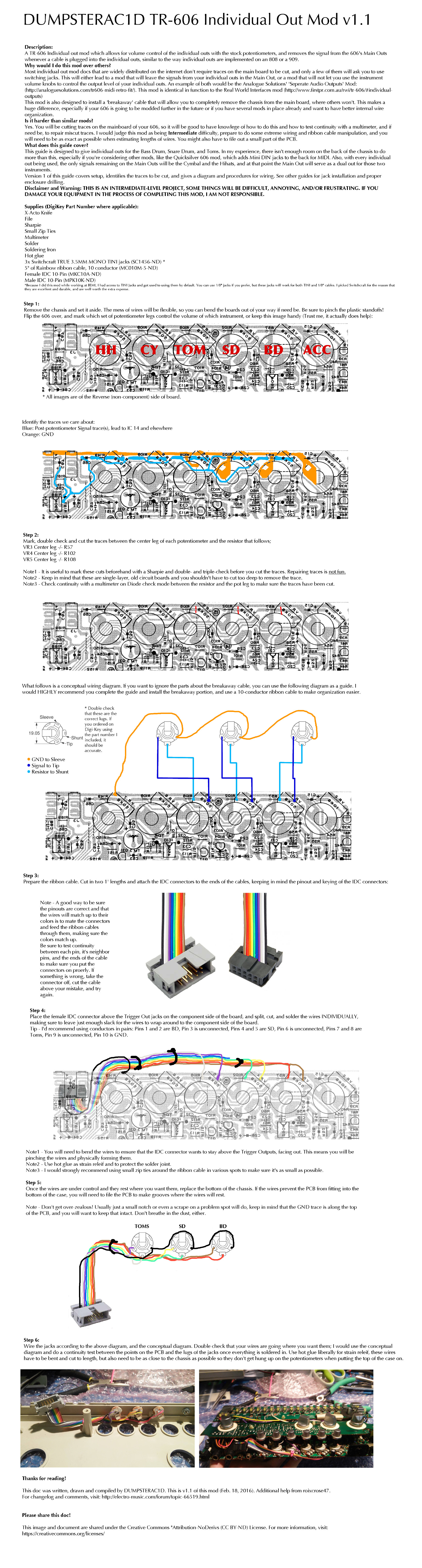

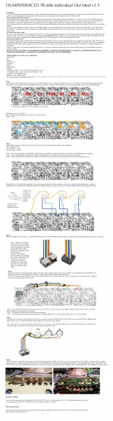

Hello! this is my first post as a member of electro-music. Last spring I was interning at BEMI and decided to use my extra time at the benches to repair and fix a cheap, broken TR-606 and add a few modifications, one being an individual out mod.
The problem I encountered while looking for docs to use was that most of the mods available would have resulted in individual outs that didn't function the way I wanted them to function, either they tapped into the signal from each drum voice pre-potentiometer, which would mean that the level knobs wouldn't have any effect on the individual out level, or the docs didn't require cutting traces and adding a switching jack, which allows the voice to be removed from the Main and Headphone outs.
I'm sure this mod exists in other forms, but a friend of mine wanted to try to do my mod, so I created a doc/image to make it easier to figure out.
Another thing I think is extremely important is the breakaway cable. I did the mod with a 10 conductor ribbon cable and added a breakaway portion which has just enough room to rest above the Trigger Outs. This way, people can remove the chassis from their work area completely and still leave the mods intact.
I'd appreciate at tips for the second version, aside from adding images of the actual mod. I took a few pictures, but didn't have this doc in mind when I was doing the mod, so I'll need to do another one.
