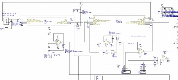

Hi there,
I'm trying to base a module on the Ian Fritz sawtooth VCO, and I've run into trouble. I've made some small adjustments, such as using a 5.6V Zener diode-based reference voltage.
From my scope I can see that the integrator is charging to 5.38V (the actual zener voltage) and then staying there.
You would think that the comparator (LM319) is not doing its job, and I can reset the integrator by shorting out two of the pins.
It's been made using DesignSpark from RS components, can anyone think of a reason, or has anyone encountered this before?
Scratching my head (no emoticon for this Smile
Ed

Oh yes, forgot to mention:
Using a 2N4859 instead of the 2N4393 (can't seem to find a 2N4391 from my suppliers)
The op-amp AD711 is actually an LF351 in the circuit.
CR1 is the zener - the voltage reference is working properly - +5.38V
Exponential converters are on another board.

synchroma wrote:
I'm trying to base a module on the Ian Fritz sawtooth VCO, and I've run into trouble. I've made some small adjustments,...
Which Saw VCO schematic are you using? I can't read what you posted well enough to tell. Offhand, it looks like you have made major changes and it couldn't possibly work.

OK. It is based on:
http://home.comcast.net/~ijfritz/sy_cir2.htm
I've made adjustments like, the 2N4859 - looks like the KE4859 in some reference notes, and I can't get hold of a 2N4391 easily in the UK. Low Rds and fast switching time.
LF351 has the same slew (20v/usec) as the Burr-brown op amp which is also hard to source in the UK.
Apart from that, I'm not sure what changes you are referring to, but I'm open to suggestions.
Ed

PostPosted: Mon Sep 02, 2013 3:09 pm    Post subject: Reply with quote  Mark this post and the followings unread
According to the data sheet I'm looking at, the LF351 SR is 13V/us. Additionally, you are using a 5.5V reference vs the 4.0V of my circuit. You could try increasing the size of C4 to compensate for your changes.
It's almost impossible to read you schematic, so I can't comment further.

synchroma wrote:
I don't quite understand what you're saying about the schematic, because if I click on it it will enlarge and I can read it OK in the browser.
When I click on it, it enlarges one notch, but I can't read the labels. If you can read it, then maybe I need to try another viewer. This has always been a pet peeve of mine -- why can't the folks who write this layout software figure out that their drawings need to be publishable? Are they living on the moon? Their drawings are at least 90% wasted whitespace! I almost always do my layouts manually, just because I don't want to do two different schematic drawings.
I'll try what you said, and post again if I have any success.
I'm sorry about my short replies. I have some family stuff going on, but I didn't want to put off answering you. I believe your changes in SR and reference voltage have combined to approximately double the needed reset time. One approach you might try is to increase C4 to 100pF and see if the circuit oscillates. That should rule out other problems.

Hello Ian,
I've just ordered an AD817ANZ op-amp, with a very fast slew rate and settle time. I've got some 3.9V zener diodes and a pack of PN4391 FETs coming from Ray Wilson, so I should be able to make the circuit I built work. However, I'm hungry for knowledge so I really want to know how you would calculate the reset time of the comparator+integrator+FET combination.
Sorry for naive questions - I studied electronics years ago, but have only come back to it with any passion recently. Is the time-constant derived from the voltage divider (R23 and R24) and C4 in your schematic? And how does the slew rate and settle time affect this?
