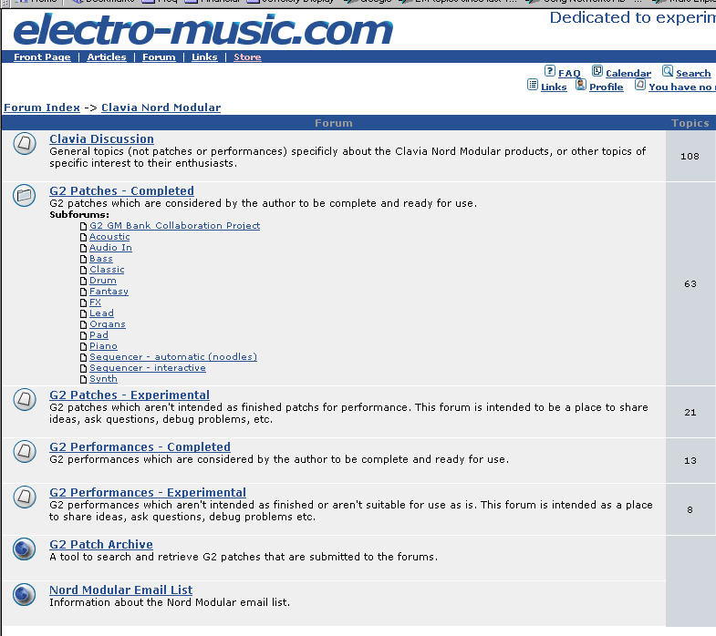

When you post a patch, it's a good idea to start a new topic in the appropriate forum. How to do that? Well, first you want to go to the "Clavia Nord Modular" index and look at all of the forums. Click here: http://electro-music.com/forum/viewforum.php?f=43
This shows all of the forums and sub-forums, at least for the Nord Modular (see attached pic below). Pick the appropriate forum and click on it. You'll then see a listing of all of the topics in that forum. Then click on "New Topic" and you'll get the familiar window for editing posts.
A pretty neat thing about the forum is that you can edit your posts (they aren't called emails), even if they are days or weeks old. This is good for correcting errors or whatever. So if you should choose to repost the patches you posted in this topic over on one of the other forums, you could always edit your posts here, delete the attachements in you posts, and tell in the edited post where you posted the patches.
