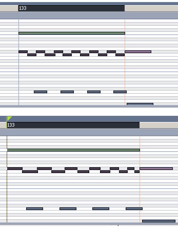

Bug report.
If you apply Sonars "Fit to Time" process to notes many of the Enigma operators act screwy on those notes unless you save close and reopen Sonar after "Fit to Time"
Attached is an example of using rubato. This example used a non-linear rubato followed by a linear rubato.
Before and After
 Filesize:  28.85 KB
 Viewed:  3591 Time(s)
