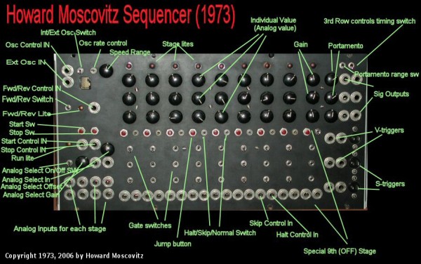

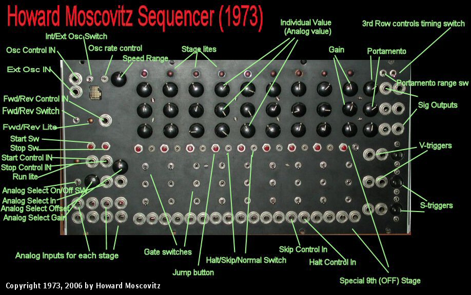

There is quite a bit of discussion on sequencers in the DIY forum here on electro-music.com. I thought I'd share a sequencer I built back in 1973 with the help of George Gibson who was then a tech at the Berkeley Radiation Lab. Working with George on this taught me a great deal about electronics. This convinced me to go on to study electrical engineering and get my MSEE at Berkeley a few years later and then onto Bell Laboratories.
Below is a picture with all of the knobs, switches and buttons labeled. It has the key features of the Moog sequencer, 3 rows of 8 stages. Each stage has a halt/skip/normal switch. There is a jump button for every stage that immediately forces the sequencer to jump to that stage.
Under the pots for the three rows are three rows of switches. This is a trigger matrix.
Each stage has an signal input to jump to that stage. It is a V trigger - essentially a 0.5 volt comparitor. Each stage has an independent V trigger out too.
The clock system includes an interal VCO and it can take an external plug in. There is a up/down switch and also a control input to select up/down. This is a very powerful feature not found in many sequencers even today. I would never consider buying a sequencer without up/down control.
The sequencer runs at very high ultra-sonic clock rates so it can server as sort of a wavetable oscillator. On the top row, ther is an adjustable slew control so the sequencer can do glides. At ultra-sonic frequences, this becomes a low-pass filter.
Each row has a gain control.
On the left is a nice feature. It is possible to plug in an arbitrary analog input. This is fed into a ladder compartor so the sequencer can jump to a state appropriate to the voltage. This is similar to the Clavia G2 control sequencer. This input signal is conditioned by gain and offset controls.
A super nice feature of this sequencer is the 8 jacks on the lower left. The top row is normalized to these jacks. You can plug up to 8 signals (audio or CV) into these jacks. The sequencer is used as a high speed analog switch. I often plugged 8 transistor radios into these jacks. What a great sound.
Any how, that's what it was. At the time it was the most advanced sequencer of it's type I knew of. It's still up there.
As I write this, the sequencer is busted. My eyes aren't what they used to be. I'm not really up to fixing it, but I'm happy to share my knowledge and experience.
Howard Moscovitz's Sequencer circa 1973

Pretty cool, Howard! The ability to input signals to be sequenced is a very powerful tool. I imagine this sequencer blew minds on a regular basis.
Ken Stone now has the sequential switch that performs that function also. It has a neat method for sliding bipolar signals through a 4051.

howard, what a flexible sequencer! it reminds me very much of the sam16 (i think the best available step sequencer...i wish i had a few).

Which IC's is this thing based on? I'd love to know how you got all that versatility with which IC's.
Posts: 18251
Audio files: 226
PostPosted: Sun Apr 09, 2006 5:48 am    Post subject: Reply with quote  Mark this post and the followings unread
The heart of the beast is a binary up/down counter. I think it was something like the 74C193. The other big deal with this sequencer was the use of an analog switch IC. This was when they first came out. I don't remember the number but it is similar to the ADG408
The rest of the chips were standard TTL (74C stuff), Op Amps and the like. The clock was a 555 oscillator - not the best thing. Most of the time I used an external oscillator.

It's a complicated beast; I think it had 67 ICs. I put the circuits on two protoboards. Maybe we could get it on one board with modern techniques. To bring it up to date, it needs some circuitry to enable 2 or more to be daisy chained or operated in parallel. Also, something like the Moog sequential switch should be built with this. I never got around to building that.
Another thing to is - should we move to a more modern technology, with LED collared rotary encoders and preset memories. That's a completely new item. There are members here that have the chops to design the embedded processors to pull that off. It would be much more expensive and a lot more of a chore to wire up. Every one of the trigger switches would become a push button with a lite - preferably a two or three color lite.

I used single op amp chips; nowadays there are the quad packages. That'll save a lot of chips right there. I think you said you were simulating circuits. What simulator do you use? Does it work with a schematic capture program? Do you think it is possible for multiple people to collaborate easilly on such a project?

BTW, I thought I memtioned it, but all three rows are made with analog MUXes. These are connected to a single 74C193. Very simple actually. The hard part was actuall the halt, jump, and skip features - and they aren't that hard.
