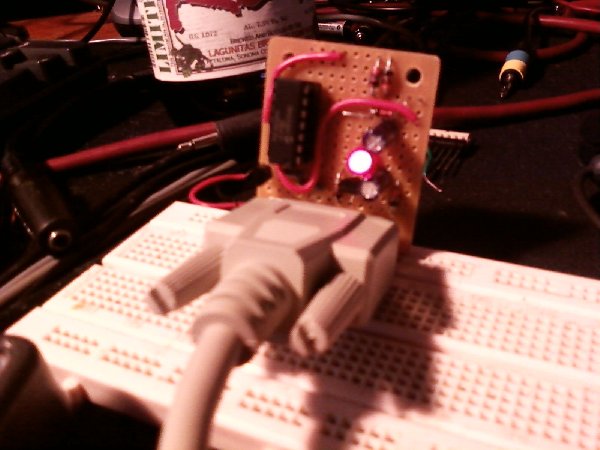

ssoooo... I got my 16f684's in the mail and started building a simple JDM programmer on breadboard, then i noticed that this one called for a 18 pin socket (the 16f684 is a 14 pin chip). I also noticed that it mentioned that this design was limited to the 16x84. Is this limitation just the socket? can I adapt it to work with the 16f684? I'm fine with using headers and attaching them to the right pins if need be. I'm just not sure how to approach it.
http://www.semis.demon.co.uk/uJDM/uJDMmain.htm
My DIY stuff Flickr

i also noticed on the sparkfun JDM programmer it says "supports 8, 18, 28 and 40 pin PIC microcontrollers"
what have they got against 14 pins?
http://www.sparkfun.com/commerce/product_info.php?products_id=8

good news! i answered all my own questions with the clever use of the Google.
I built a programmer from the schematic for the one on the sparkfun page (which is the one i probably should have gone with from the start). I only killed one pic in the process (due to an unfortunate reversed transistor incident).
All is working fine now.
