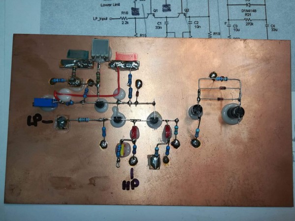

may iam allowed to post an inspiration.
attached my attempt so takkle the ms20-vcf from Jürgen Haible.
This was always to much for my brain drunken to put on stripboard.
As u can see, even that is not finished, the opamp is missing.
The plan was to mount the opamp on a piece of stripboard, and glue it there where it would belong.
If i would do the totem pole i would probably use two tl072 in a similar manner.
And i will do it (both) in the future, i promise Shocked Very Happy Cool

Ayab
Joined: Oct 27, 2015
Posts: 186
PostPosted: Thu Jul 04, 2019 4:49 pm    Post subject: Reply with quote  Mark this post and the followings unread
Hi Gabbagabi
So many circuits to build, so little time! Maybe going acoustic is a better option Surprised
I like your building method direct onto unetched pcb - I haven't seen that before.
